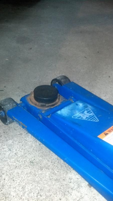

... or get a hockey puck: fits perfectly in jack's saddle, offers some give, provides increased degree of friction, virtually indestructible.
The plastic saddles are very strong, I've never heard of anyone breaking them. Your only concern is getting a solid connection between them and the jack, which the hockey puck provides in spades.
I've been using the same puck in my jack's saddle for the past 20+ years. Hardly any worse for the wear.

Do you mean lay the hockey puck flat in the jack saddle? What about holding fast with the jack insert on the car? Shouldnt part of the puck somehow fit inside that jack insert to hold everything steady while jacking?
Yes, in the saddle.
It fits perfectly, and the edges of the saddle prevent any possibility of a slide.
See the pic below.
No need for that.
The weight of the car, coupled with hockey puck's rubbery, slightly yielding, high friction surface, make for a rock solid connection point.
I do remove the puck when I jack both wheels with a 2" long 2x4 right behind the front jacking point. That allows the jack's saddle to dig into the 2x4, providing additional insurance against slippage.

Interesting. Thanks for the pic. I guess if I wanted to add a little bit of "security" to your idea I could just drill a hole in a small piece of wood and screw it into the center of the that puck.
