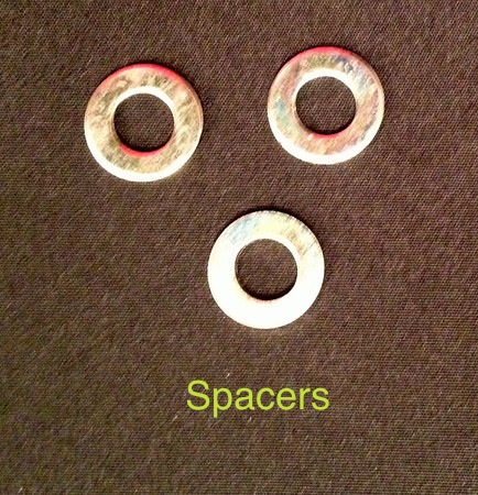

Seat height spacer
I too love my MINI but sometimes think of selling it because of the dang seats. At first my left leg and two smallest toes would go numb. Raising the seat height with the crank helped a lot. The left leg bolster still digs into my thigh but it's more tolerable now.
With my base leatherette seat the lumbar support was horrific. At first I used a small pillow filled with some kind of seed husks--bought it at an Asian grocery store. That helped but was a pain positioning every time I sat in the car. I then installed the MINI lumbar mechanism (search NAM for it) which made a huge difference and is my best mod yet.
In an attempt to improve my left thigh problem tonight I tried the spacer mod to raise the front of the seat. I wanted to raise the front my 3/8" but couldn't find a long enough bolt that would allow the spacers and allow the bolt to fully screw in. An M8x50 is needed. I want a Grade 8 strength as someone mentioned above. Home Depot sells a long enough bolt but it is not strong enough. So for now I put just two small washers on the stock bolts. I will continue to search for a fully threaded M8x50 Grade 8 bolt.
When working with the spacers (aka Grade 8 washers), I wanted to add seven but was having a terrible time trying to stack them between the floorpan and seat rail. The space was just too tight to stack them. One even got wedged between the carpet and metal of the floorpan. So I taped them together with Scotch tape. Worked like a charm.
