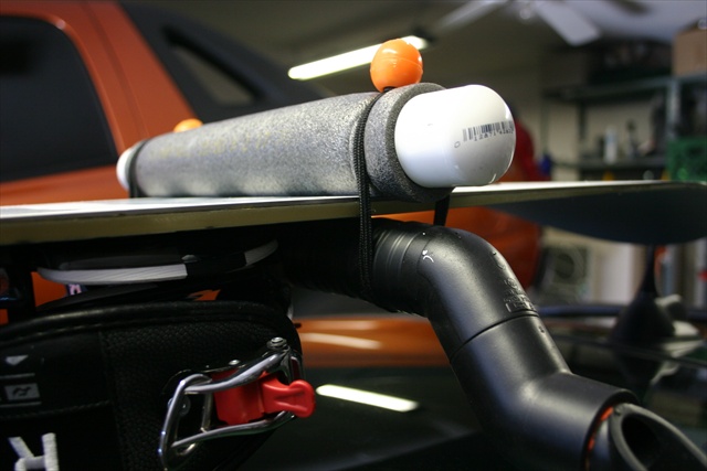

I made my own suction cup roof rack to carry snowboards and skis. I used it 4 times last year with no problem. I made it from suction cups similar to this http://www.harborfreight.com/cpi/cta...emnumber=46134 "mine were orange". I just cut this in half and added pvc pipe to make wider. It works great on the glass on the sunroof. I also added a 1" nylon web strap as extra security that i fed through the sunroof and attached to the inside of the car. I will see if I can find some pics of the setup.

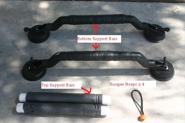

Here are a few pics. If anyone wants more details just let me know.

That is the only way I have ever done it is with 2 boards. No problem. I will try to do a write up when I get time. It wasnt that hard here are a list of materials.
2 of the harbor freight suction cup handles cut in half.
4 45 degree pvc pipe 1 1/4" size
1 8' Section of 1 1/4" pvc pipe.
4 1 1/4" pipe caps for top supports.
2 sections of foam pipe insulation for padding.
4 bungee cords to attach top supports to bottom.
Glue for pvc pipe.
Everything together maybe cost 30 bucks.
I sprayed the orange suction cups and part of the pvc pipe with plasti-dip to make black and covered the rest in black electrical tape.
After the fist trip I did take it all apart and rebuild. I took a heat gun to the horizontal pipes on the bottom support to melt it slightly to match the contour of the sunroof. If you dont one side will not want to sit flush and it will try to pop up.
