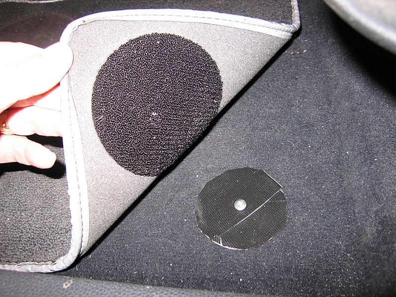

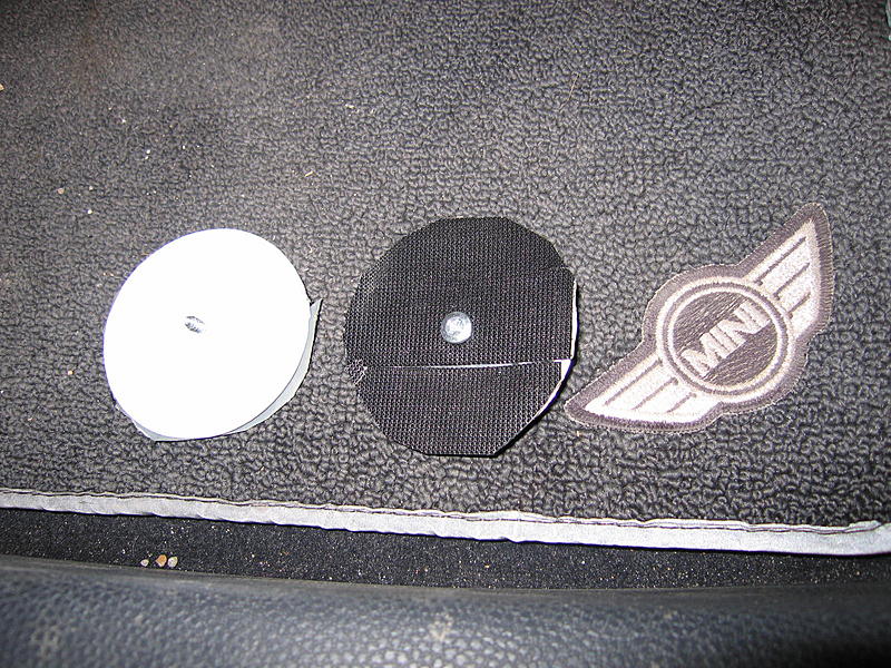

Here are a couple of pictures of what my tin can lid mod looks like. Maybe should have included these the first time.

From: nyc
nice work! it looks almost exactly like the oem ones.

I just used a 5/8" (long) sheet metal screw. All the screw goes into is the carpet and maybe a little of the floor board. You'll need to encourage the screw to thread in with extra downward pressure, the springyness of the carpet wants to repel the screw. That is all it needs to anchor itself down. It doesn't penetrate beyond that so there are no worries about cutting into the muffler bearing grease reservoir or anything like that. Give it a go and good luck.

The OEM discs just screw into the foam/carpet, not through any kind of metal. No need to drill any holes.

Followup on the tin can lid carpet fix:
I pulled the carpets out to vacuum a few days after installing them and the lids came up with the carpet. That left me with having to screw them back down again. The solution is to gently lift the corner, reach a finger under to hold down the anchor and then peel the carpet back and off. Otherwise, you'll be brandishing a screwdriver (mechanically and/or expressively) every time you clean the carpets.
I edited post #47 to reflect a misnomer in hardware used. I originally described using machine screws when the proper term should have been sheet metal. I also replaced the original 3/8" with 5/8" which hold better.
