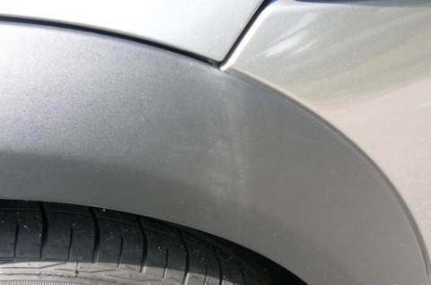

Finally! figured out how to do this...
here are some pics of the cosmoline goo that is dripping from the hood of my brand new (6+ week old) '08 MCS.
Picture 1 is totally what my black trim looks like on one side, and the other side looks worse from my trying to clean it up, which has only served to smear it. I will be calling my SA today to get some answers!

Yep here's the other side...
this stuff cannot be cleaned up. At least that's what the dealer indicated to me. The trim has been permanently stained/discolored.
