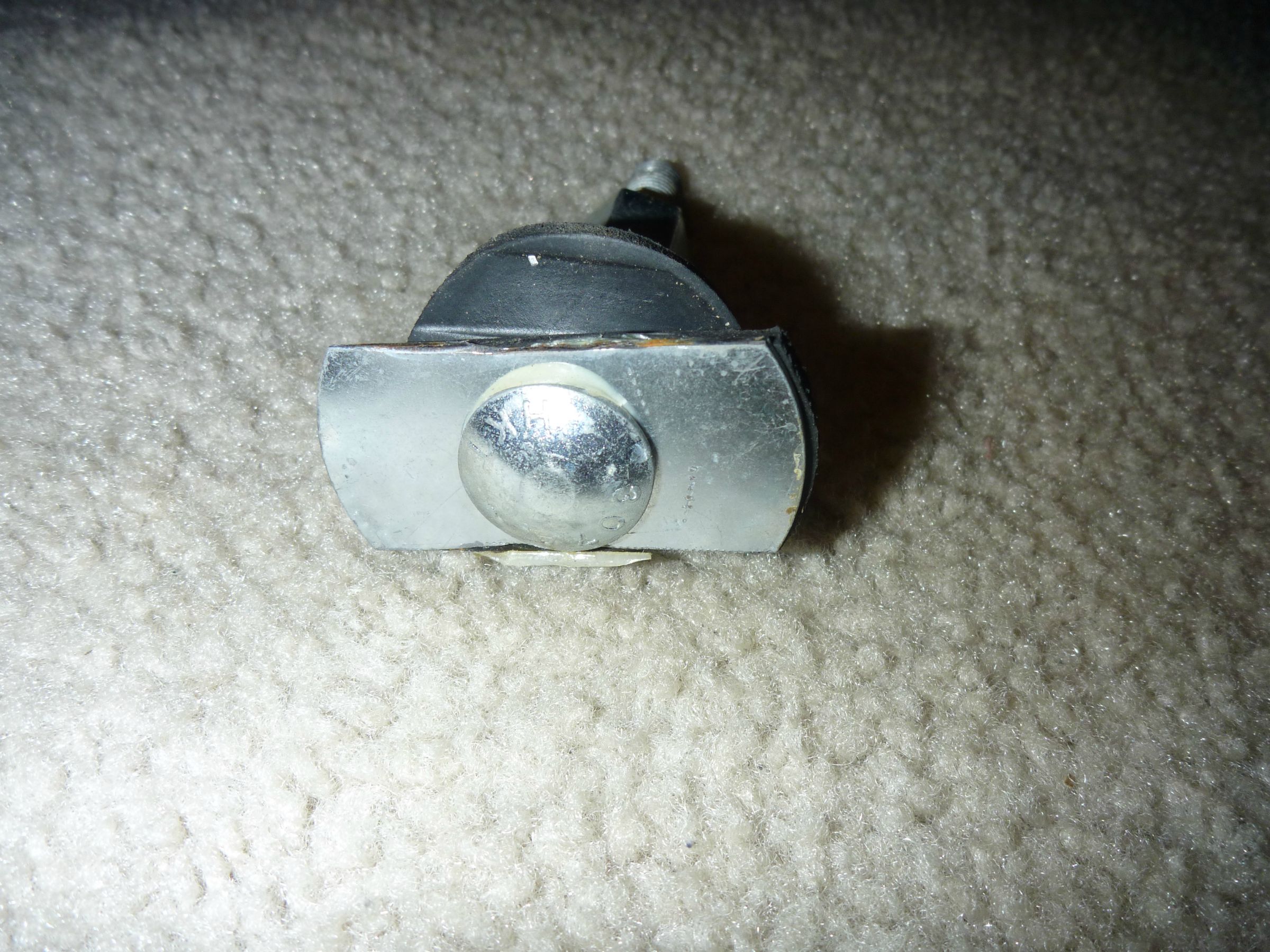

So basically what i did was make my own bars that fit Yakima rack and make adapters that went from the mini rack to and bolted to the bars. Here is what my adapters looked like this:

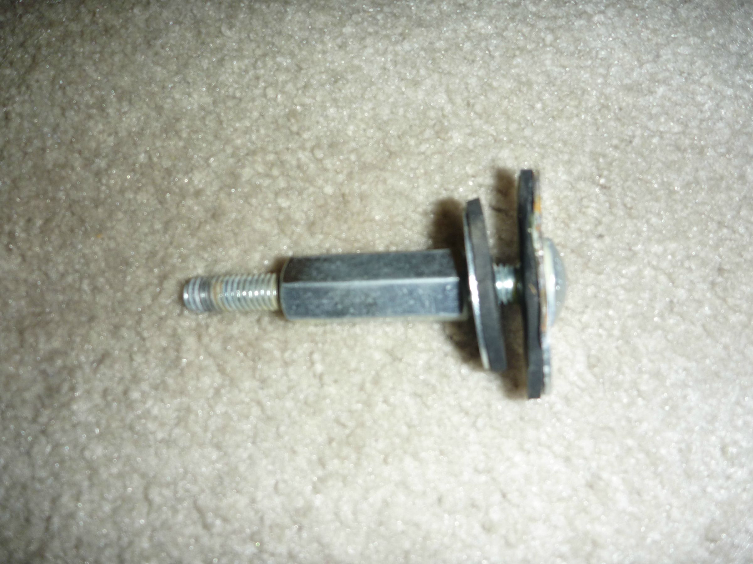

I made 4 of these, two for each bar. I glued together two sets of rubber and metal washers for each adapter. One set of washers i cut to match the width of the slots in the mini rack. I got 4 carriage bolts that went through the washers and a threaded spacer that fit on the bolts.
Here is one of the 4 clamp adapters i made.

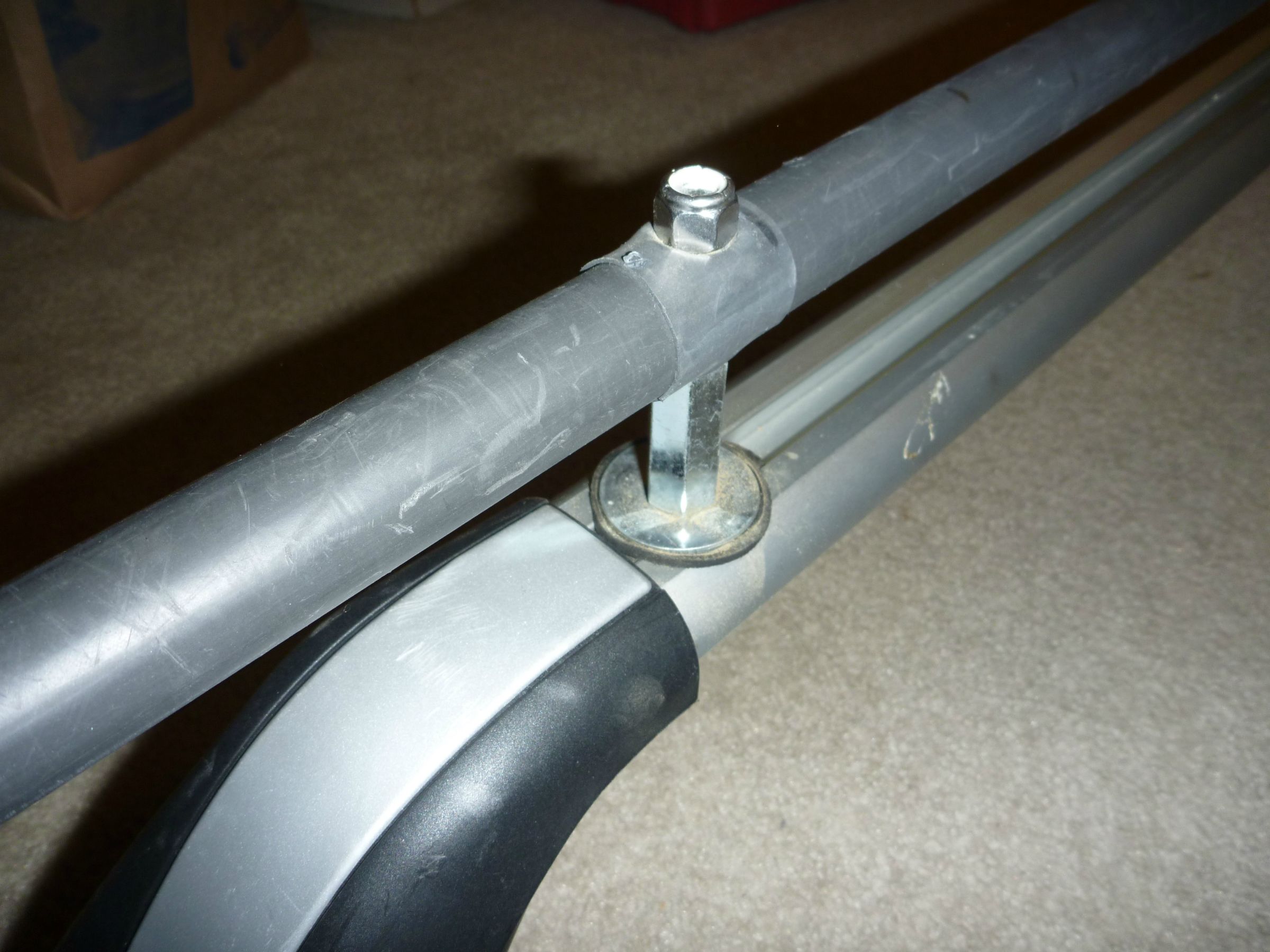

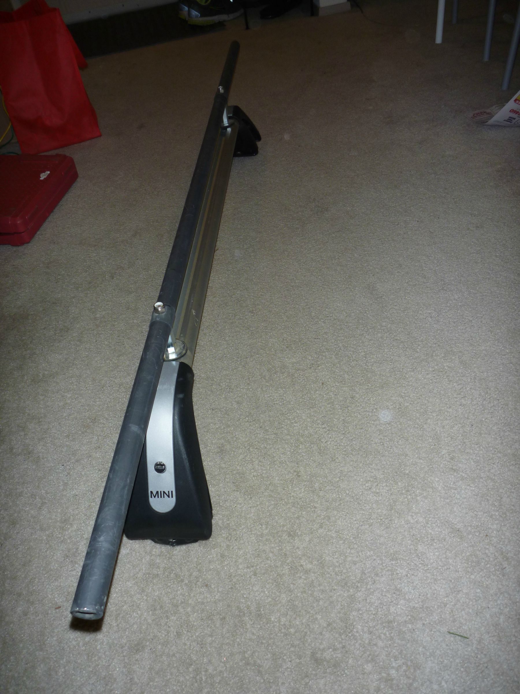

For the bars I took a 10 foot 1" pipe and cut it in half. I put two holes through the pipe that the bolts i used would fit through. I had tubing that fit over the outside of the pipe. I used some wire pulling grease to slide the tubing down the tube. Here is what everything assembled looked like. The last piece was a lockbolt on the top after putting the bolts through the bars. Here is the bar and adapters on one of the mini racks:

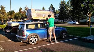

Useless unless you have to move a lot of stuff. It found out recently you can buy off the shelf adapters that will go to yakima attachments. But it really saved me when i moved from Connecticut to Seattle. The mini rack is only 30" wide so i could have only fit a roof pod on it. With my bars they were 60" wide and i was able to fit the pod and two bikes. Here is a picture of that:
It's been useful getting furniture to (couch and a bunch of other stuff):
It was a little sketch with the couch up there but the bikes and pod were fine for 3000+ miles.
