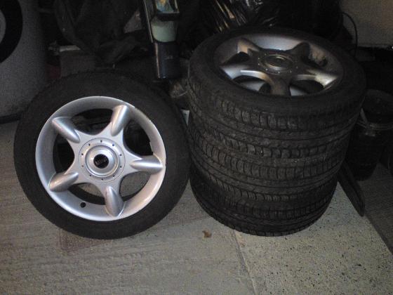

will this wheel fit on my 11 clubman S?
Hi guys, this is 16" wheel from older model mini.
will this wheel fit on my 11 clubman S???
I have 17" black bullet wheels but due to pothole damage i have to take it out untill it gets repaired.
thank you !
Jay.

If it is from a first gen car the lug holes might need to be drilled out to fit the 14mm bolts and not the 12mm bolts the first gen got for holding the tires on the car.
EDIT: WRONG, I was wrong and here is where it says so:
http://www.mini2.com/forum/faq.php?f...wheel_fitments
On July 12, 2006 the size of wheel bolts was changed from M12x1.5 to M14x1.25. There exists a misconception that this change in wheel bolt size precludes fitting early OEM wheels on later model cars. This is simply not true as all OEM wheels have holes large enough for either size wheel bolt.

Here is all the MINI wheel & tire info in one place.

i think they are actually 1st gen. ouch.. drilling is too much of a hassle.
i actually found that chart on mini2 forum but i dont know what it mean.
well does anyody here knows good rim repair shop in Los Angeles ? around downtown area?

If you read the link supplied after my first response, I was wrong and do apologize.
"On July 12, 2006 the size of wheel bolts was changed from M12x1.5 to M14x1.25. There exists a misconception that this change in wheel bolt size precludes fitting early OEM wheels on later model cars. This is simply not true as all OEM wheels have holes large enough for either size wheel bolt."
So basically I was wrong and you can use these.
