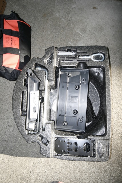

Continental 115/70/R15 90M Tubeless 50m/80k max
part # 4150083 02 077
Attached Thumbnails Spare Tire-_mg_5949.jpg   Spare Tire-_mg_5947.jpg   Spare Tire-_mg_5946.jpg
