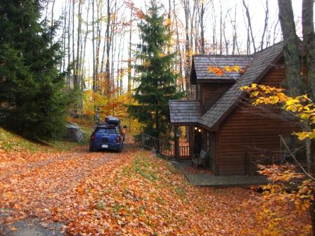

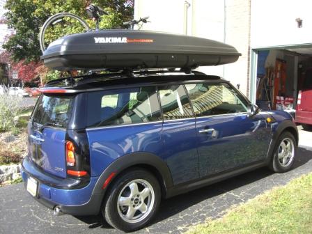

Old Oct 13, 2008 | 06:16 PM
  #85

Old Oct 13, 2008 | 07:20 PM
  #86
wolst's Avatar
wolst
Joined: Jul 2008
Posts: 15
From: Pittsburgh, PA
The "feet" are Yakima Low Riders (not Clubman specific, but work very well). The bars are 48". There is approximately 5.5" on the outside of each side in the front and approximately 6" on the outside of each side in the back.
Looks great any problems with the longer bars and hitting your head. Where did you put the front wheel of the bike.
The wind noise went away when I put the box on mine.

Sorry for the delayed response. I've been away on vacation.
While on vacation I hit my head twice. Not on the bar, but on the Viper bike mount that extends out past the bar. Both times, I was getting my two year old daughter into her car seat, which is on the driver side. I didn't have any problem when getting in or out of the driver seat and my wife did not have any problem on the passenger side.
As for the front wheel of the bike, I forgot to buy that component when I was at REI. So, for now it goes in the boot. Next time I'm at REI I'll have to pick up the wheel mount.
Wind noise was no problem.
Even with the bike and the fully loaded Rocket Box, I averaged 32 mpg in the mountains of WV. Most of the time I completely forgot about the bike and the box...nearly a disaster when I pulled under an overhang at the realty office!
