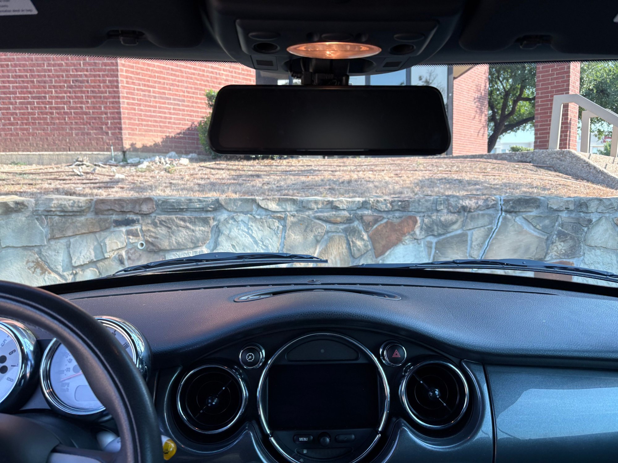

I decided to go for the Wolfbox G930 and am in the process of installing it. https://wolfbox.com/products/wolfbox...8a8ee2fc&_ss=r

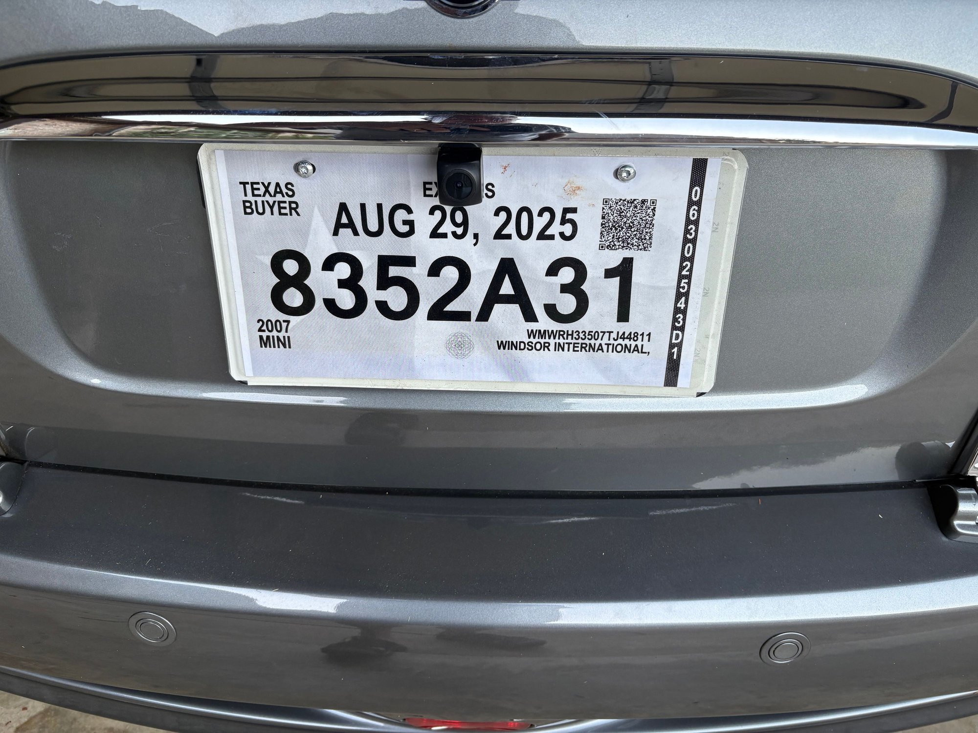

it’s the same width as the OEM though not as aesthetically pleasing. I was able to use Wolfbox’s oem bracket socket to attach to the ball and mount from my oem mirror. I just dipped the ball in black plastidip four times to build it up to fit tightly into the socket. I mounted the camera using the license plate mount today and look to finish running power and the GPS sensor tomorrow.
I use their 900Pro in my Bronco and love it. The 930 doesn’t have as good a camera as the 900Pro but it’s got to be better than barely seeing anything because of the roll bars/headrests and it should help with the blind spot when the top is up.
Update: the Wolfbox is available with three options to power it. One is an OBD connector. That didn’t work for me as the OBD initially powered up the mirror but did not stay powered. The second is through add-fuse to the fuse box. It uses a ground wire, a B+ wire and a ACC wire. For whatever reason the mirror would not power up or down when turning on the ignition but would only power up by the power button on the bottom of the mirror. My Bronco is wired that way and I had no problem. The third power option is a cigarette lighter plug. I’d converted my console plug to usb so I got a 12’ female to male to reach the socket in the trunk. The cigarette lighter method won’t support the security feature but, oh well, I have t needed it in my Bronco.
For the gps sensor, I affixed it to the inside of the trim to the left of the mirror and map light and it appears to be picking up the direction and mph just fine. I was worried it wouldn’t since the metal windshield frame is above it. Totally hidden.
Another thing I learned was to remove the circuit board from the oem mirror and keep it connected to the car to retain the key fobs’ lock/unlock function. There’s plenty of room in the panel above the mirror to store it.
The last thing I did was add a matte film to cut glare with the top down. www.screenprotech.com will sell wet mount film that I mounted on the mirror then trimmed to fit.
I should have taken a picture with the mirror lit up. Maybe tomorrow.
