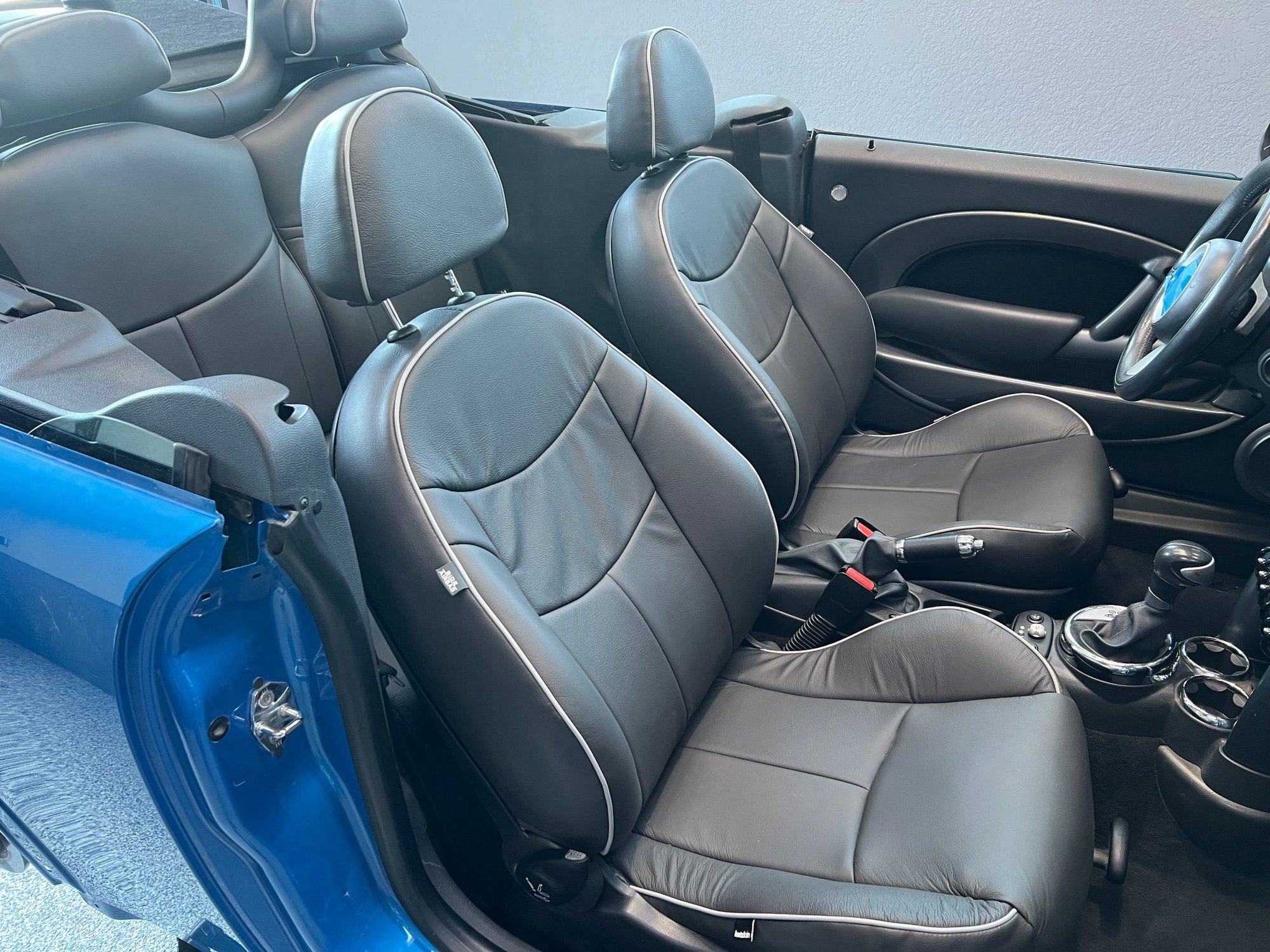

I just completed this exact job with the R52 I'm building. I used Katzkin. If you're going to do it, go with Katzkin, best in the industry and you have almost unlimited options for color, fabric, stitch options, etc. and their kits fit like OEM. I've used other kits and nobody can match Katzkins quality, fit and materials. The factory "leather" was in horrible shape and just like you experienced, slippery, firm, which made the seats really uncomfortable. I haven't put the new seats back in the car yet, but they turned out really good. I did both front and the rear seats. I went with matching gray leather (the flash makes the seat look lighter than it is) and pipping to keep the nostalgia of this build.
It does take a lot of work though. For starters, this was a time when Mini felt it was a good idea to glue the material to the foam, so you'll have to cut the original material from the foam. I used a razor blade and just take your time. It's time consuming, but it comes off. You'll also have to widen the seams in the foam, so the material lays smooth. You also won't be able to save the original heated seats, so option for the heated seat kit. I'm still trying to figure out how to utilize the factory heated seat buttons.

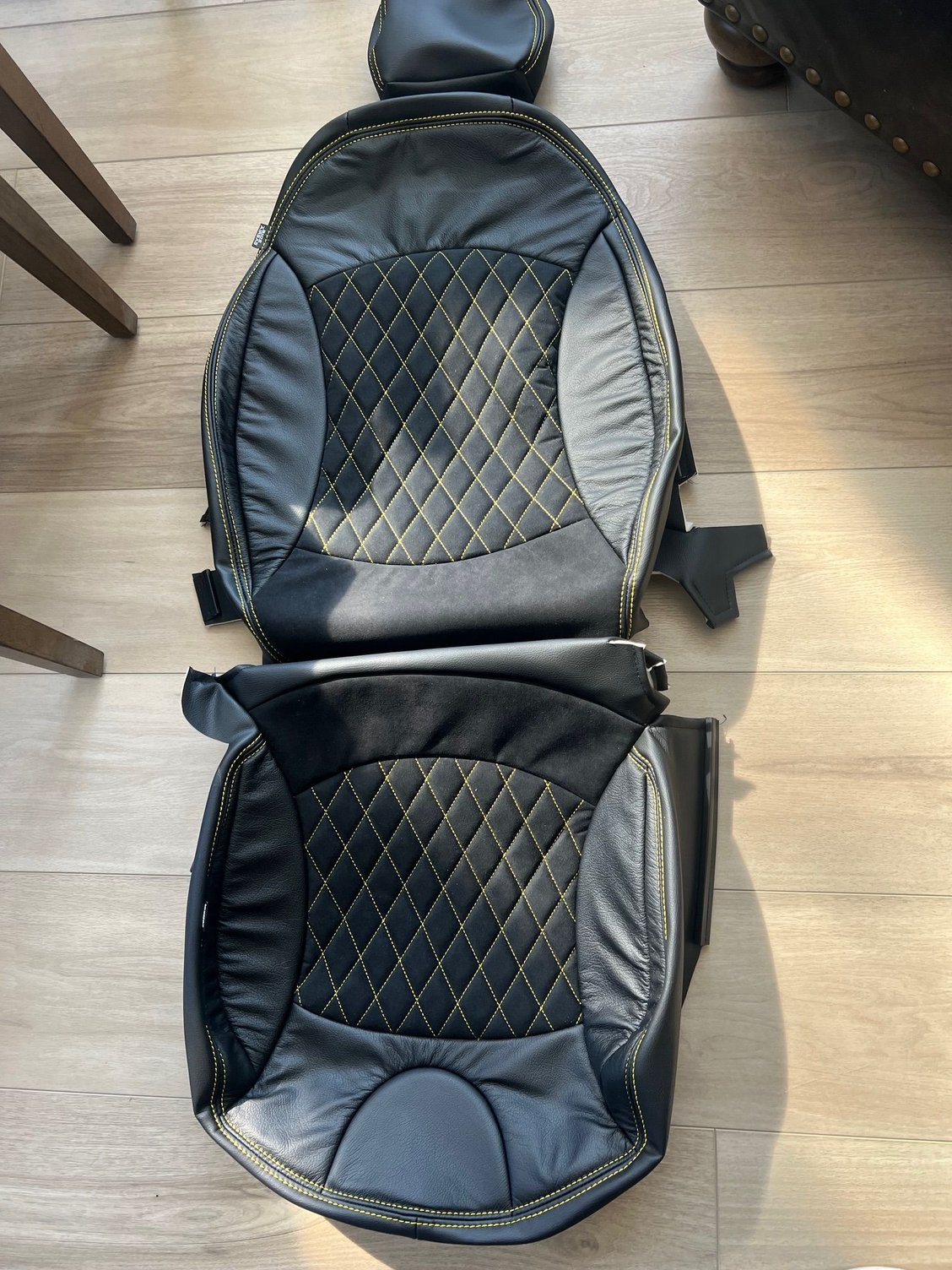

As an example of what you can do, here is the kit I'm installing in my R56 this summer. I went for diamond stitching and suede inserts. Yes, the car is yellow

I love those with the suede centers. I will have to Email them and get some color samples from them. Something like that is exactly what I'd love in my car. The diamond stitching would be pretty cool there too.

Got the seats back in the car. As much as I wanted to use the factory Heated Seats buttons, the wiring wasn't going to match up, so I installed the aftermarket buttons in the factory location. I was able to utilize the heated seat circuit in the fuse box with add-a-circuit and works like a charm. Color matches better than the original leather.
