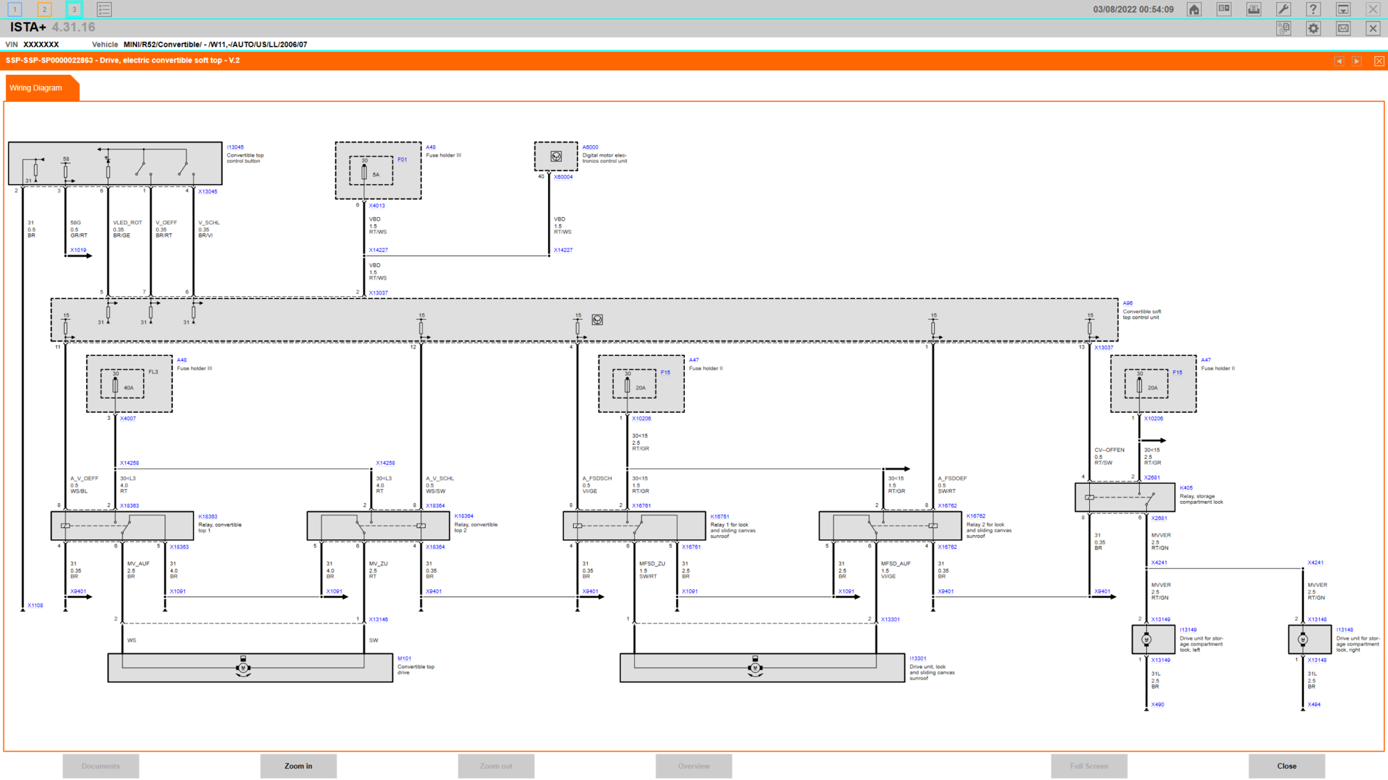

G'day all, has anyone got a link to a wiring diagram for the convertible top for a 2007 R52
tks Russ

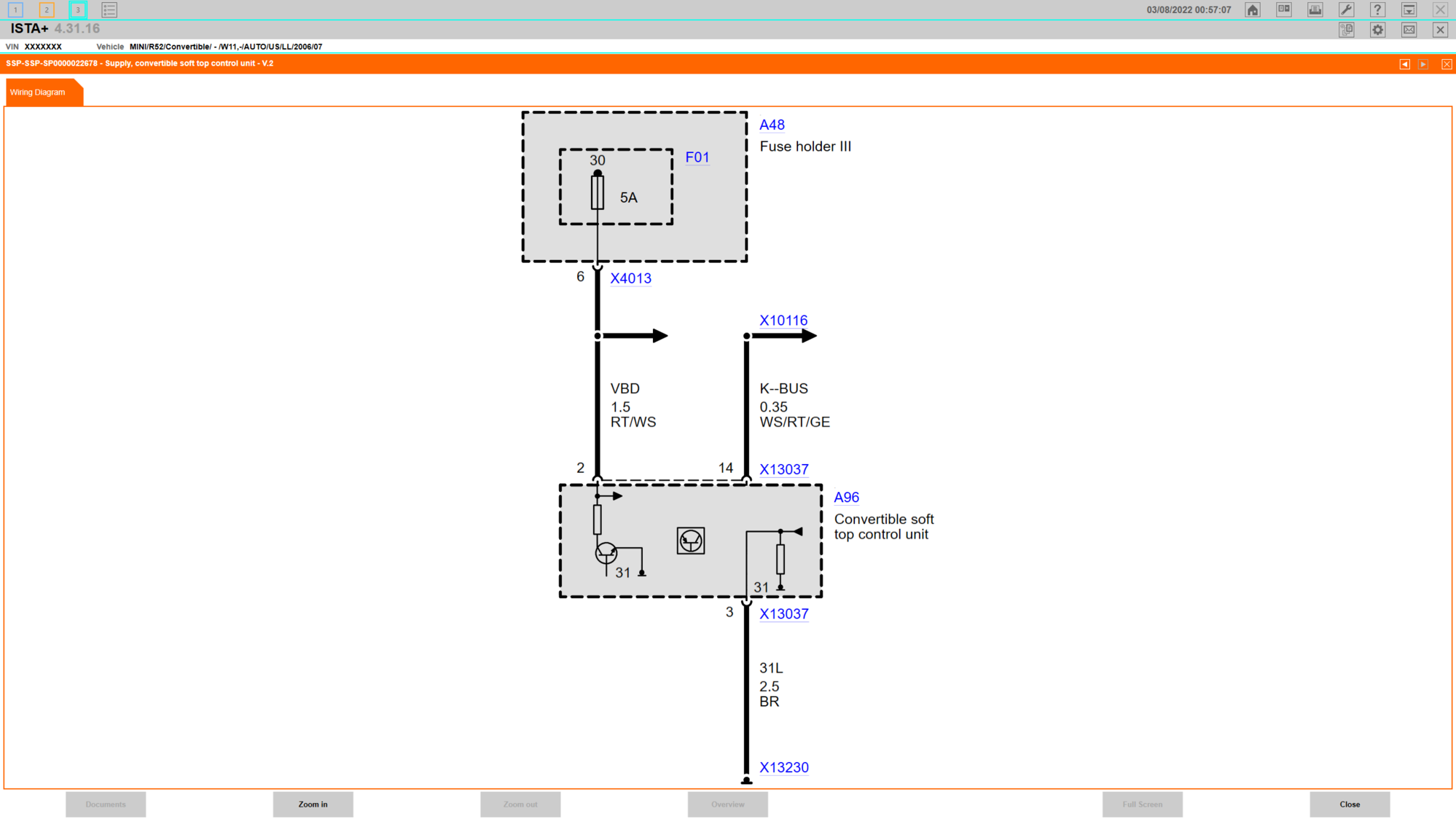

I don't think you can find wiring diagram online nowadays. What exactly do you need? Here is a general diagram of the convertible top from ISTA/D.

ty Nervos that's what I needed, having a problem with the micro switch on the rear parcel cover, might just bi-pass it, because I can't see why you have to have a cover for the top to open
