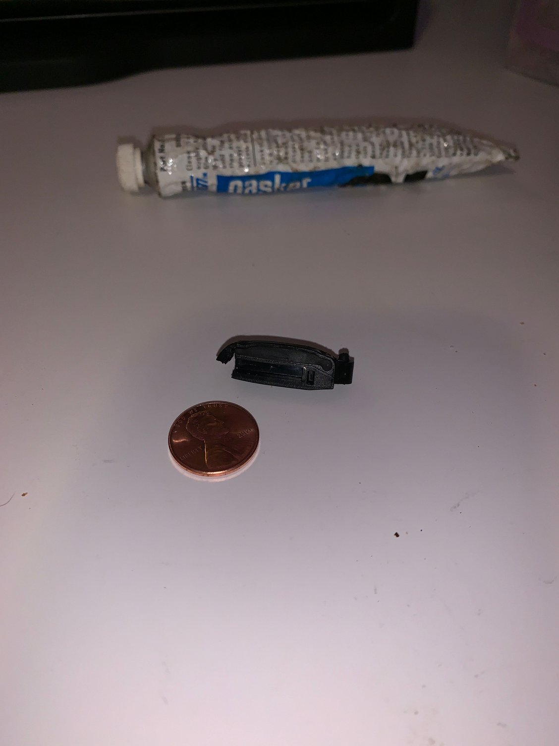

My wife’s 2007 Cabrio had this little small rubber piece fall in her lap the other day. At first, she thought it was a spider, and of course, it scared the wits out of her.
Can anyone tell me what the heck this little thing is?! Is it off the top? I looked the top over and couldn’t find anything even close to resembling this little thing!
Many thanks in advance.

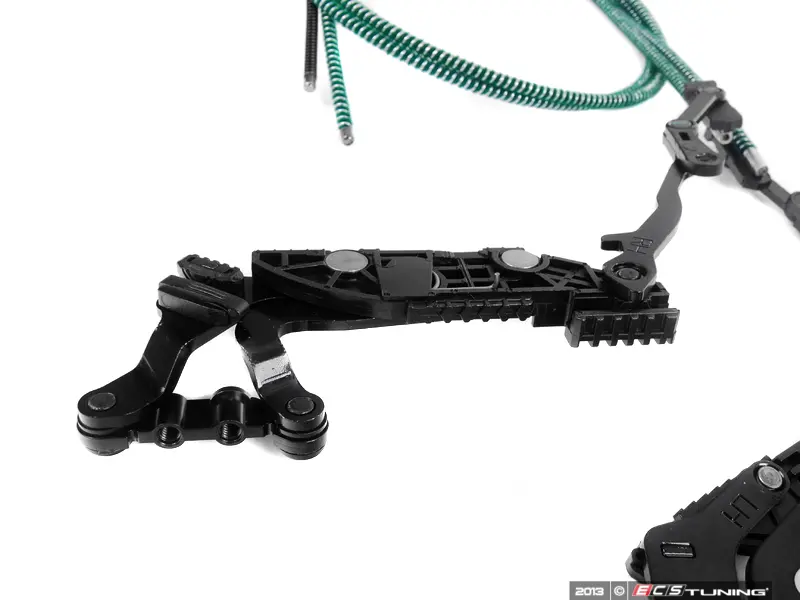

Looks like the guide to the convertible top cables. Rubber trim on it?
https://www.northamericanmotoring.co...ble-top-2.html
Those rubber pieces on the end of the guide.

Thanks. Another question. Would the lack of one of these rubber pieces cause a sight whistle while driving? My wife says she’s hearing a whistle.

Yes, its a guide and also makes the top slide and seal correctly. It will rub on the guide and could jam and bust the top. I would try to get it fixed.
