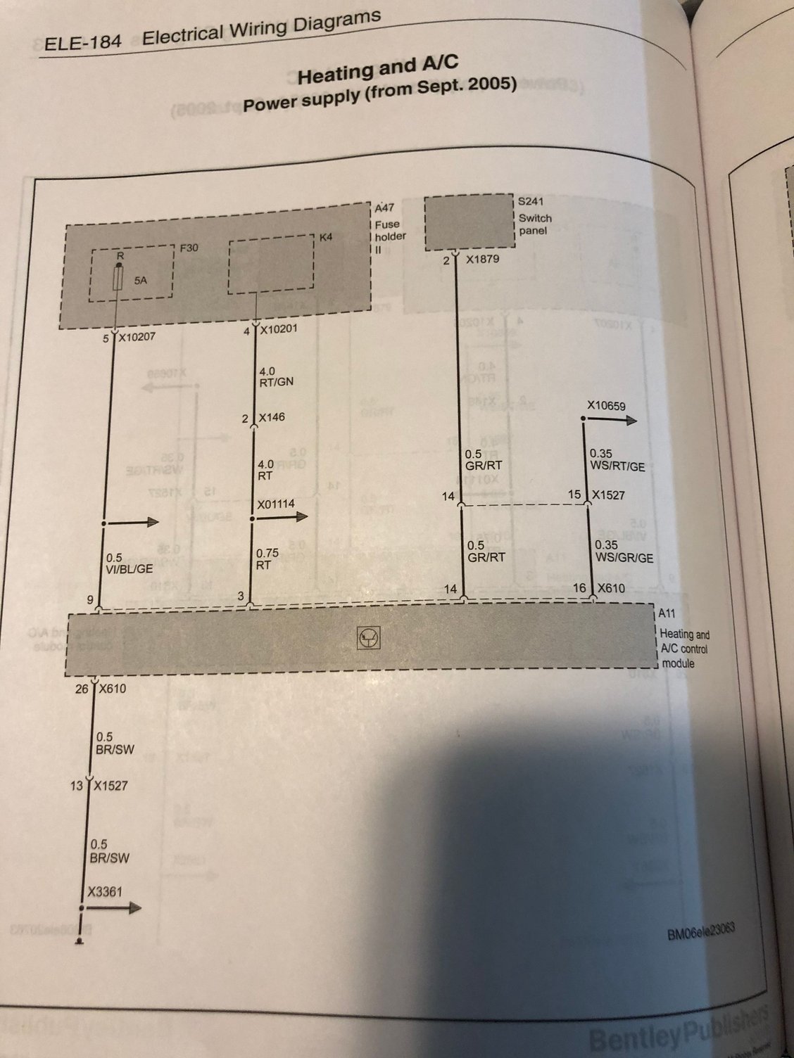

Here’s a wiring diagram, look for fuse F30 in the fuse panel behind the cover in the left footwell.
Two other things while looking at that fuse; 1) look at the inside of the cover and make sure it’s Fuse 30 and not Fuse 29, which it would have been a year earlier.
And 2) this is less likely but would explain what you saw:
Check that the fuse holder clip is tight to the fuse! That caught me one time on my wife’s minivan. A loose fuse clip caused a fuse to blow repeatedly. I put a twist in the fuse prong, and it’s held ever since. Not much I could do about the fuse clip itself without a LOT of work.

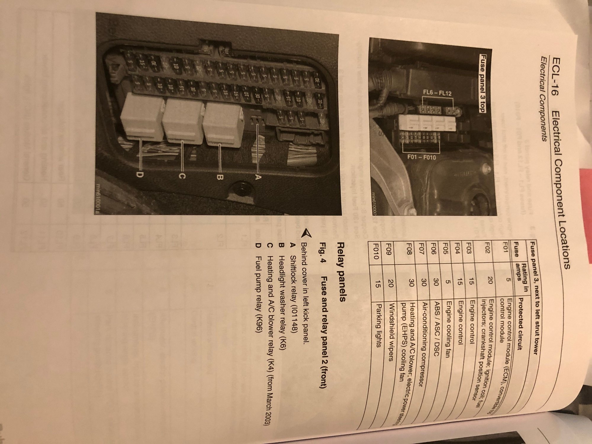

The K4 relay should be called out on the inside of the fuse panel cover too. Is it present? I tried to help another member with another 2006 (IIRC) but there was no sign of the K4 relay. Only an empty relay socket, no label. I’d change the relay while you’re in there, assuming it’s there. It should pull straight out.
Here’s a photo calling out the relays in the panel, but I suspect it’s for 2005 and earlier.
If your fuse panel is different than the one in the lower photo, please let me know.
