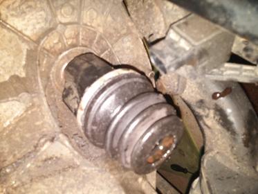

Taking the axle loose was easy except I ran into one issue. I plunging joint end stayed in the transmission. I'm afraid to pry it out. I took the passenger side axle loose thinking I'd be able to tap the axle from the back side. However, that wasn't the case. I can't get a clear shot in it. Anyone have suggestions?

I took a strap (from a ratchet strap) and made a slipknot around the joint. I took the other end and wrapped around a crowbar and gave it a few form tugs and it popped right out.
