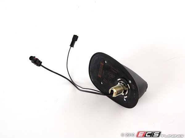

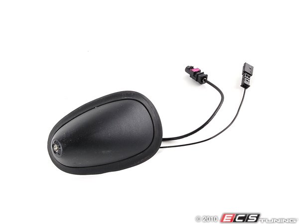

Check the antenna base and connections. If still an issue it might need replaced. You will have to unhook the rearview mirror and hat panel to get access to the base threaded connection.
Basic ( two wires ) 65206929760
http://www.ecstuning.com/Search/SiteSearch/65206929760/
Or
Navigation or Telephone prep 65206931565
http://www.ecstuning.com/Search/SiteSearch/65206931565/
