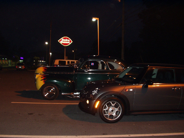

Hehehehehe. Here is my pic. July 28, 2002. Coming back from a trip to NY State. I also can't help but remember those early days. On our way up to NY (Friday night) we stopped at a Dairy Queen in Marshalls Creek PA - Hot Rod night. No car got more attention than The Beast that night I tell you
If you want the entire trip story of how I finally broke in the Mini here it is: http://mywebpages.comcast.net/jmiller398/
