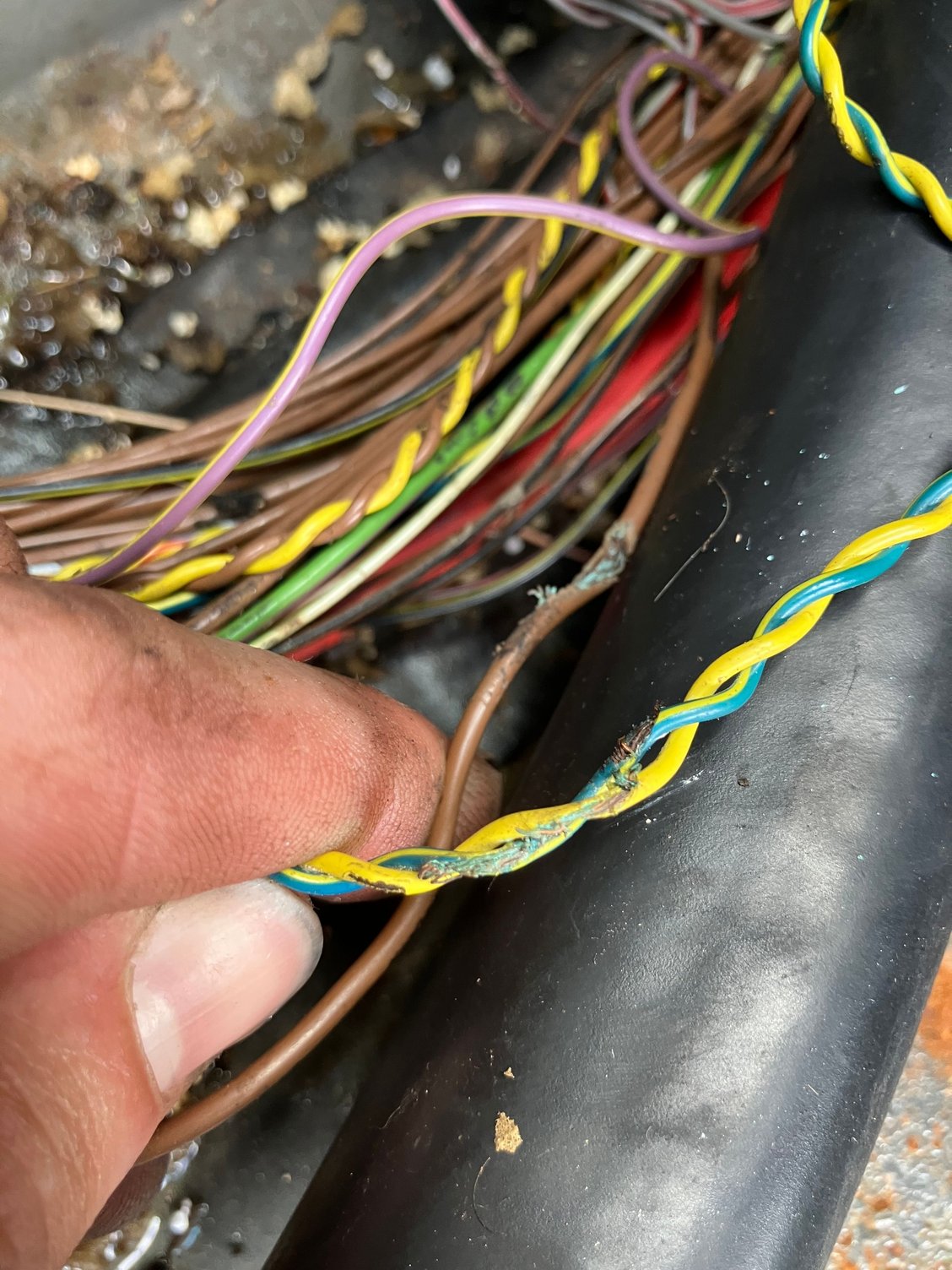

Can anyone help me identify these wires? They run in the harness along the floor underneath the drivers door under the carpet. I believe brown is a ground, but not sure for what. 2003 R53.

I expect the twisted pair is a data bus.

Brown is a ground. The twisted pair possibly for rear HK speaker or rear speed sensor?
^this
If OP is experiencing any CAN communication error codes these damaged wires are certainly the culprit.

The issue I'm chasing is intermittent. The car quit on me at a light and wouldn't start until the next day, but since has been fine. The OBD computer wouldn't connect for a while, then did. I figured it was all linked to the leaking sunroof drain, but then found these wires.
