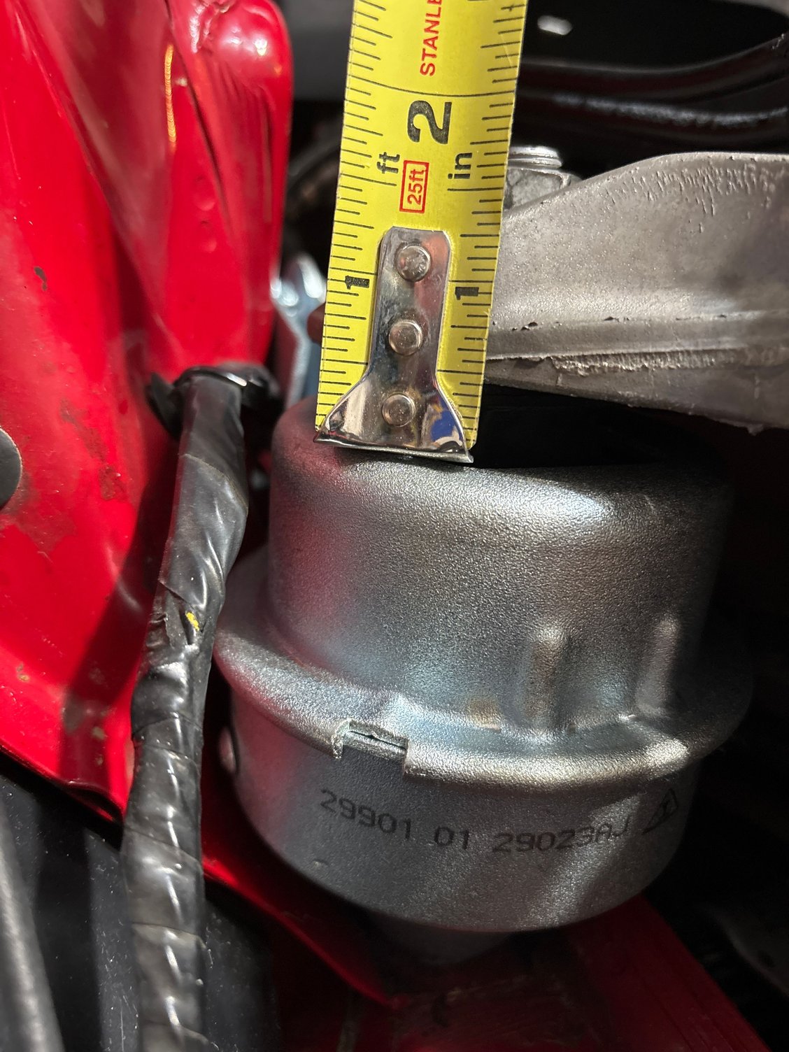

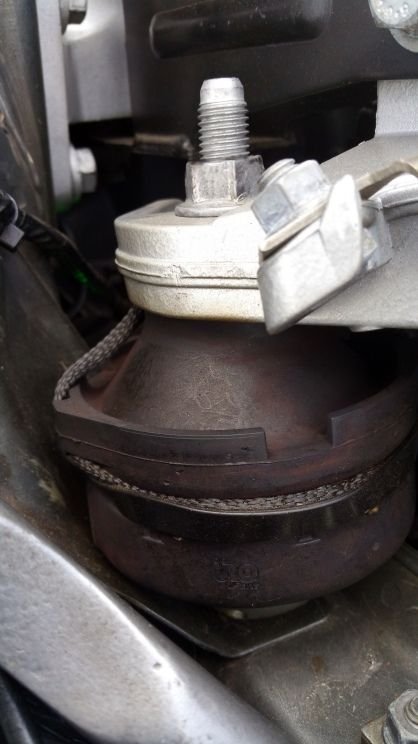

Motor mounts
Yes, the dog bone is so cheap it should just be replaced. The engine mount has a 11mm space on top when new.
My old mount was bottomed out on the rubber bump stop.
