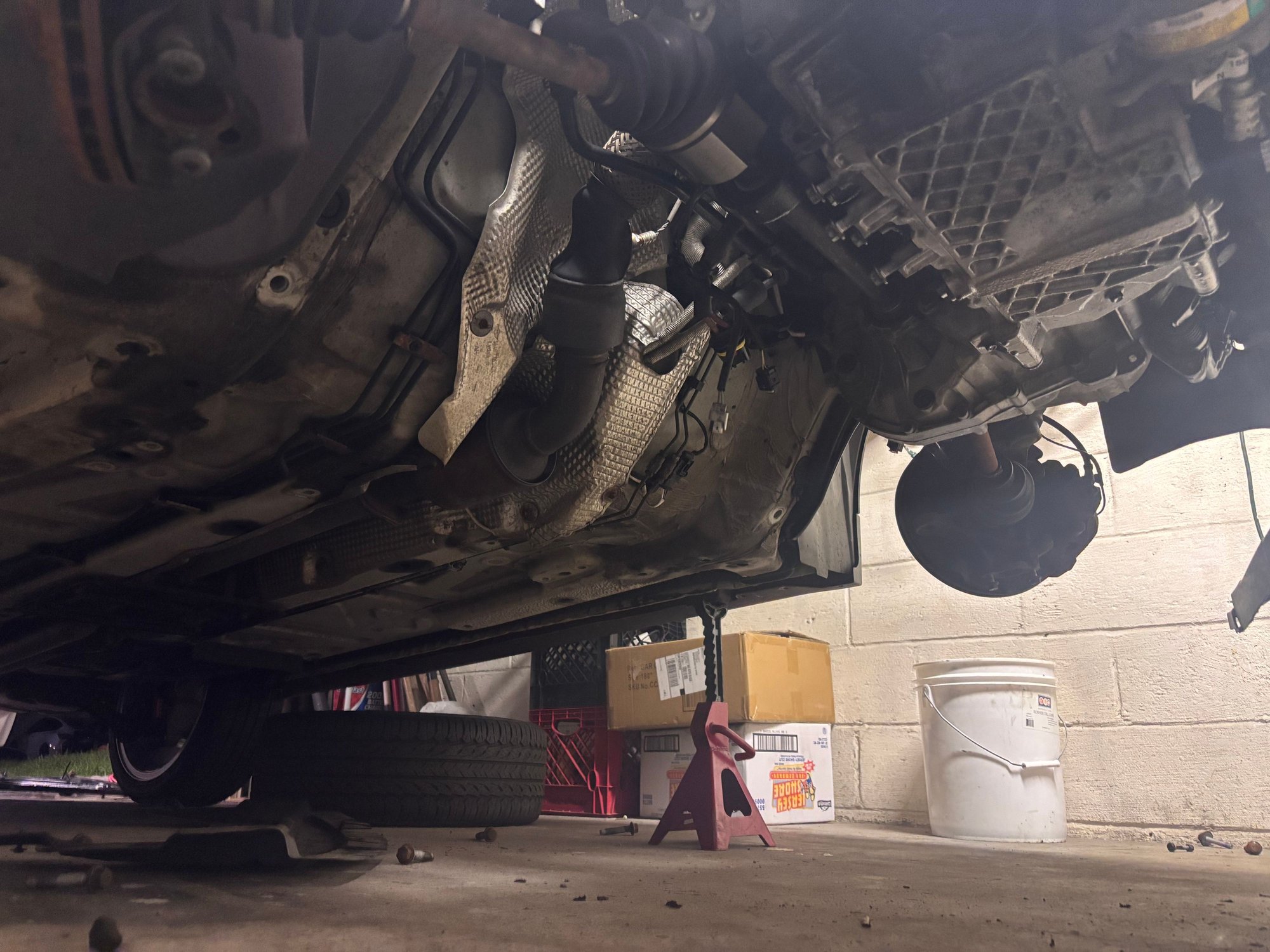

This MINI will suck every penny out of me lol. Attempted to replace my rear struts today and failed miserably. The lower shock bolt stripped and now I need to remove the trailing arm to replace it because the threads in the arm are also stripped!
So I took this beautifully horrible opportunity and decided to upgrade the trailing arms to the aluminum r56 rear trailing arms! I am extremely excited to get this project finished! I also had to purchase the spacers for the trailing arms to make the r53 strut fit along with r56 rear links and new rear r53 hub bearings. Pretty excited for this unexpected upgrade to make its way into this car! I just hope I receive everything before this weekend so I can do the job.
Had to see how the car looks with no shock. See photo for reference.

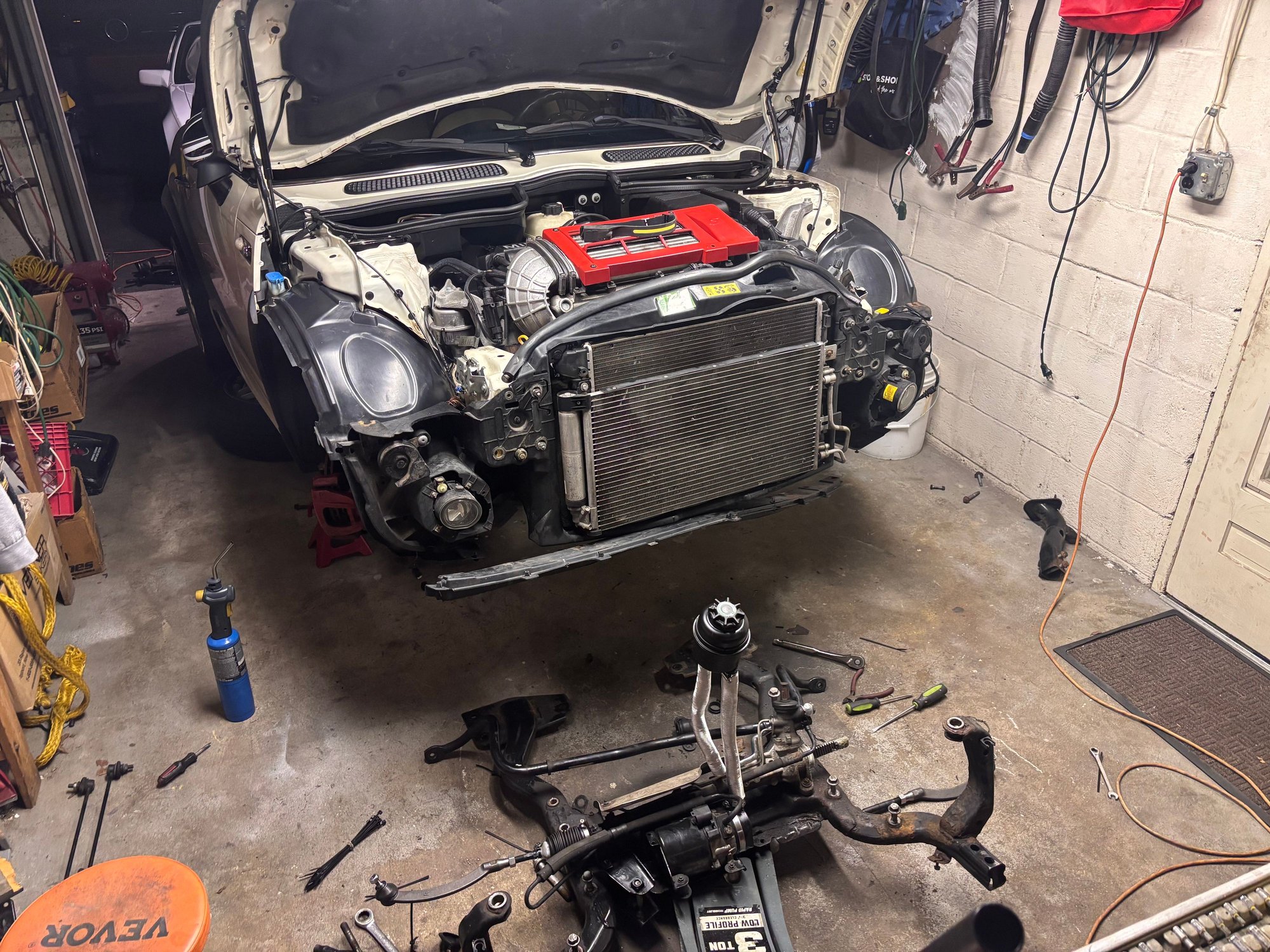

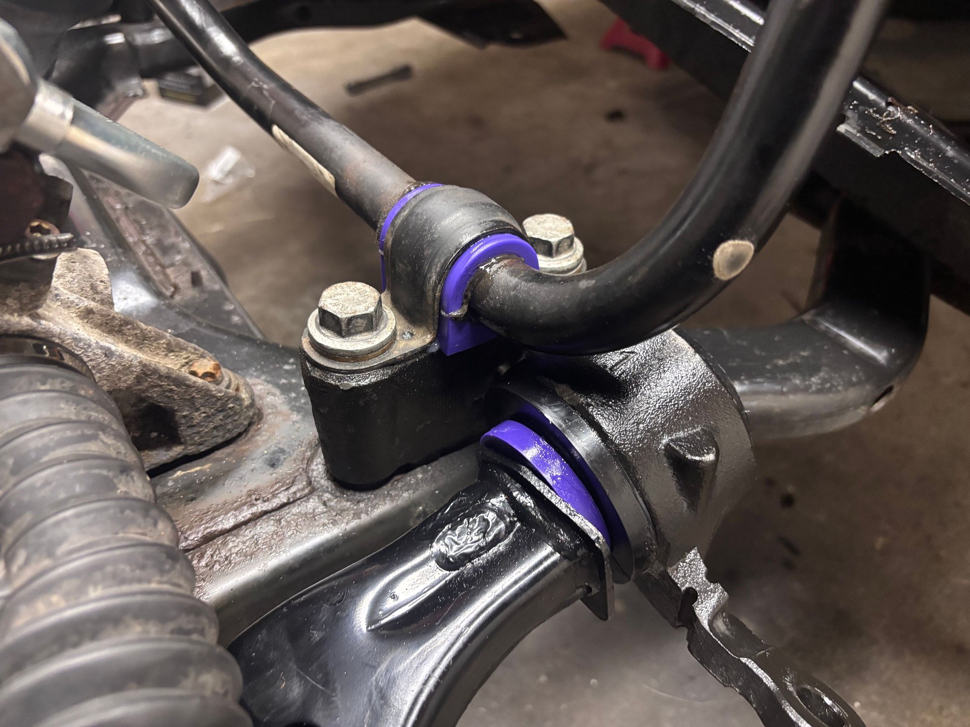

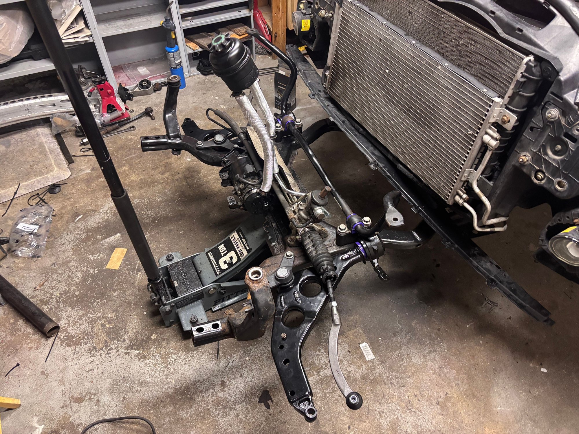

Update - 6/9/2025
Hello everyone!

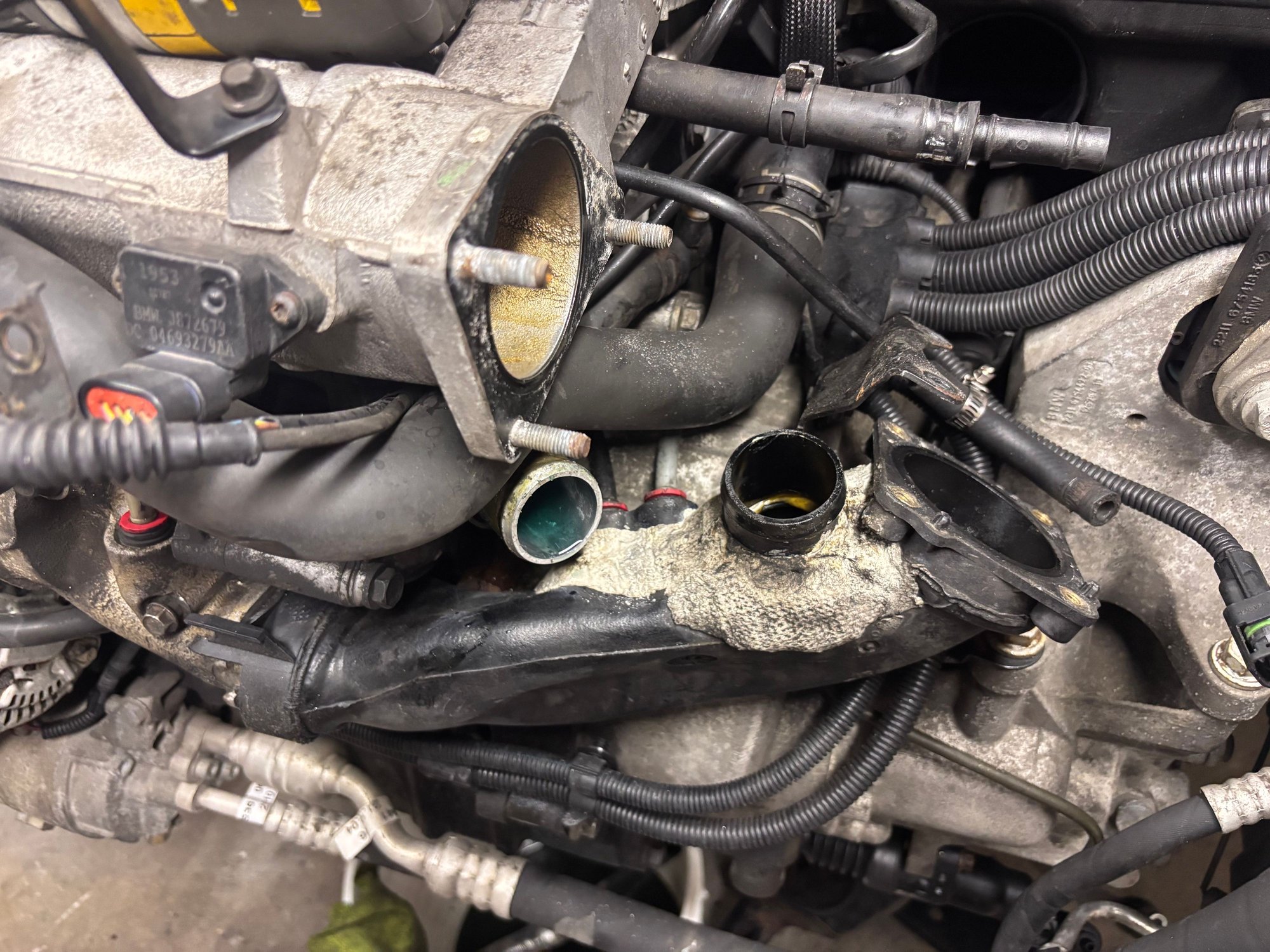

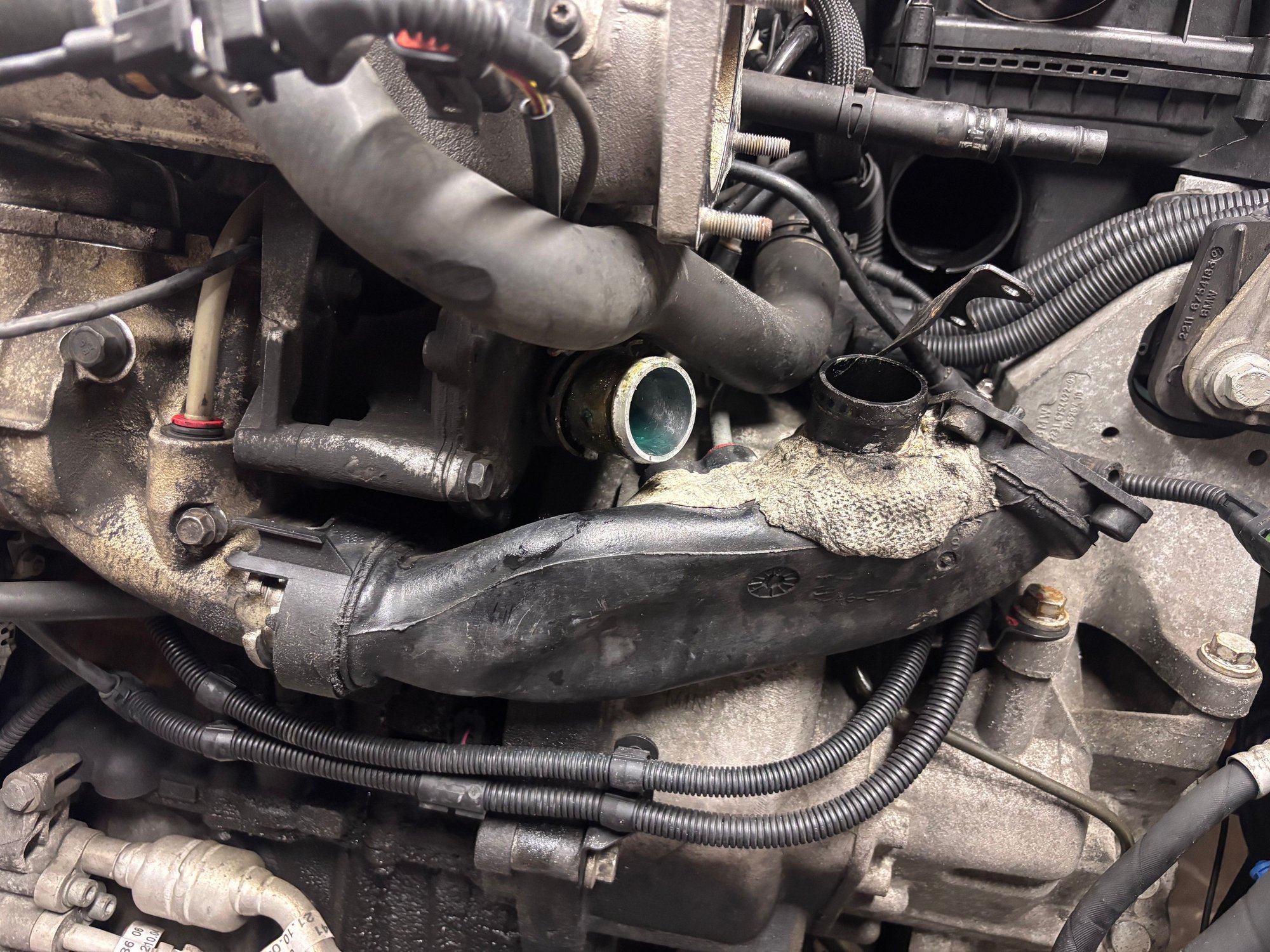

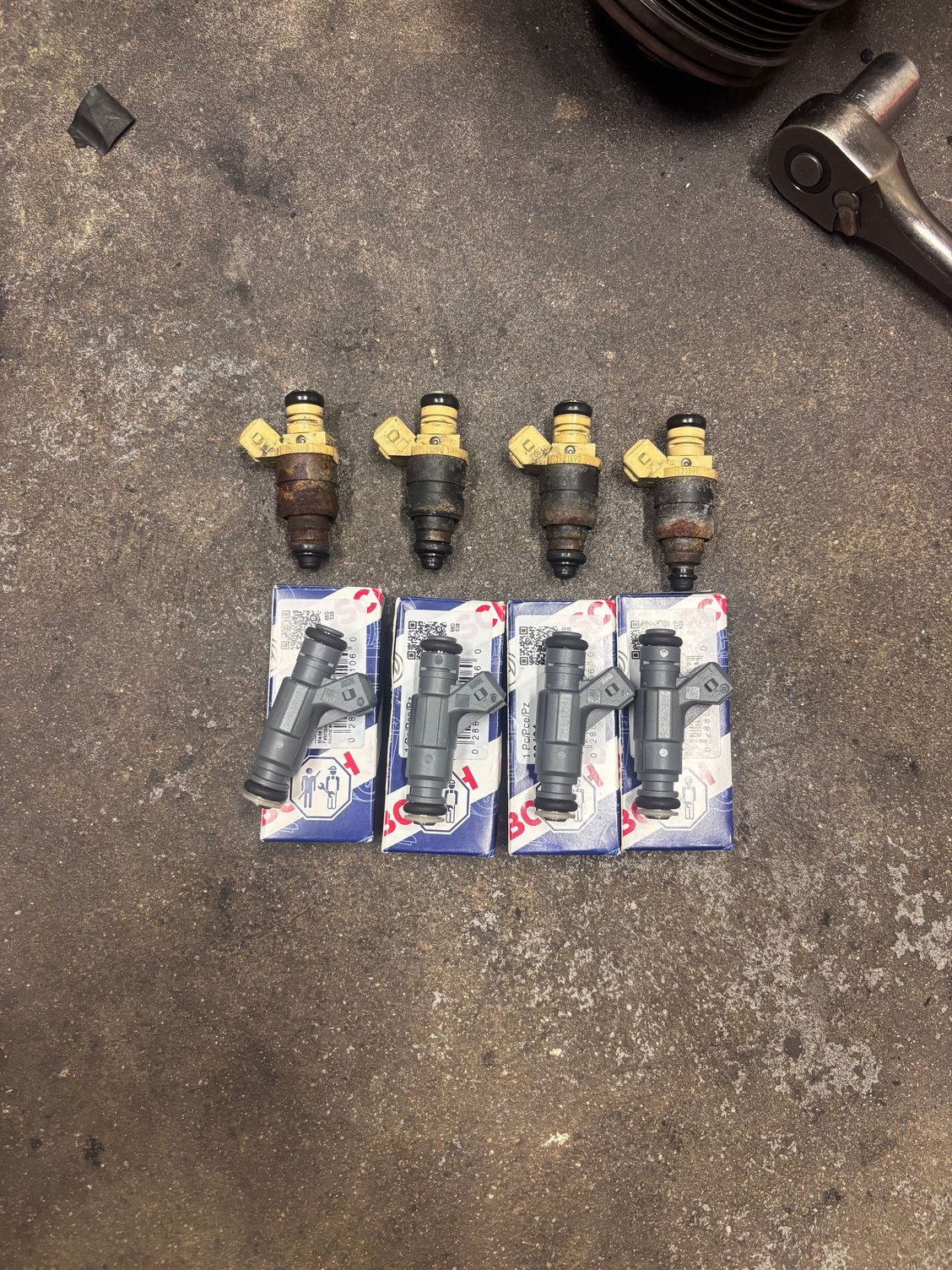

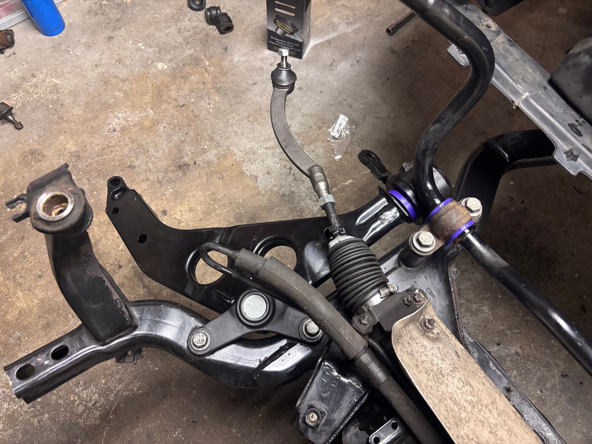

BIG BIG BIG update! I finally opened up the car and started working on her to fix all the issues it has. Actually, just before I opened her up, I decided to change the color of the XXR wheel set I have from the dirty black to a nice glossy aluminum color. I am inlove with the way it came out and especially the car now looks with it. It gives the car a much wider stance. I now want to add a 5mm spacer in the rears to bring them out more cause it does tuck ever so slightly. Here is a photo of how it looks now!
Anyways, the big job is finally done! Took me a few days to fully complete and now she's running strong! Made a list of all the parts I installed here it is:
  1. Victor Reinz Oil pan gasket
  2. X8R Supercharger service kit (left super charger horn metal gasket, new oil both sides (pulley and water pump side), green oval gasket, water pump gasket and flange to block
  3. URO Parts water pump
  4. Crank sensor o-ring
  5. Detroit tuned bypass valve
  6. Black hose from bypass valve to supercharger inlet tube
  7. Throttle body gasket
  8. Bleed screw o-rings on supercharger (both sides)
  9. Alta 15% pulley
  10. Bosch 380cc injectors
  11. Lower control arms
  12. Mahle oil filter housing gasket
  13. Lower control arm bushing both sides (power flex poly bushings)
  14. Sway bar power flex both sides (poly bushings)
  15. Inner and outer ball joints both sides
  16. New sway bar end links both sides
  17. New tie rod ends both sides
  18. Oil change with genuine mini oil filter and Kirkland oil. 5w-30.
  19. Coolant flush (blue coolant)
  20. Power steering flush (CHF11S)
  21. URO Parts Power steering return line
  22. Sunsong power steering suction line
  23. New belt gates k060535
  24. New AC condenser
  25. New red supercharger air boost line clip (it broke) from WayMotorWorks
Super happy about how the car feels! It is so solid and firm over bumps. That knocking sound I usually hear from the front end is gone and it actually was not from my sway bar it was my inner ball joints so I guess I did not really need the say bar bushing but its ok I like the way the car feels now so I am happy with the results. Turns smoothly with no abnormal noises and especially pulls strong with the 15%! I have not yet tuned the car I still need to get the A/C system charged and the car aligned and then I will get it tuned by Adrian. I believe right now the only upgrades I have felt is the bypass valve and the pulley. I will only feel the power gain from the injectors after I tune the car. I will post up some photos below.
All the parts laid out before installation. Super exciting!
another photo
another photo
So much room underneath. I worked on the subframe then I cleaned up the undercarriage. This is when I drained the oil and replaced the oil pan gasket along with the oil filter housing gasket.

This is my 3rd install of a pulley on an r53 but the first time I had to cut off the pulley. Very scary and I just kept grinding and grinding. Kept a spray bottle of water next to me to frequently spray and keep the temp down in hopes that I do not melt the gasket behind the SC shaft. Came off and installed the pulley with no problems. Super happy.
What did I say? I knew something was off and I called it once I got my car back from the guys that did my clutch! Seems like they broke the black snout off the inlet tube and used this weird cement foam glue to put it back in place. It worked but I am def not happy about it and will soon be replacing it.

Yippieeee. Sway bar and control arm bushings are in. All greased up and ready to go
So a dumb mistake on my end but I forgot to insert the boot on the tierod so I just rigged it up for now until I can find another boot to put in.
Same on this side I needed to modify the boot to work.
New power steering hoses in this photo. The old ones were so worn, I was able to twist the hoses even with the clamps on. Now with the new ones in, they are able to hold the res up fully!

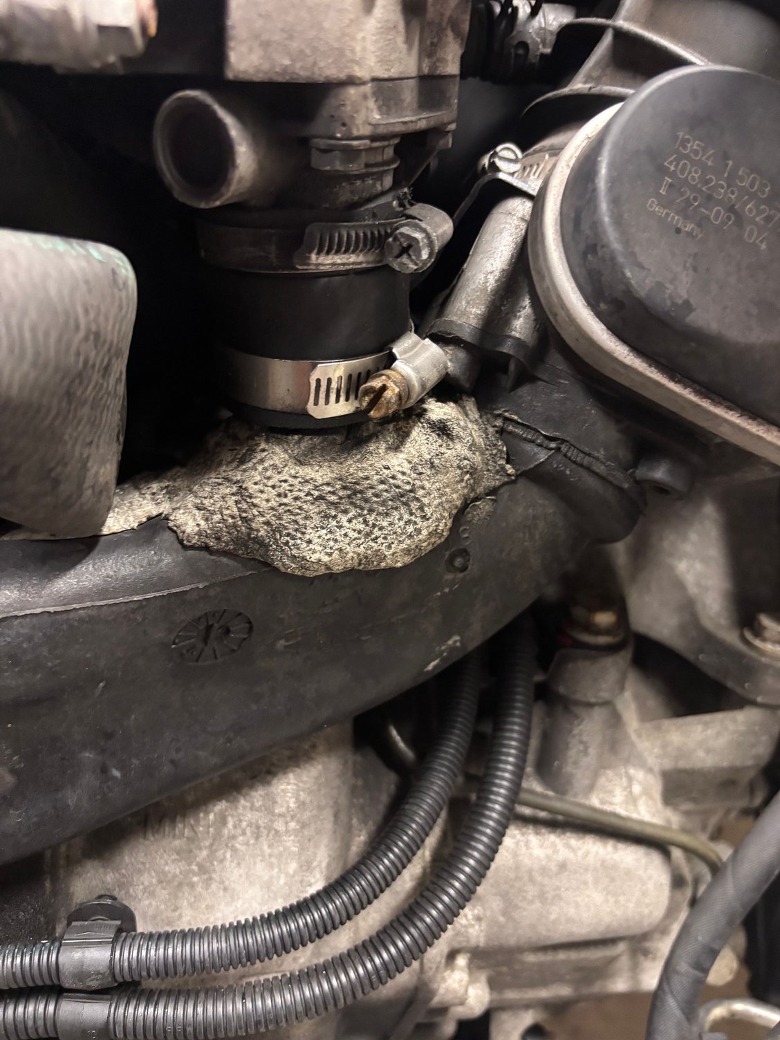

Out with the old and in with the new!!! Yucky 330cc injectors. They were all rusted and dirty. Super glad I did these. I also feel a difference in starting the car. Starts up immediately with no issues!
