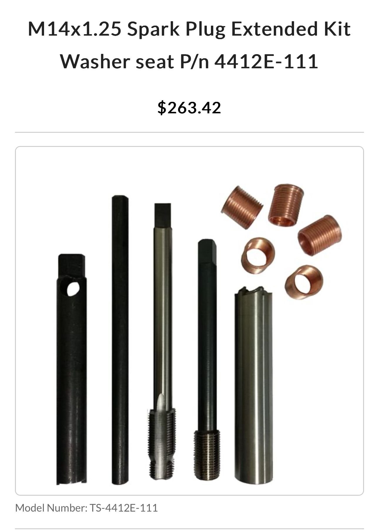

My 06 S decided to blow out the spark plug on cylinder 1. I was able to slightly tighten it and drove 60 miles home. From my researches time-sert is the best solution over helicoil.
1- Is this the right kit? M14x1.25? 7mm insert?

1. 7mm seems awfully short. The length of the plug is ~19mm IIRC. That kit will work, but it seems awfully pricey. I had good luck with the kit NAPA sells. It was an emergency and I was 800 miles from home, but their tap was sharp and the inserts were steel. Kits from other stores used aluminum inserts which kind of defeats the point IMO.

Thanks, much appreciated! It is pricey indeed. Do you happen to have a link or description of the Napa kit that worked for you? I need to figure out the insert length as 7mm was the one recommended on time-sert webpage.

@megaDan Is this the one you used?
