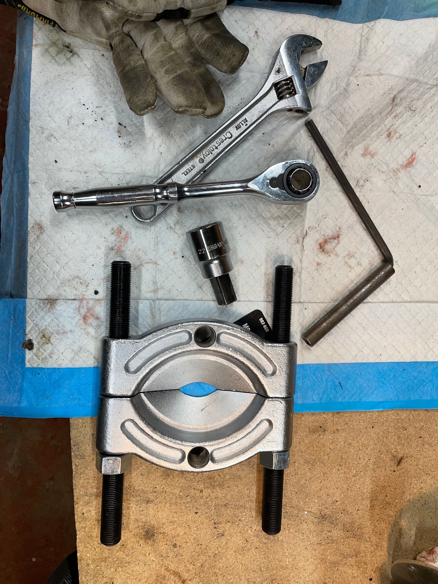

I believe you indicated that your were having issues with compressing the springs on the shocks. Not sure if this helps, but I just did front and rear shocks on my R56. Here is my Harbor Freight spring compressor setup…
Compressed spring
DIY tools; use at your own risk
The “clamp” is the large HF bearing puller. It fits nicely under the lower spring perch on the shock. I made a nut tightened for the top of the strut from a 1/2” drive socket with a 1/2” square tube in the drive end. Not sure if that will work with the Koni shocks but it did with the Bilstein B8s I am using.
I will say I am not a fan of the large rear swaybar mod. I had the Whiteline bar you have and found it to be too much with the stock MINI front bar. It moved the handling to one with too much lift-off throttle oversteer and gave it a high speed corner oversteer issue. Problem is, you won’t know that you will have that issue until you actually do have that issue; then it is too late if there is a guardrail near by. If you can find one, I would balance that with the optional MINI 24mm bar from the optional JCW spots suspension package. The other option would be to leave the bar on the softest setting and set the shocks stiff in the front and soft in the rear. And, not sure if you know this, but never fully close the adjustment screw on the Koni shocks. That will lock them up and that will damage them.
Not sure if any of this helps at all…

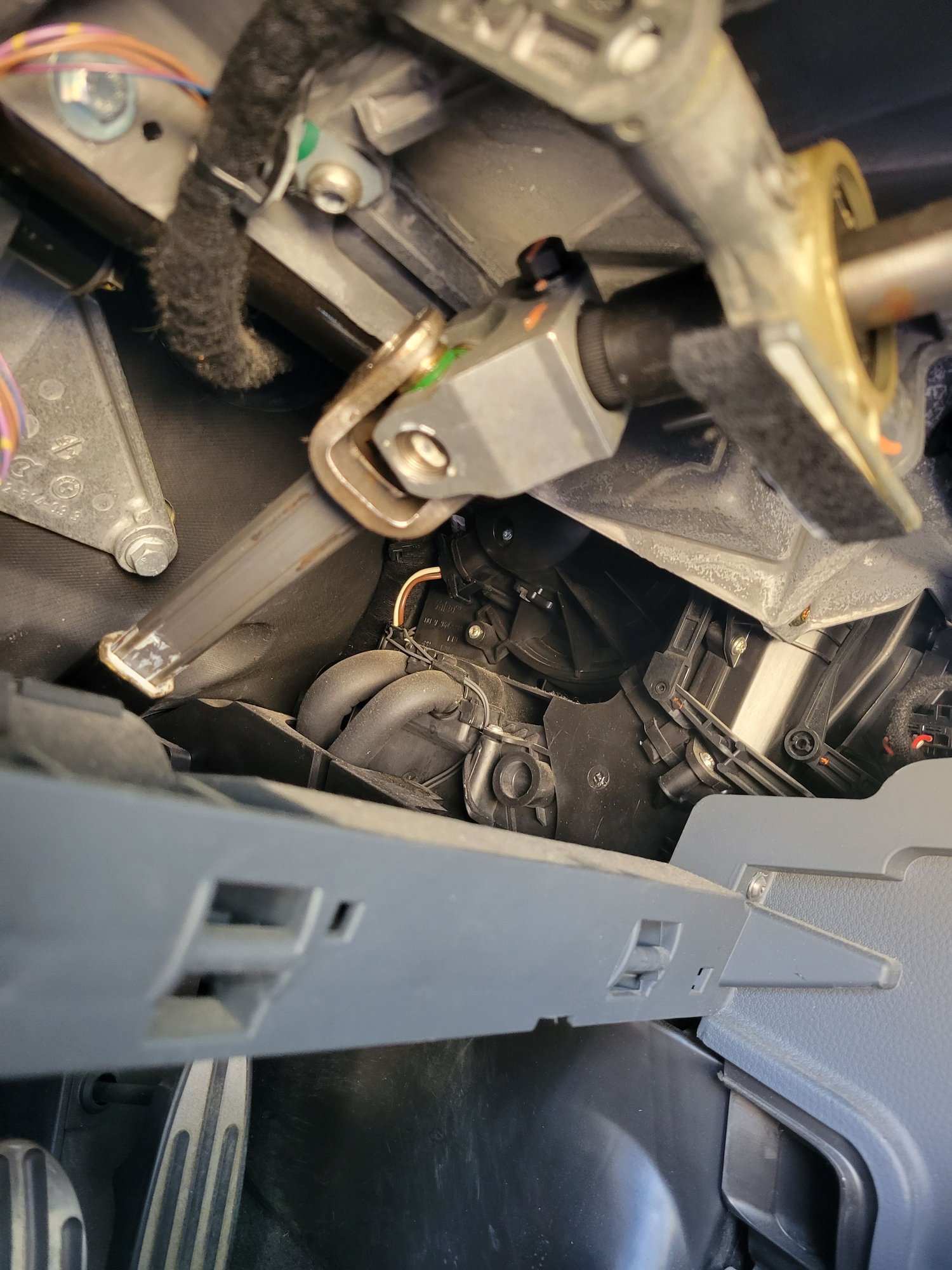

Didn't get much done today as I spent time fighting with my lawnmower that decided to throw a belt in the middle of my front lawn. Found a replacement I had on hand and it was just a little too tight so no dice. Got too hot so I called it a day.
Before all that happened I managed to swap out the bad steering shaft. It went nice and smooth so I will recommend that you all take a look at your shafts () and make sure the u-joint in the engine bay moves freely. I did not notice this until I went to re-install it after the sub-frame refresh. In the past the car always felt a little "heavy" when compared to the other R53 we have and when I swapped the PS pump it would not return to center easily. Well, this, I am sure was the culprit.
Several folks sell this part and it was over priced everywhere I looked. Found it at Rock Auto. Dorman Brand P/N 425-750. Cost $132.79. Most others were twice that!!
Install was easy (perfect fit) especially with the engine out of the way. Took more time to remove the damned knee plastic under the dash. It was ON there. You'll need a 13 mm on the engine side, a 10mm on the cabin side and a T25 torx to remove the bolts that hold the under shaft cover.
Some pics: ( I just noticed, I meant to set them side by side identically. I have one the wrong way. It was already starting to get hot so I was rushing...) Nevertheless, you get the idea.

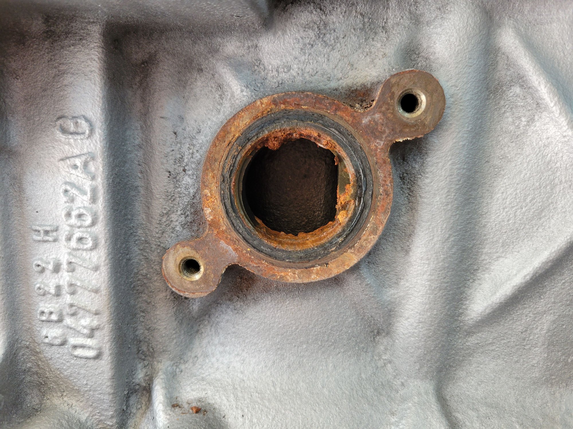

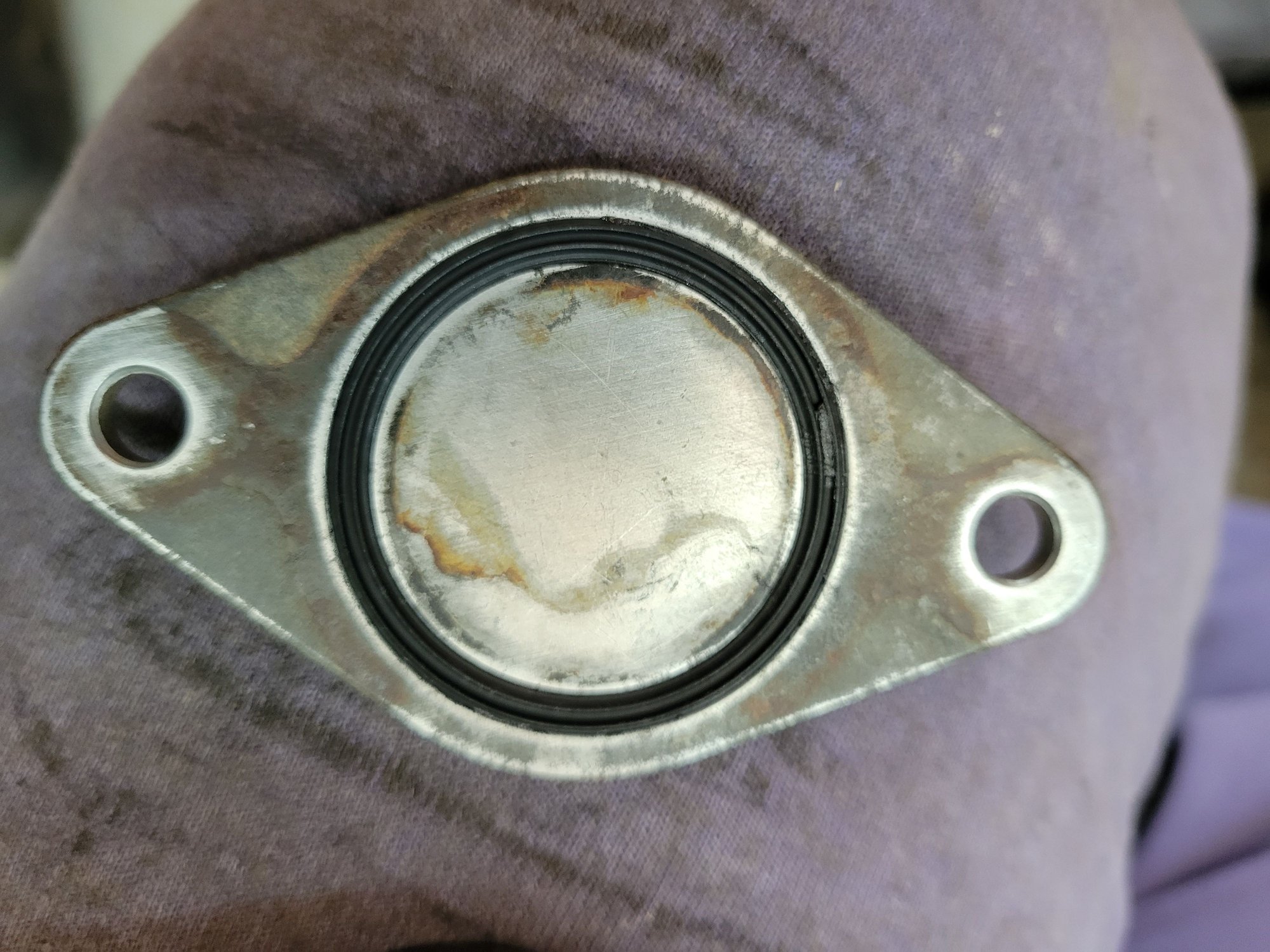

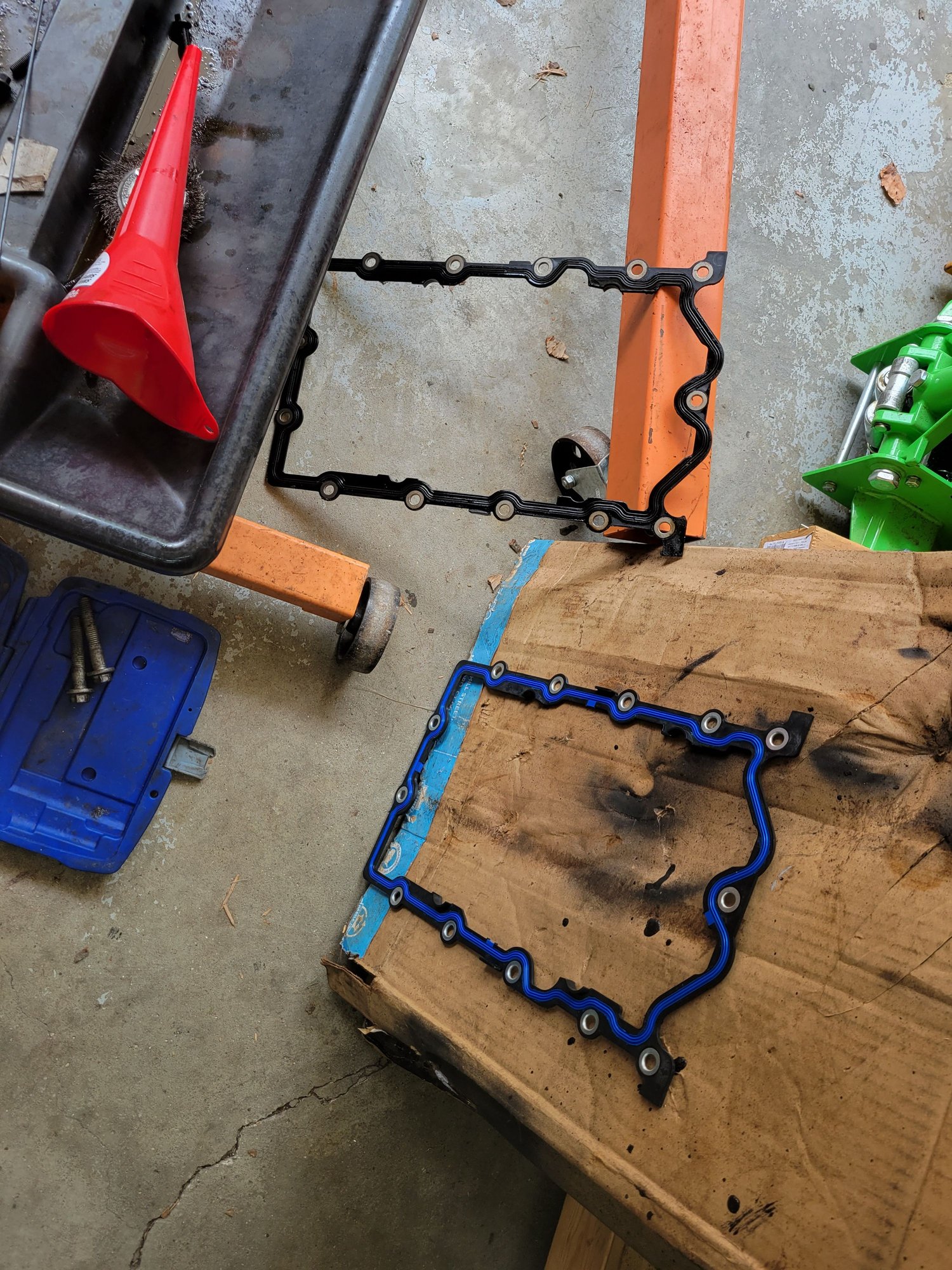

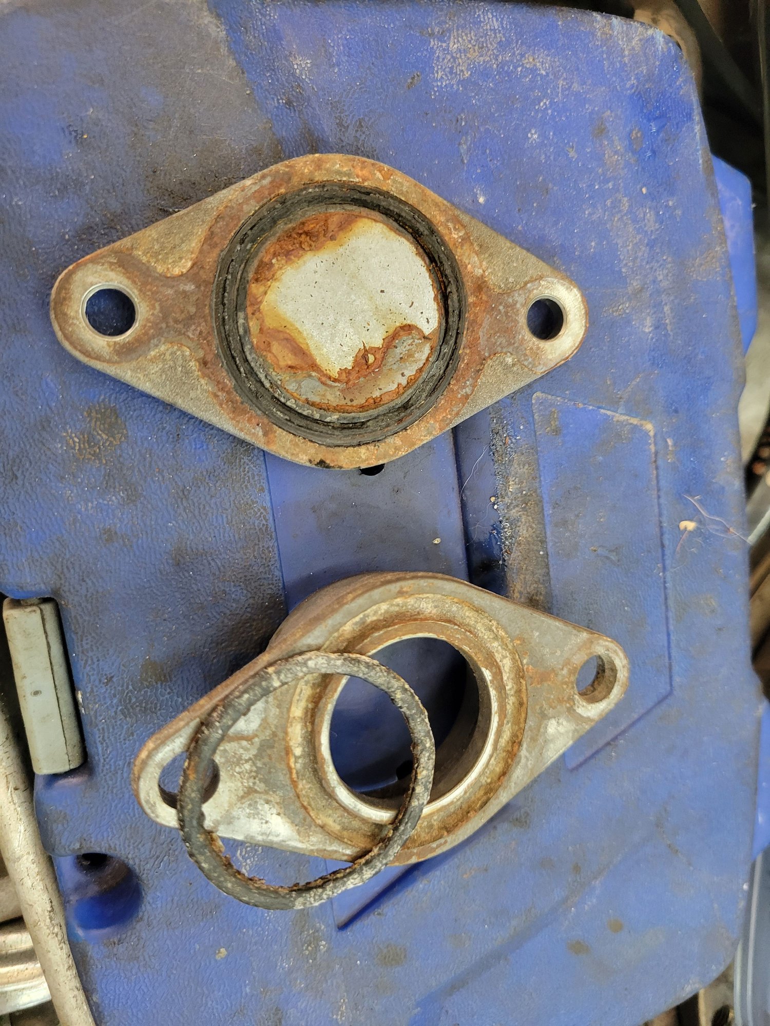

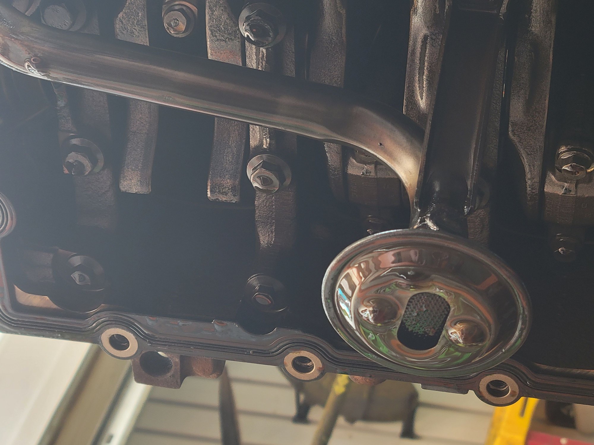

Back to work with a little progress. Funny how something you think should take a few minutes turns into hours... Ugh. Anyway, today we tackled the rest of the rear end, installed the shocks and springs (with my new spring compressors)- I may need to do some pics. Pretty nice set up. So, we did the brakes, shocks and that stupid lower bolt (and I ordered new ones with a new triangle washer) was still a bear to thread into the rear sub frame so I had to stop and chase all the threads, use ample anti-seize and they finally cooperated. Installed the inner fender plastics and called it good back there.
Then dropped the oil pan. (even after draining it had a surprising amount of oil left behind. Dumped it out, cleaned the pan. No sludge, no flakes, no nothing. Spotless!! Installed a new oil pick up o-ring and a new gasket. Then I decided to look at the water inlet again (I had been thinking I had done these already (did it on the other car). On a whim I pulled the covers and was glad I did. They were rough and I happened to have the right o-rings so that all got cleaned and re-sealed. I'll need to do some touch up on my fancy engine paint. Nevertheless, it was some progress. Engine is wrapped up.
Plan tomorrow is to clean/paint the trans, crack it open, press new bearings on the LSD and swap the ring gear, new shaft seals and button it up. Maybe do the rear main and mate the two parts. Not sure yet as I also ordered new shift cables that just arrived so I might spend some time fiddling with those.
Slowly but surely...

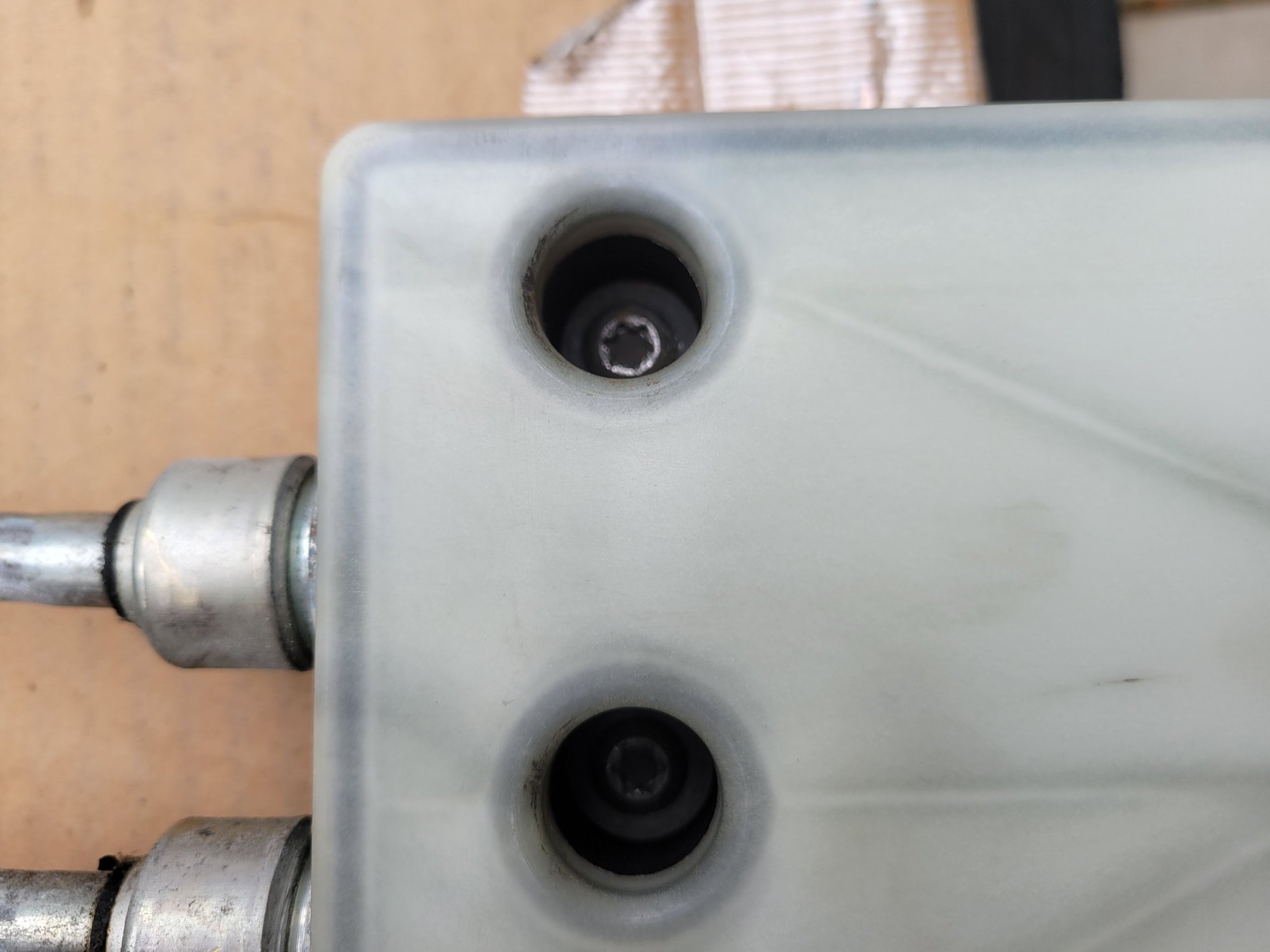

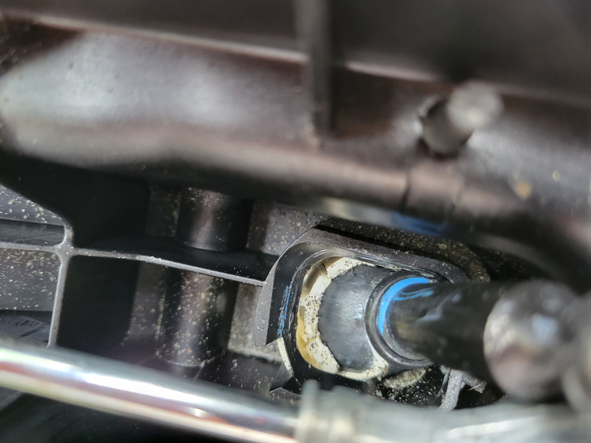

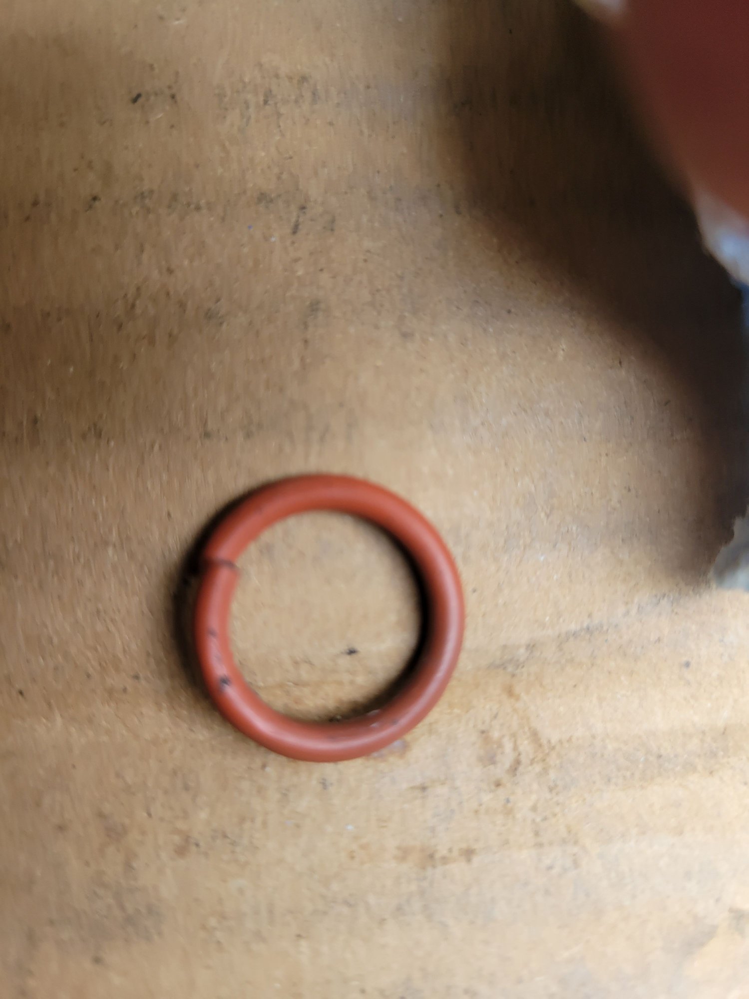

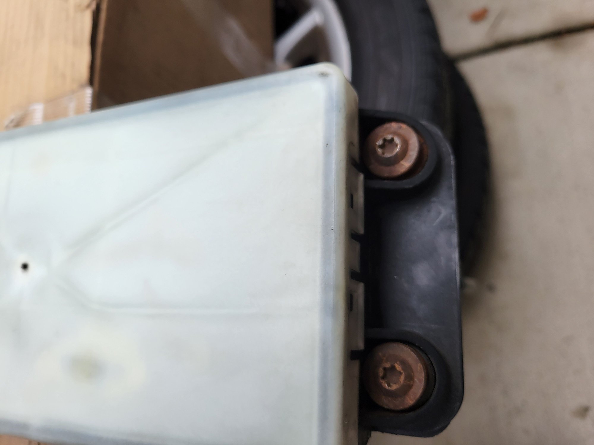

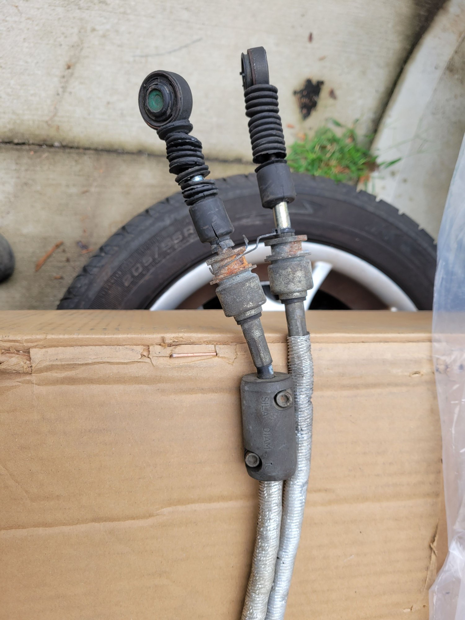

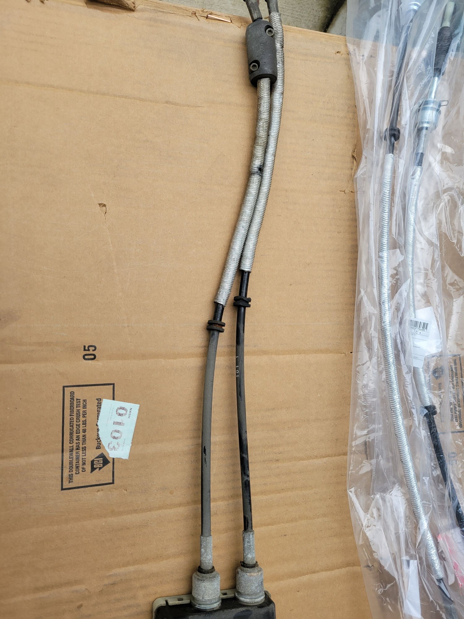

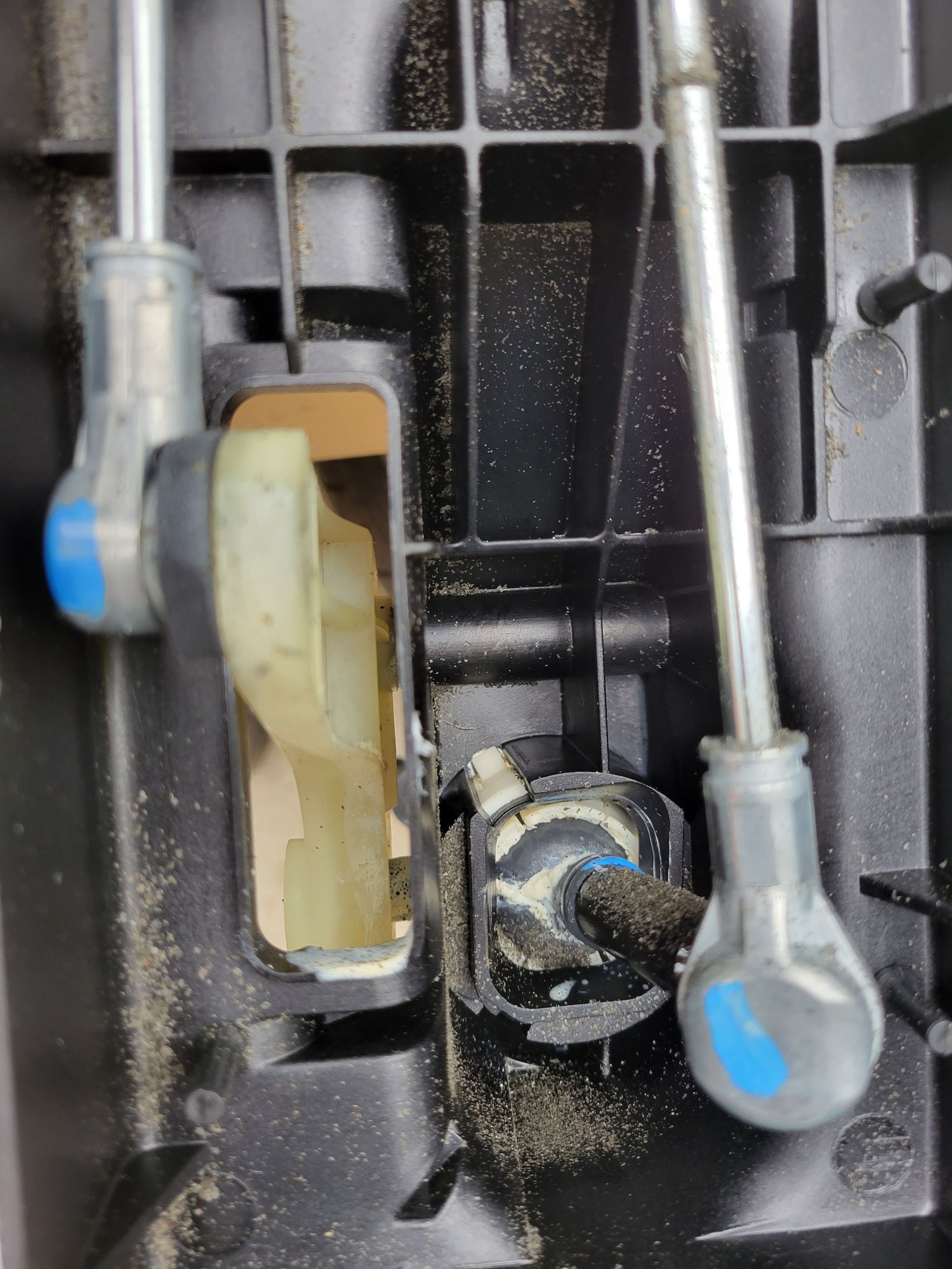

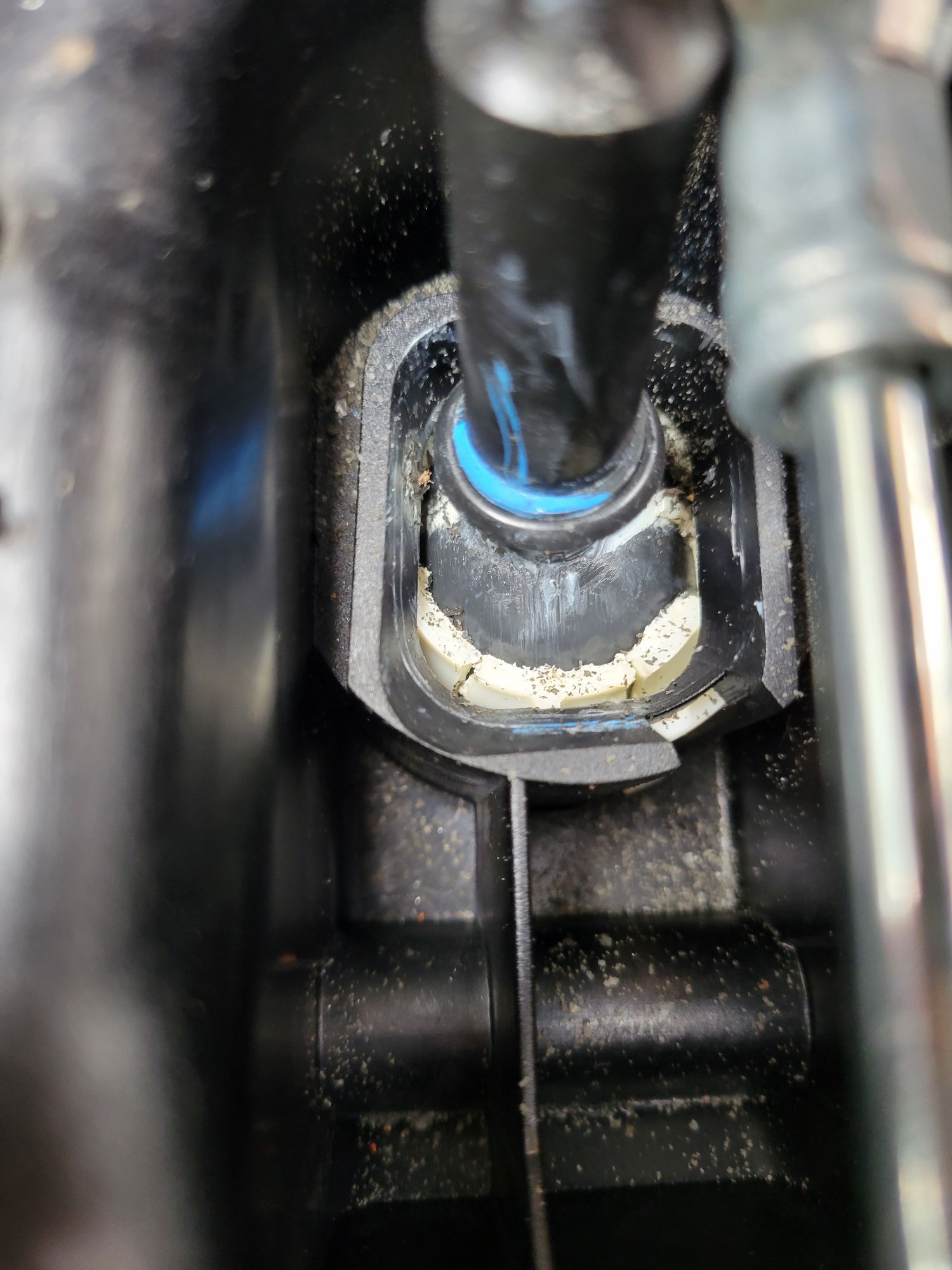

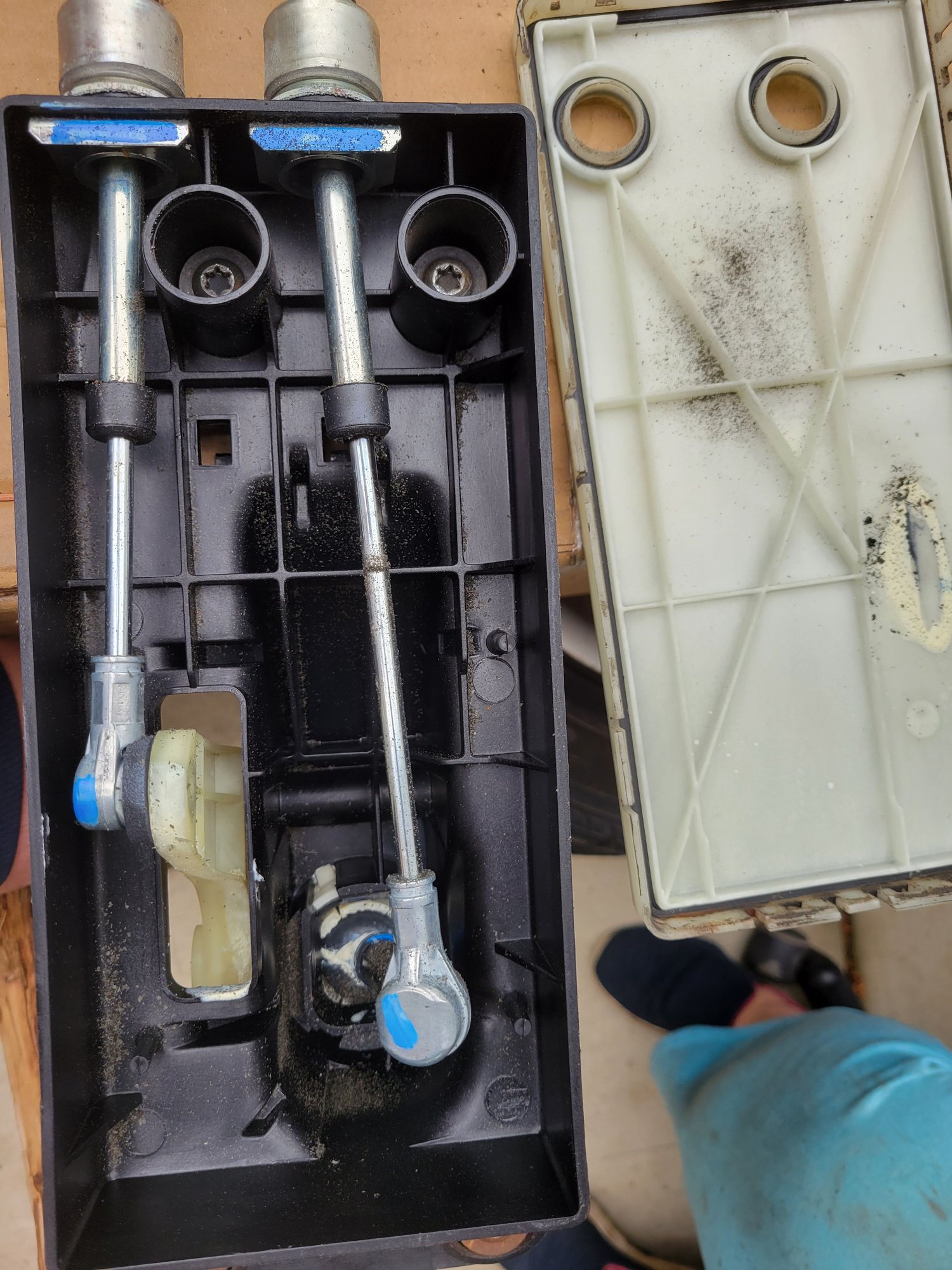

A little more progress today. First started with the shifter cables. Scored a deal online and it turned out to not be a deal as the cables do not fit so I have to deal with the hassle of the return and sourcing others. In the meantime, we pulled the shift box and have it all prepped for when the correct cables arrive.
Note: box has captured torx bolts TT40.
While inside the box, found a torn o-ring. Swapped it for a good one. Looks like it acts as a bumper for the shifter...
A few pics below.
