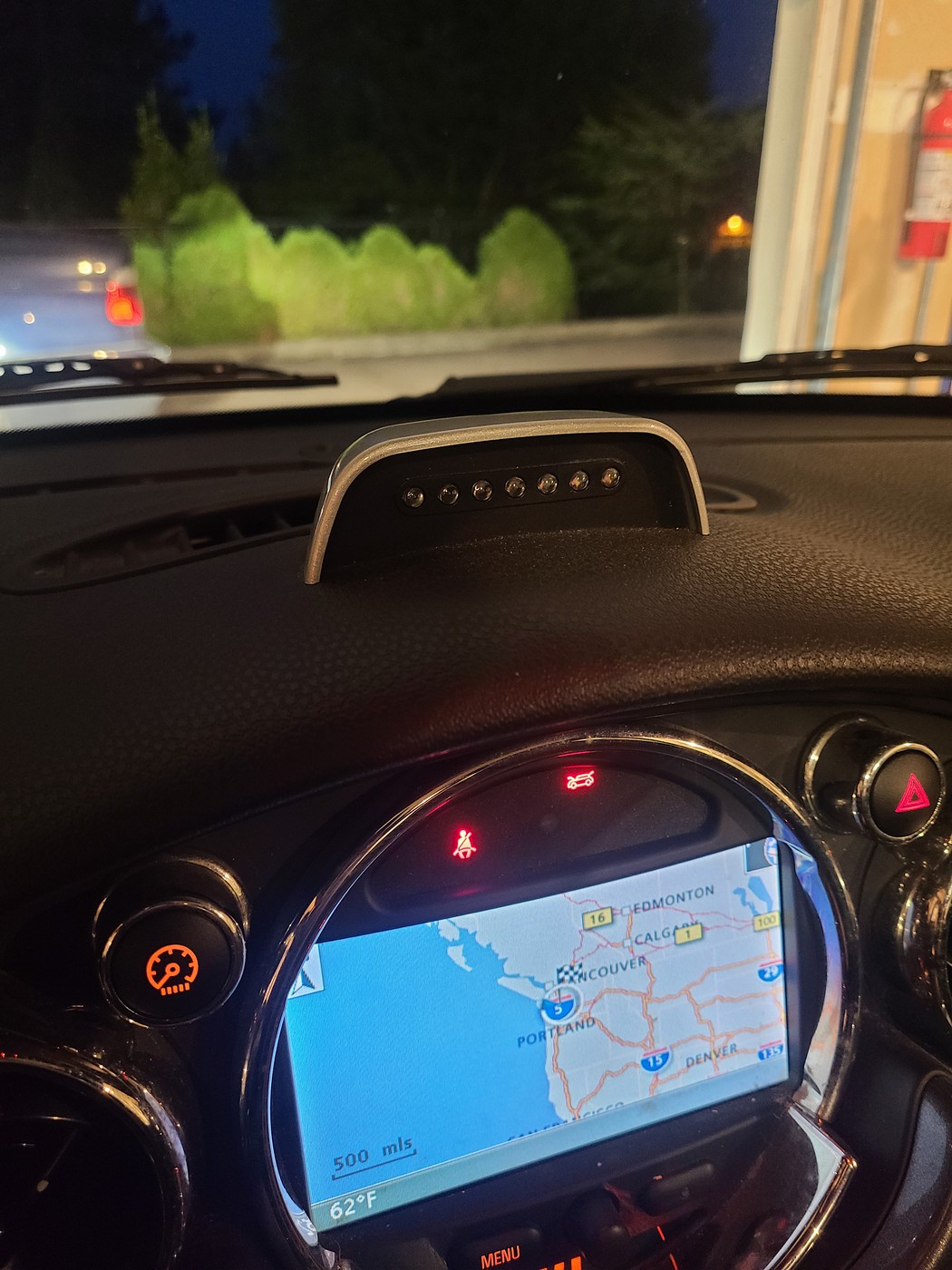

Yeah, the stupid question, I know. But I am befuddled. I've just fixed my 2006 R53, so it is drivable now (the whole story could be seen here, if interested: https://www.instagram.com/mini_bmw_mechanic/). It has 6 spd AISIN tranny, with shift paddles on the steering wheel, as well as it has
JCW Shift Indicator installed (https://media.fotki.com/2v2a6H74qxA1NP.jpg)
So, the manual shifting works if I use the shifter lever. But if I press on any of the paddles, it just shows me the current gear (like "M6") and in a couple of seconds switches back to "D". The JCW Shift indicator is also not displaying anything other than just a single green LED at the left.

For the JCW shift light, there are different RPM settings on the control box which are set by the dip switch positions. The first two should be the number of cylinders, and the remaining four are for the max RPM. For a Cooper S the recommended setting in the instructions is 1,2, and 5 up/on, 3,4,and 6 down. This should set the box at 4 cylinders, 6,750 max RPM.

So, yeah, JCW shift light works, I just have seen that a couple more LED were lit during my drive, but since the engine is newly rebuilt I am driving very conservatively at low RPM.
