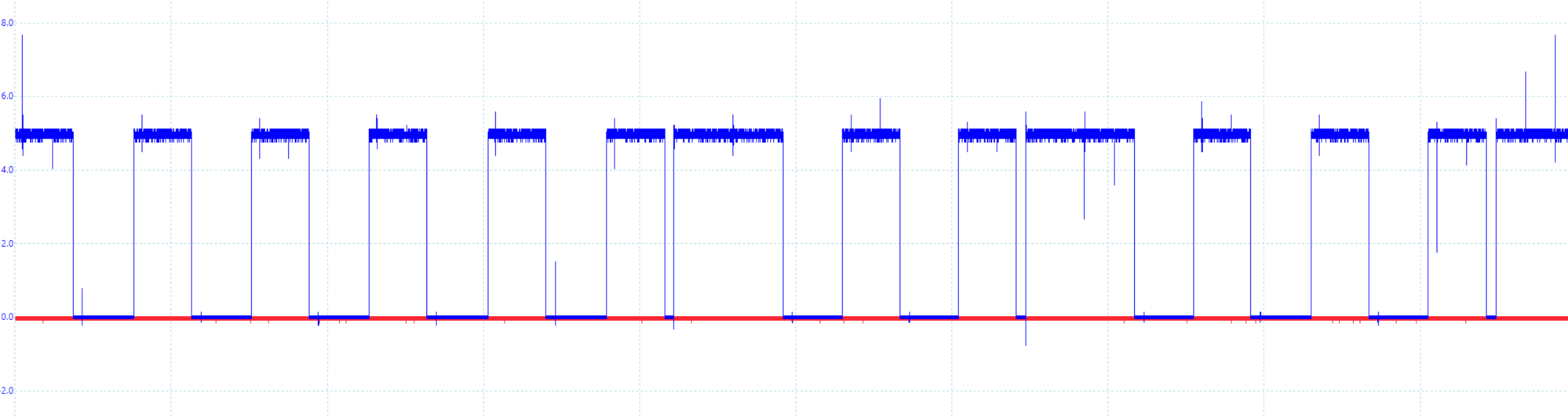

Scoped the output of the sensor, its not regular as it should be:

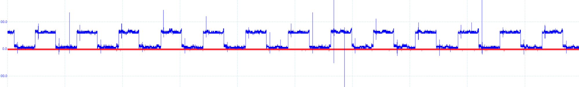

In comparison to a 10 minute period where it had no codes and was running ok:

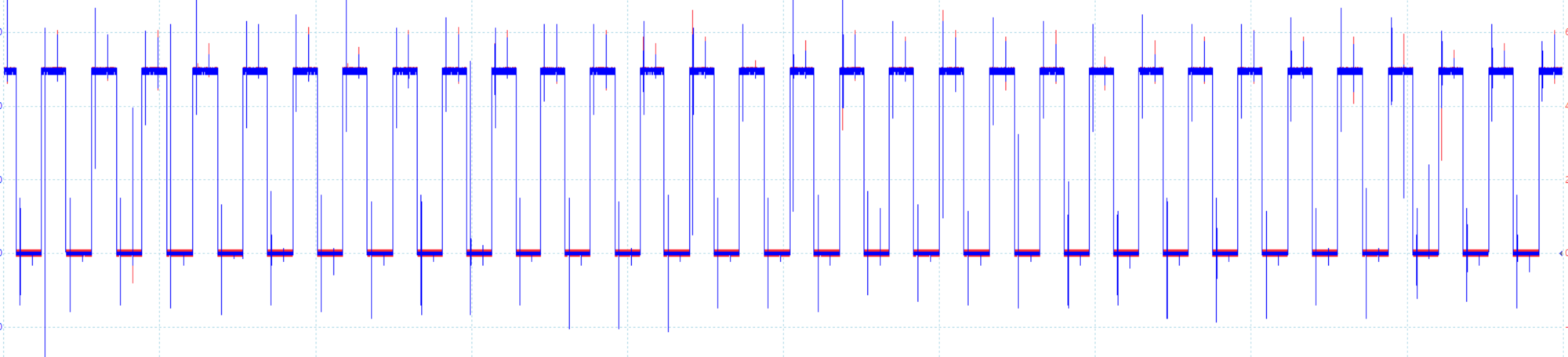

And then with the output of the cam sensor disconnected from the ECU:
Its much noiser as the voltage is much lower without the ECU's internal pull up/down resistor, but its consistent.
I fed the CAM sensor a 12v supply independent of the ECU and it did not change, so I am leaning towards a faulty engine ECU
