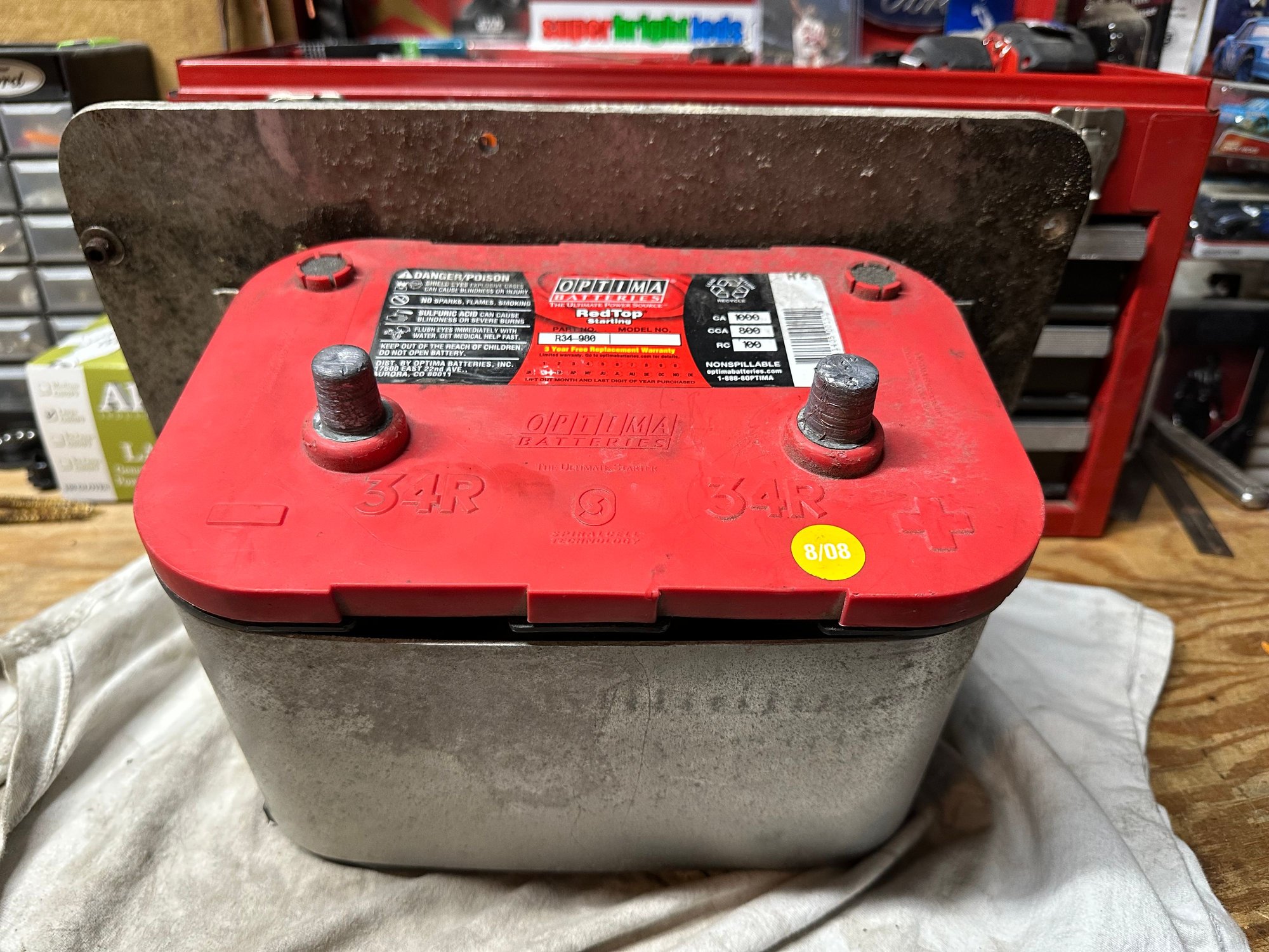

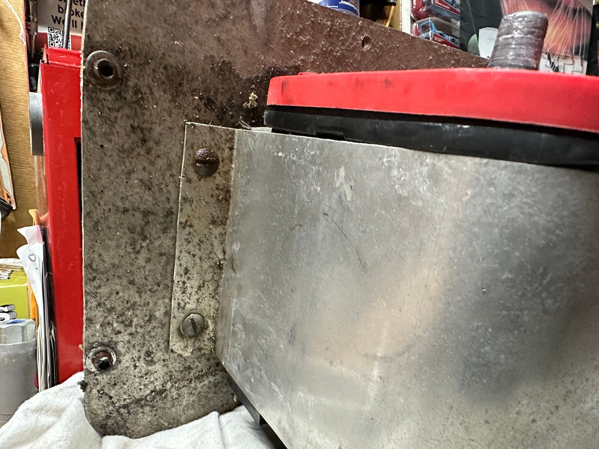

It was time to buy a battery…I got one today delivered to my work from O’Reilly that was $50 cheaper than AutoZone or Napa!
When I did this mod way back when I wasn’t thinking about the battery ever being serviced. We had to remove the whole plate that it sits on because I used steel flat head screws (for some reason) into aluminum plate…
And yea, they didn’t want to come out of course…I had to cut them off with a sawz-all.

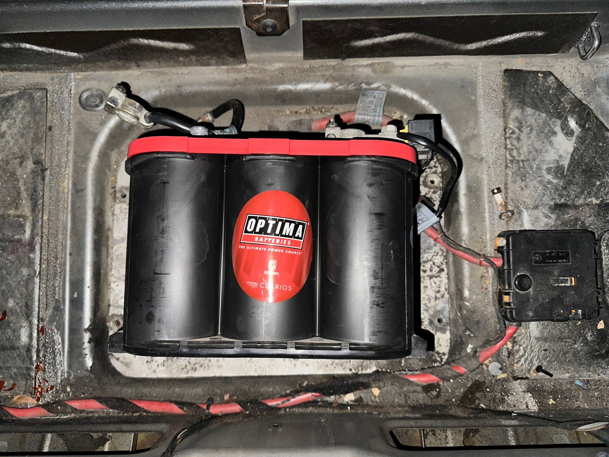

After all that, we finally laid the new battery in there and hooked it up…
…then this happened…

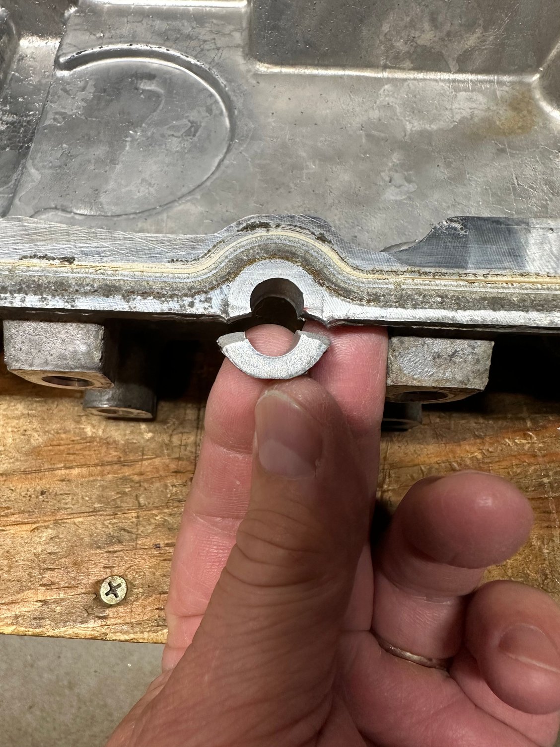

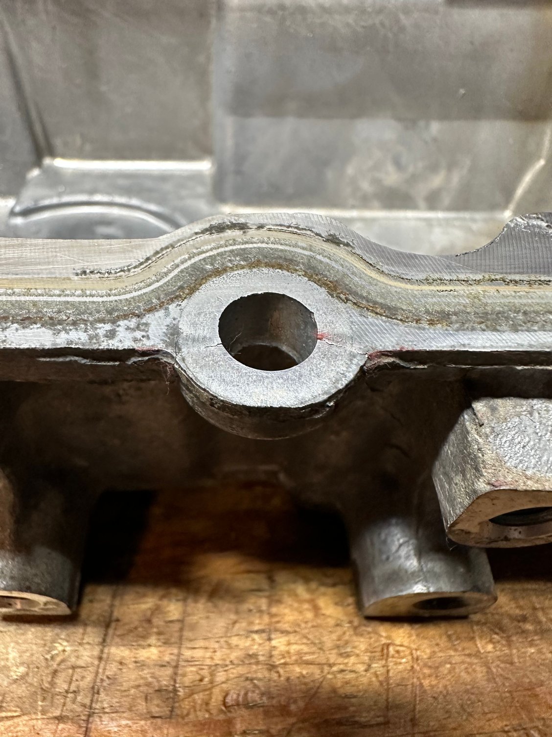

My son wanted to drop the oil pan to get the tip of the dipstick out…no problem. He asks me to take a look because he couldn’t get it off. I told him to unbolt the lower mount bracket that bolts to the oil pan first…after he did that he noticed that there was a bolt he didn’t see still holding the pan to the block…
So I brought the pan to work so I could clean it up in the gunk tank before bringing to Scott’s to be welded.

We got the pan back from Scott, he welded it up perfectly. I just hit that spot with a file a few times and it cleaned right up, then my kid cleaned up the whole mounting surface with some fine paper. I wasn’t able to take pics of the repair because my kid couldn’t wait to put it on…but it will be coming back off. I was at work when he put it on, he didn’t tighten or torque the bolts correctly in any kind of sequence.

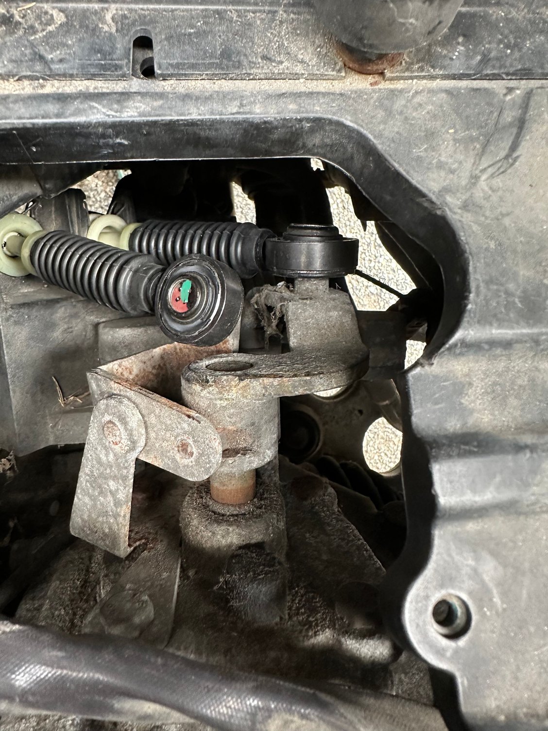

We had a little break in the weather today, long enough to change the shift cables…
…this is why we had to change them…

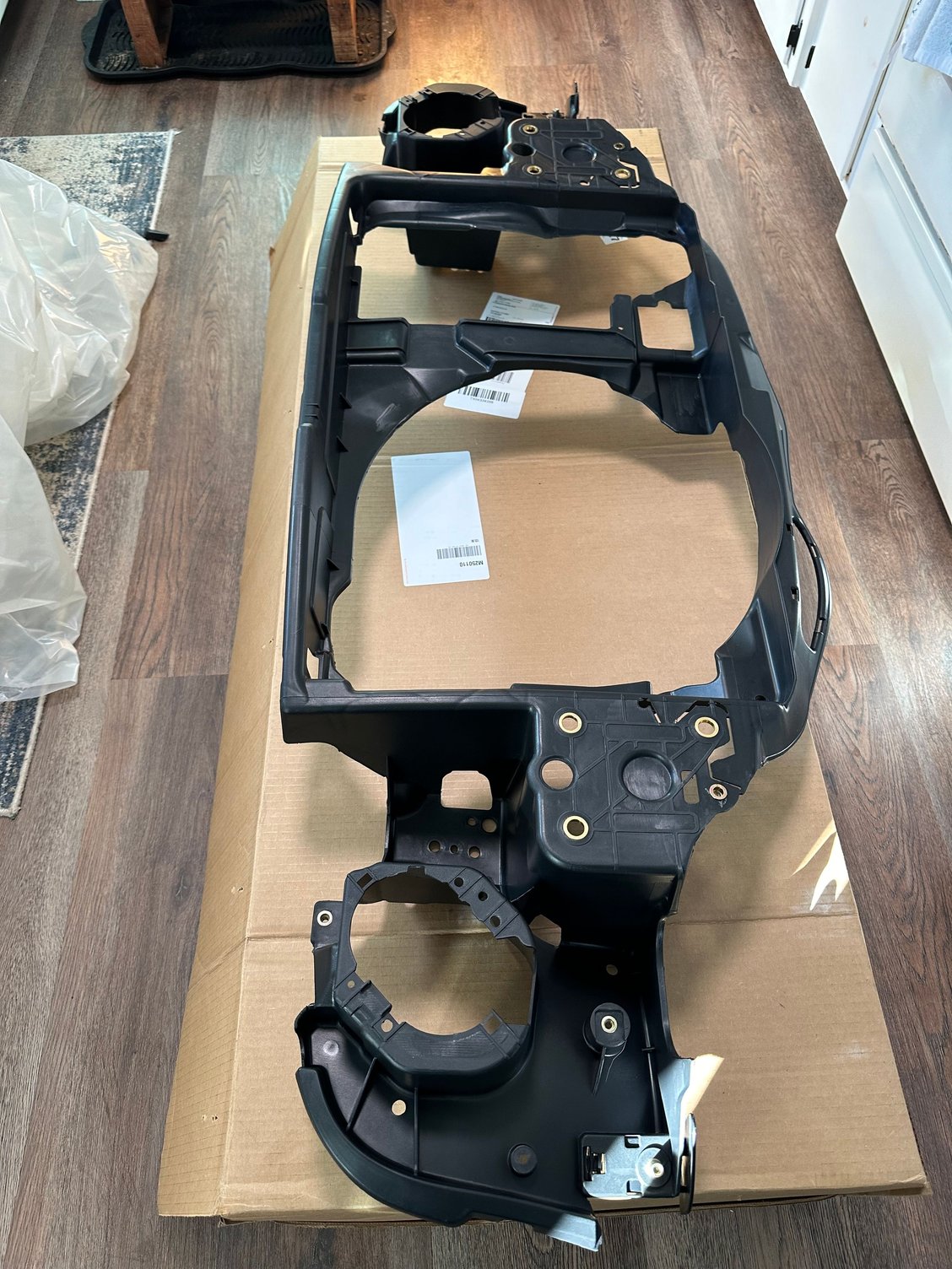

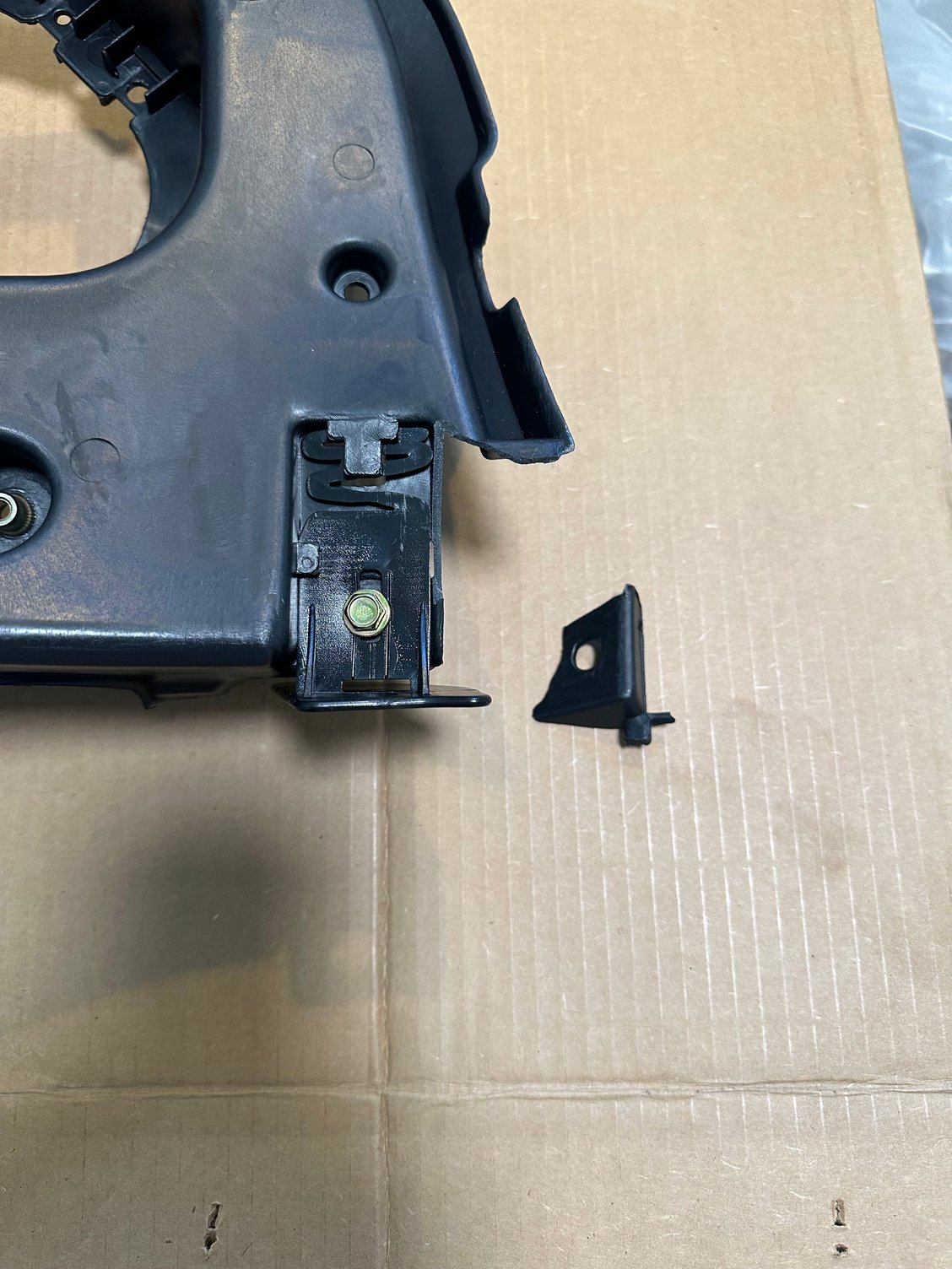

So we finally found a decently priced radiator support on eBay with free shipping…
…but of course it had to arrive damaged…
I think I’ll try LKQ for a used one or maybe an aftermarket one, they will deliver it to my work and I don’t have to worry about it being damaged from shipping.
I got a used bumper bar from them the other day…

Old Feb 19, 2024 | 11:01 AM
  #50
Posts: 36,758
Likes: 2,548
Yep, those core supports are fragile and can get knocked around.
