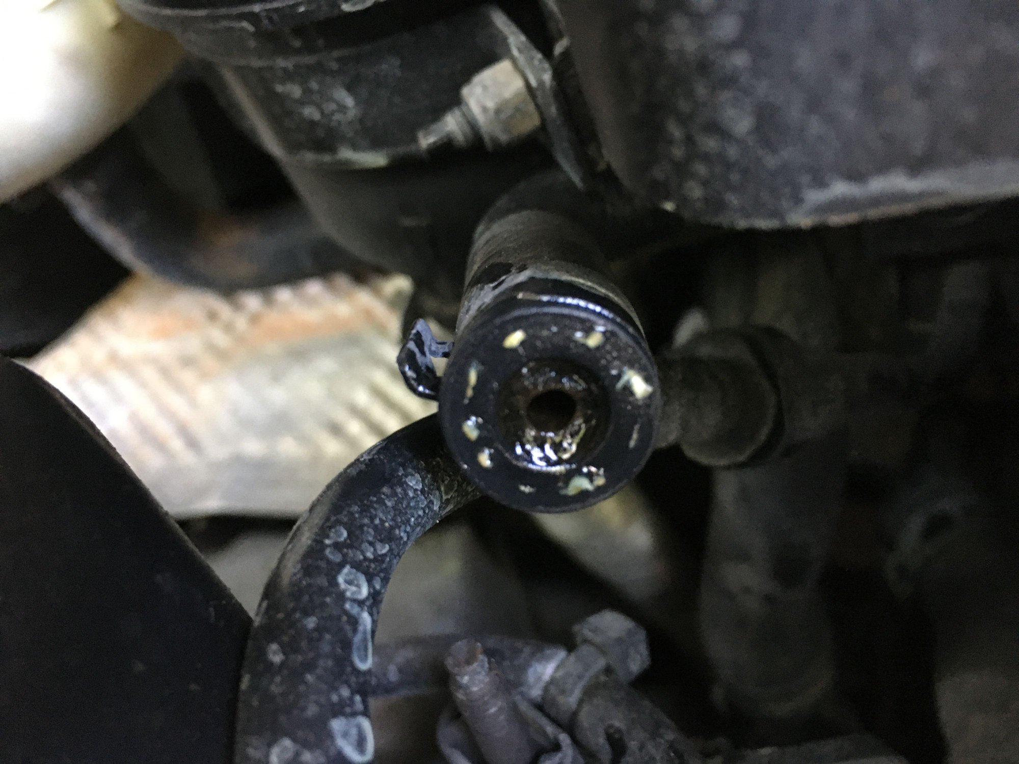

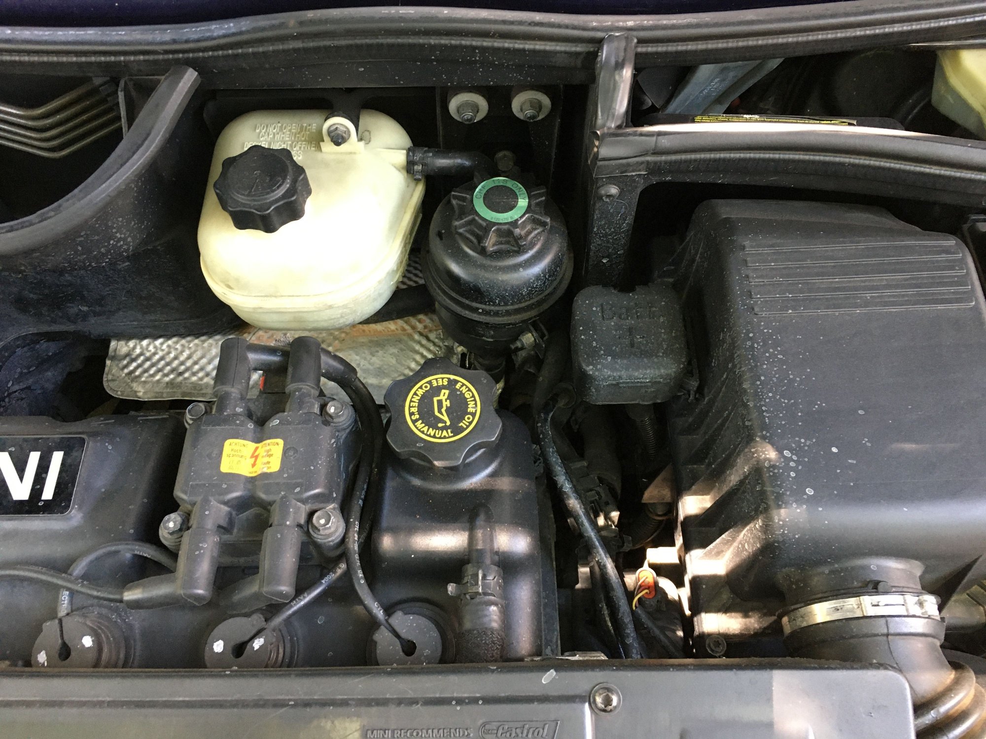

Hi forum, my 2005 MCS overheated yesterday. Caught it in time, parked it. This morning I found that the hose to the reservoir has snapped off right at the junction near the thermostat.
Would like to do a cooling system refresh. Including all hoses, thermostat and reservoir. Will probably keep the radiator, water pump, heater core, and fan in place for now.
Any good kits out there?
Any tips are much appreciated
(I will attach some pics of the broken hose)

No one familiar with this job?
I'm concerned that the hoses going to the heater core will be hard to replace? Am I overthinking this?

Got the new hoses in this weekend. All but the ones to the oil cooler. Going to save those for another weekend. They look like they could be a pain to reach.
the hoses at the firewall were harder to reach then I thought they would be.
it helps to move the power steering reservoir out of the way. Also bending the heat shielding out of the way helped. I was able to get one of the clamps off from underneath the car.
