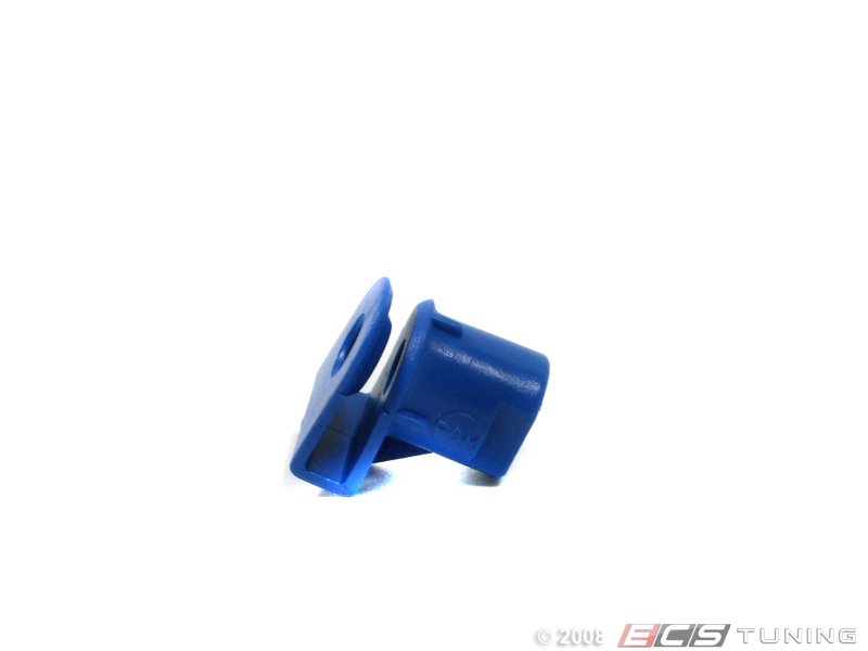

but the real purpose of this post was to b!tch about these annoying blue clips. Im sure you are all aware of them. Well, 2 are broken and make removing a few items quite a headache. I havent been able to find a part number on realoem, but did find them on outmotoring for $7 a pop.... anyone know a place where they are a bit more reasonable?
https://www.outmotoring.com/Genuine-MINI-Cooper-07131472727-interior-clip-blue-plastic-snap.html

ECS Tuning is a little under $5, but free shipping doesn’t start until $49.

+1 Yep, i cracked those on my R52 doing the down tube and stereo upgrade. Get some more clips you need or hardware to $49 and get free shipping.
https://www.ecstuning.com/Search/Sit...h/07131472727/

Thanks for the link. Ill definitely be buying some spares as I can only imagine how many more will break as I keep making the updates that I want. I need a few more things so Im sure it will get into free shipping territory.

I also wanted to comment on the blue things I bought from ECS Tuning. A bit disappointed to be honest, them being NON-OEM parts I didnt quite like the fitment, however they did their job. Cant complain too much about them and I still have one spare from the order.... I also discovered that I ordered the wrong Oil filter socket... 32mm wasnt the right one . facepalm. fail. etc... I still havent bought the right one yet, but not sure I want to wait so long and since I will have to pay for shipping I will probably just buy it from Pelican since its a short drive away. I also replaced the cabin filter and the old one was..... MISSING... hope this isnt indicative of the DAPO things I will keep running into.
