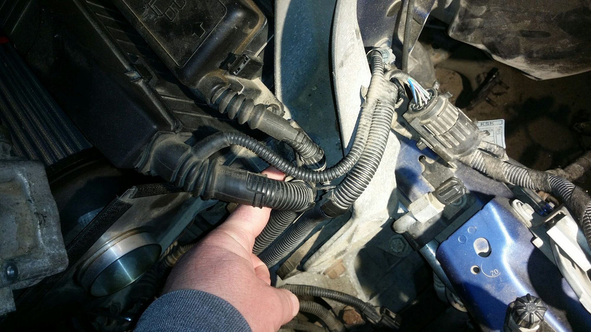

Was putting the r53 2005 mcs in front end service mode and this fell out on to the ground (see pic).
Fell out just left of the radiator on the drivers side. When I put it back together I could not find a place for it.

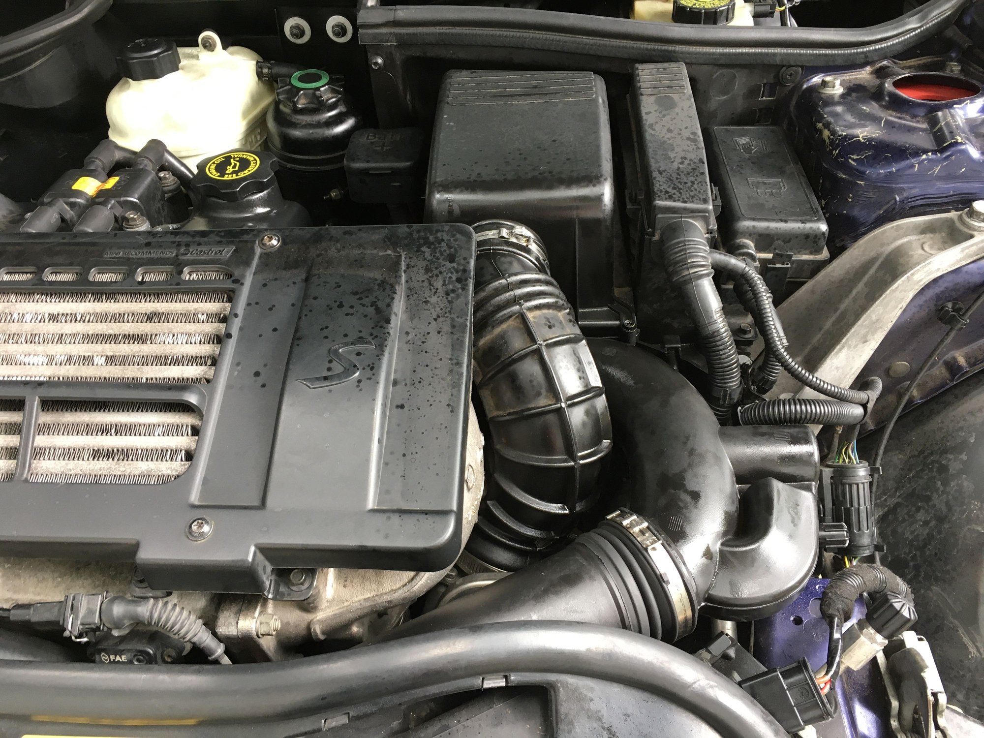

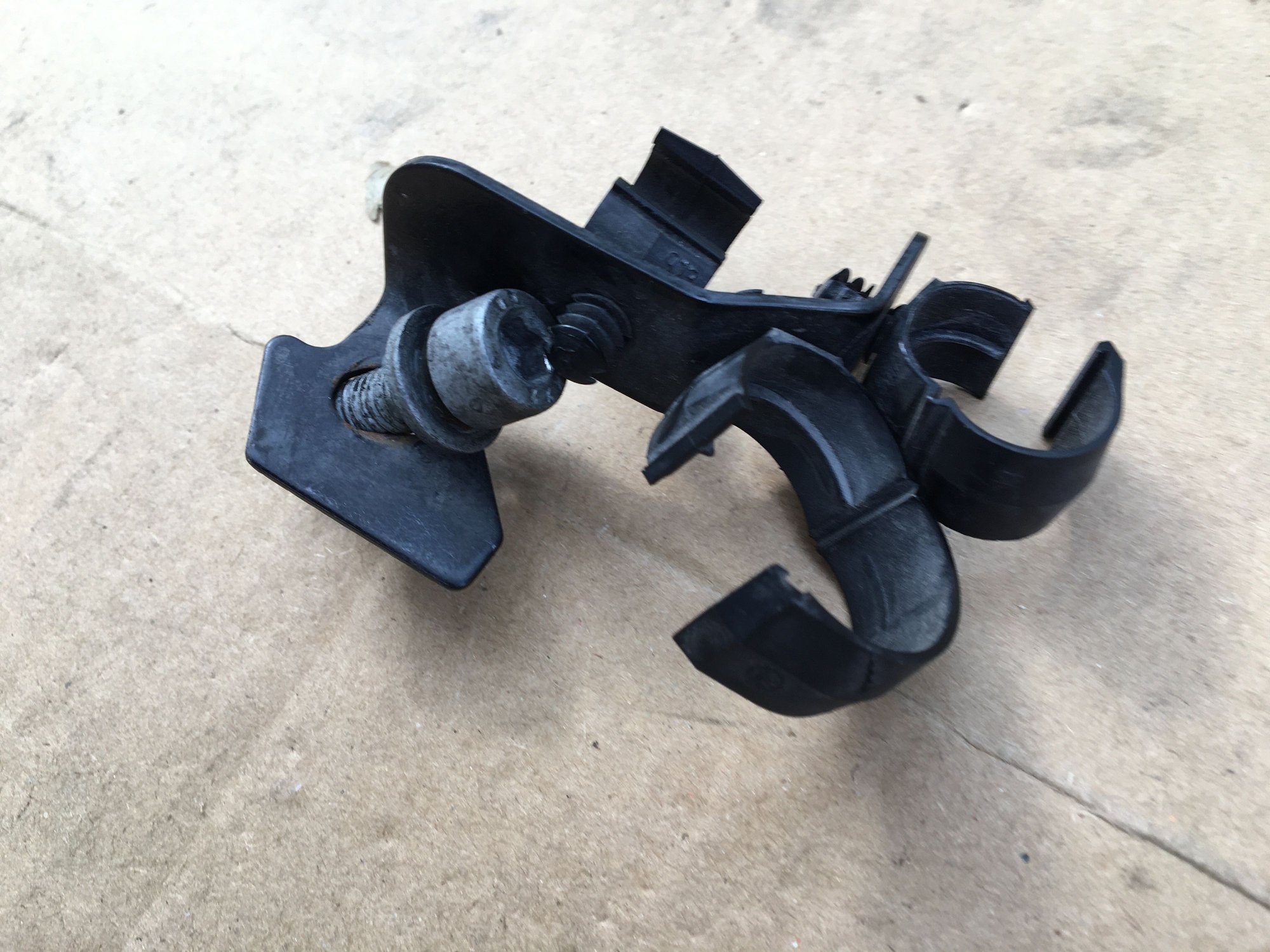

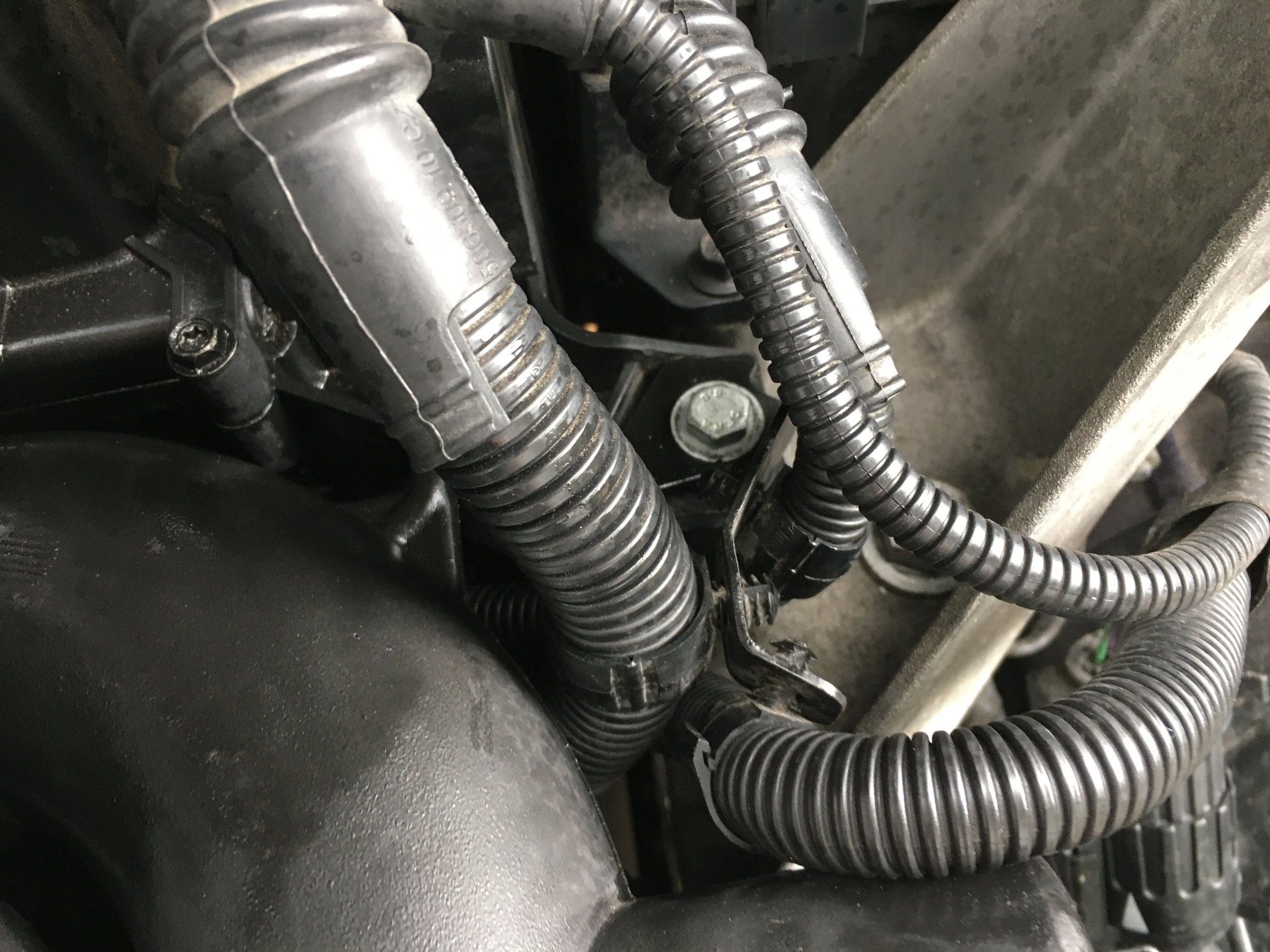

Here you go. ['05 S, hatch]
The attaching screw is the one on the left. Screws into a lug on the upper transmission mount bracket.
A wider view.
Again, the bolt on the left.

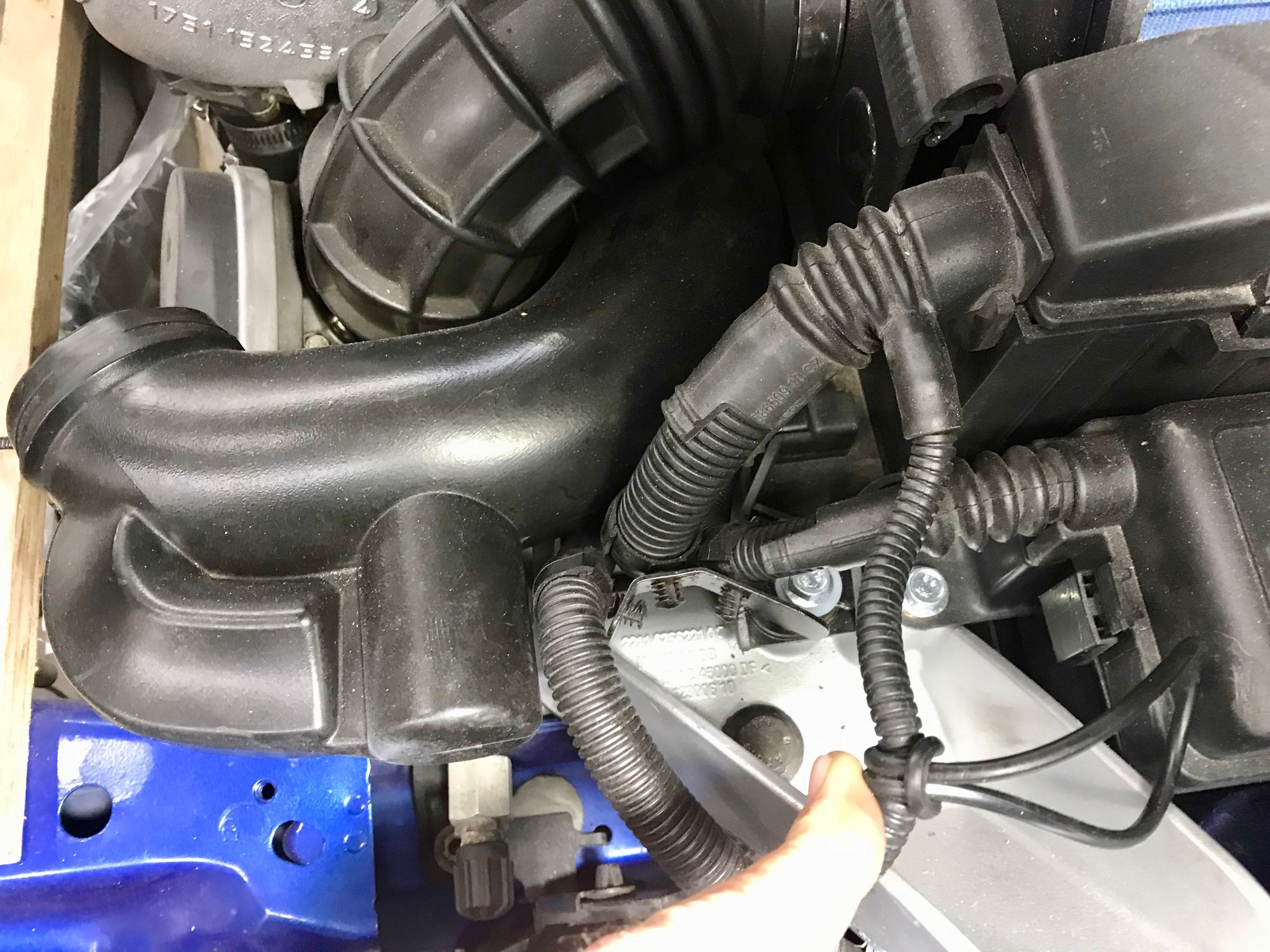

Yep, it's a tough place to get a picture of. Here is is on mine.
