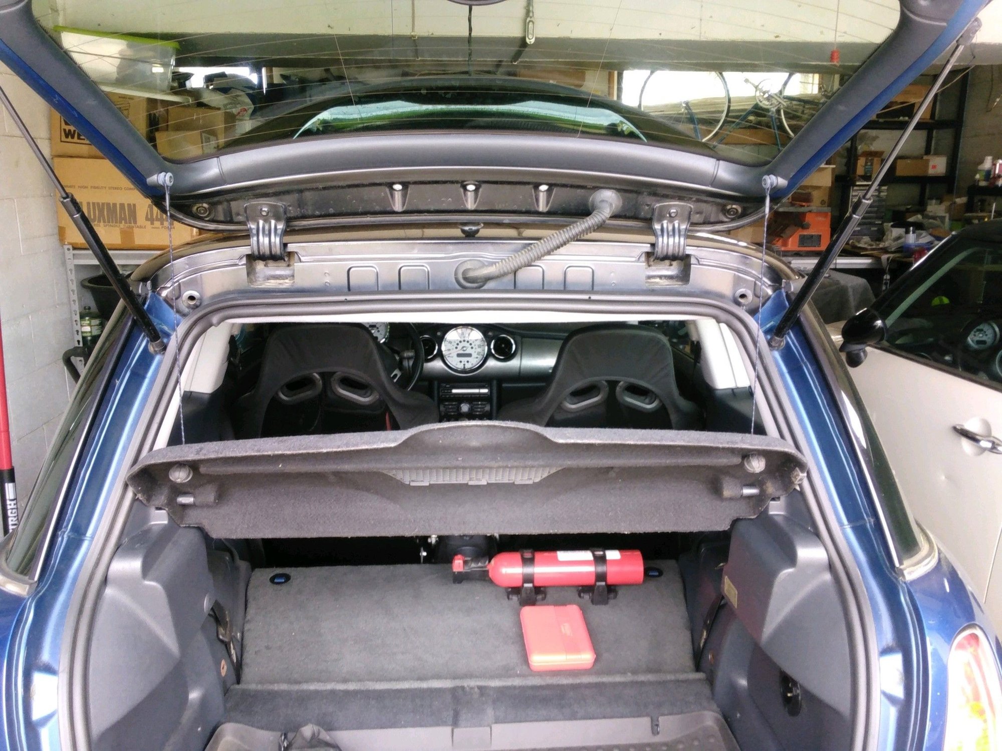

Got my used right rear lateral trim panel from an 06 today. Not bad. Certainly better than my beaten up one - mountain bike pedal marks and all sort of gouges in my old one. This one is probably 90-95% perfect. It has a couple small scratches in it, but overall I am happy with this panel completing my interior renew. Just a couple of small things now - need a pristine right rear hatch cover, need to source the stickers, need a couple of specialized clips, need to figure out a cover for the seat pivot holes (I think I have a solution for that - stay tuned on that one.
Old one at the top. It's beat up a lot more than it looks from this pic, but look at the back lower part.
Old one - all scratched up.
New (used) one. Some scuffs, but not bad at all!
Just a couple finishing touches on the interior - need to restring the rear 'parcel shelf' cords - they are freyed. Need to fabricate seat pivot covers - these are going to be pretty slick, I think and will completely blend with the interior. And new carpet mats. I like the rubber ones - they have done a great job protecting the carpets, but I am so sick of them looking dirty the second I step on them after I clean them. They literally cannot be kept looking good. I've been looking at some of the mats on cocmats.com after @dmath and @MCS4FUN started looking into them. I am not a fan of the coco mats - they look too thick and too many stray fibers for me, but their sisal mats - now those look pretty good (the check ones look pretty neat too). I was leaning toward the slate color, but may be just a touch too light. I will probably order a swatch of both the black and slate in the sisal to get a better idea of which will work with the interior better.
SLATE in sisal.
BLACK in sisal.

WRT those mats, agreed sisal presents a more refined look than do coco. Also noteworthy that solid color sisal are same $200 + shipping vs more spendy versions at $250 + shipping, which IMO stretches budget practicality. Also agreed its best to order color swatches since pigment hue variations often don't play well with existing interiors such as blues and reds. At this point, I'm just watching and pondering after WMW's email notification that they'll no longer carry that brand. Not really surprised, since cocomats.com's website doesn't include list of authorized dealers which suggests to me, they prefer selling directly to end user customers. In any case, I do like the sisal slate...

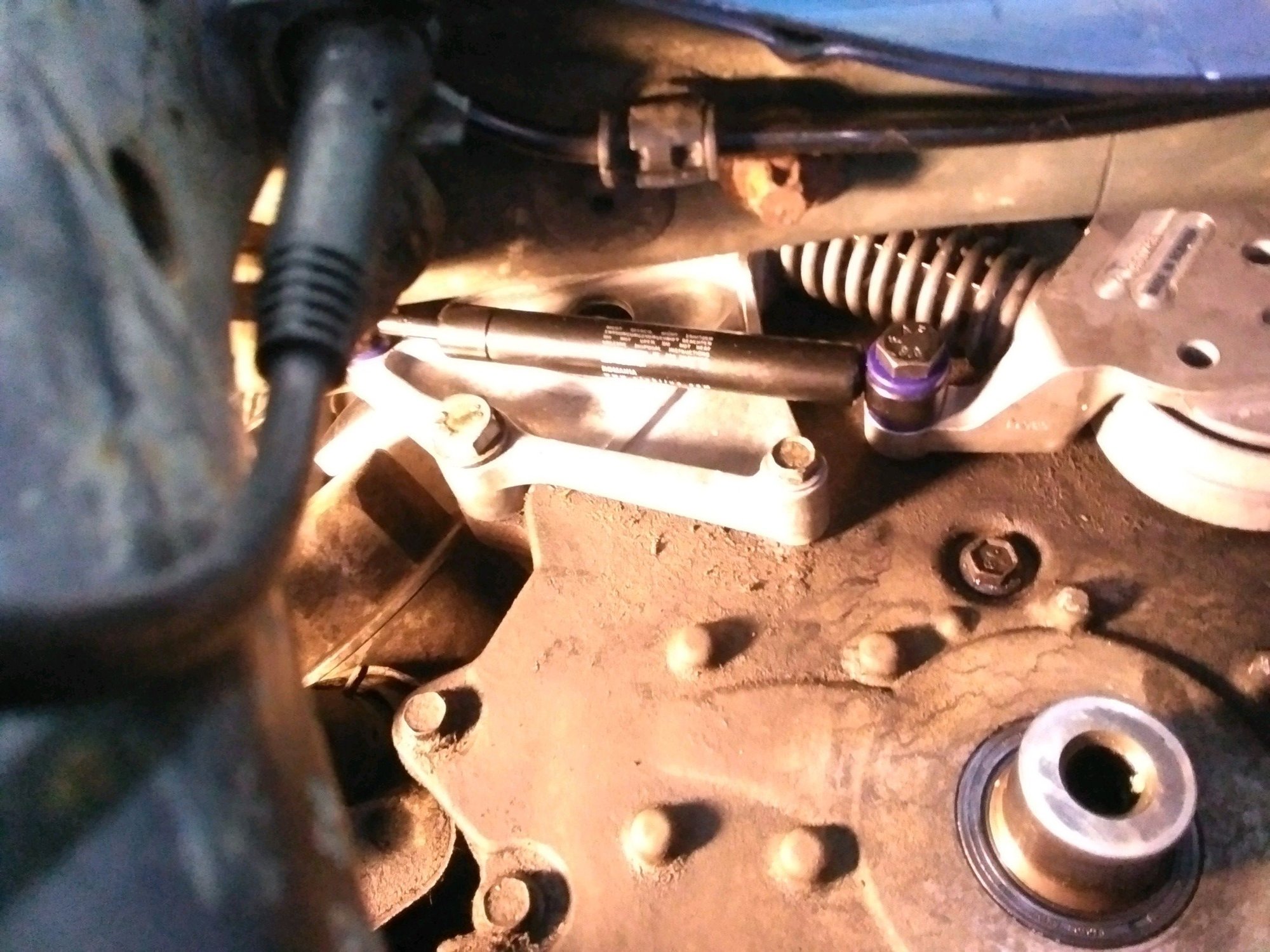

Today I replaced some parts - none of which needed replacement it turns out. I did the harmonic balancer, the belt tensioner and the front main seal. I also put poly bushings on the tensioner before installing it. I did not jack up the engine - there is enough space to replace the tensioner once the balancer has been removed, so that is the way I did it. Took a couple of hours, but I had to go out for tools a couple of times, so probably a bit less than that.
No oil around the old front main seal, but it got replaced just so I know it won't need to be done anytime soon.
Pulley was a bit tough getting on. I think the threads in the crank end had quite a bit of old thread locker in them or something. Had to use a couple of extra washers to get the new one to seat with the long bolt, then it got a bit easier. Put the new bolt on and tightened it down and that did it. I have to give it the final torque up tomorrow - didn't have anyone to step on the brake. Tightened up with the impact gun for now.
None of the parts were bad. Tensioner was fine, the crank pulley looked brand new - and I never had that replaced (as far as I know). But, I suppose having the insurance of knowing that it won't fail down the road is nice. Took it for a short drive when I get the wheel back on, and it does seem a bit smoother.
Anyhow, that's my preventative maintenance done. I think mats will be the next item for the interior. I did order samples of both the black and the slate blue sisal material from cocomats - will post up some photos of those in my interior when they get here. Will probably do the 4 pot brake upgrade on the front later this summer or this fall and then over the winter, the plan is to drop the front subframe and refresh that. Hopefully some paint this summer too!

For torquing the crank pulley bolt, I put a long pry bar (with square cross section) between a couple of the 12 pt bolts on the ATI pulley and then put the rearward end under a subframe member. I continue to hold it in place with one hand while using the torque wrench with the other. Works well and keeps me from bugging my wife.

Nope, for this work just remove the passenger wheel and wheel liner. The pulley is a straight shot as it's right in front of you. Have to remove the pulley first then you have enough access to do the tensioner. It's tight, for sure, but once I had the old tensioner out, the new one was back in and torqued down within 10 minutes.
