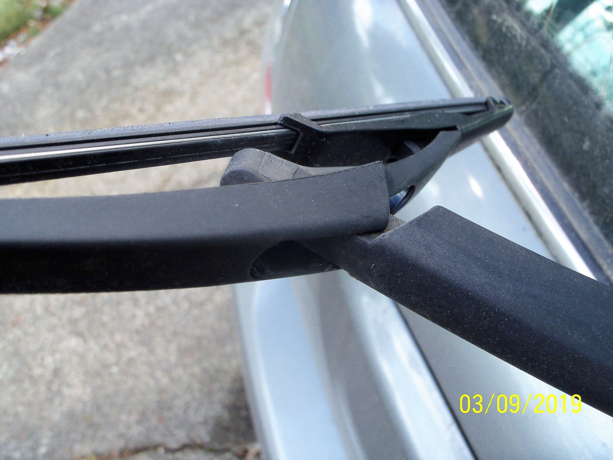

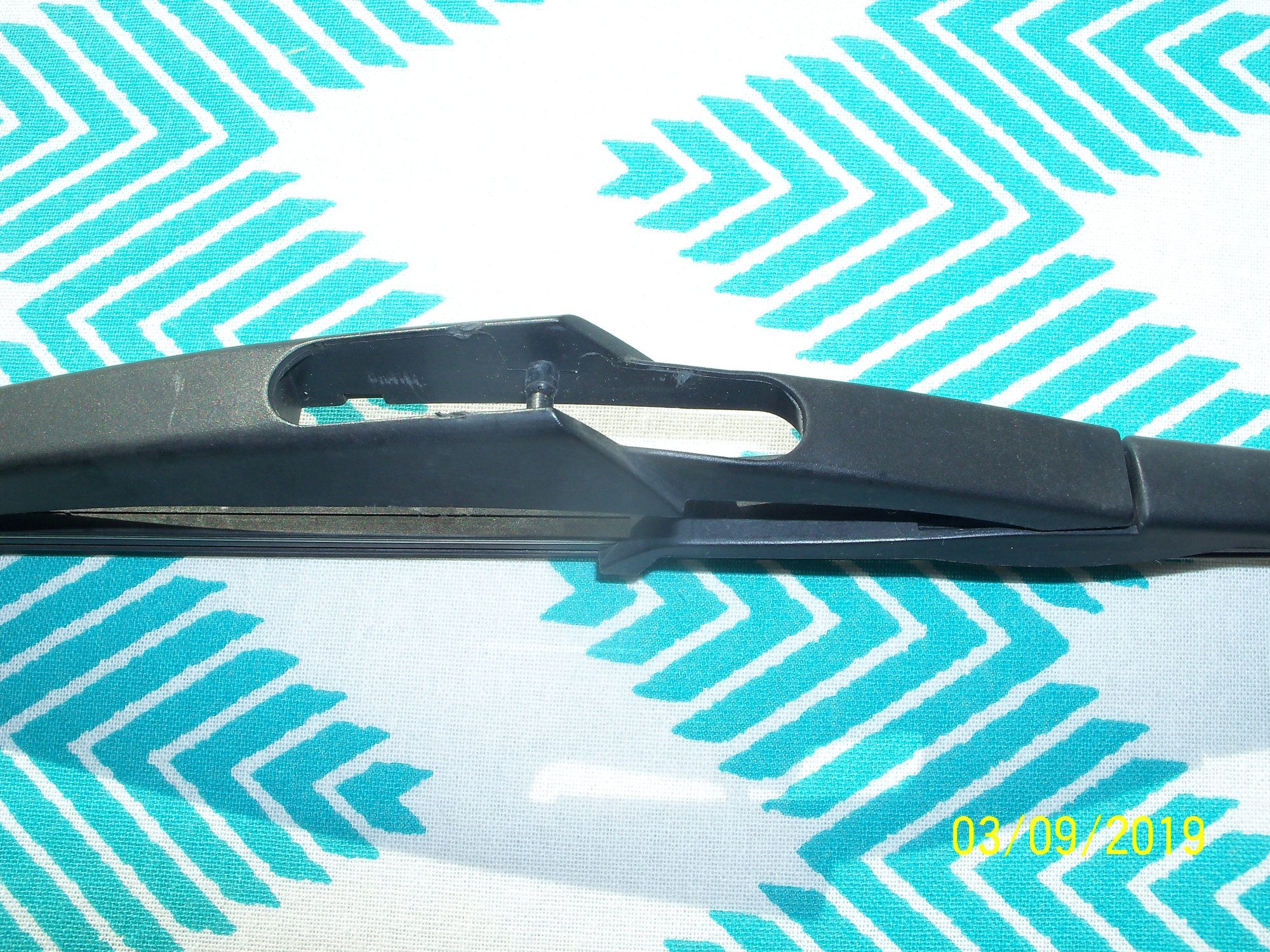

Now before you all jump all over me for starting another rear wiper thread, trust me when I say that I did a search and read every thread that came up for the rear wiper and my 3 working brain cells are now more confused than before......so, here we go again (with maybe a few twists involved this time)
my 2004 R53 was one of the first ones off the line, production date is 10-7-2003. My source of wiper blades has gone MIA and I need to find another outlet for replacements. I just put my last blade on the car yesterday that I had in the garage. They only seem to last about a year seeing as the car sits outside year 'round
I looked all over various vendors, but can't seem to come up with something that matches what I have on the car now. The car is original as far as I know, but I'm wondering if maybe the rear arm & blade are not "correct" for the car. (wrong arm, wrong blade, or both??)
My plastic blade measures 10-3/4" long, and the rubber blade insert is 10-1/4" long......everything I am finding is over 11" long from all the vendors....as you can see in the pictures, I don't think I can use an 11"+ blade on the car....it would hit the upper window seal at the top of the glass......
So, am I missing something obvious here, or am I on the hunt again for a blade under 11" for my car again? I don't want to do the wiper delete on the car, we really need the rear wiper up here in NW Washington
Any insight would be helpful here.....thanks

I found that if you take the blade insert out of the arm it is pretty generic other than the length
took in into the parts store and found a refill that was a match except for length
a lil work with some cutting tools and POOF I had an insert that slid in just fine ..... get a long enuf replacement and you can make TWO from one!
I was able to pull the metal stiffeners out of the old and new ... simply cut the new rubber and then put the old stiffener in the new rubber ..... after the first time 3 minute job.

I have a May '02 with the same rear wiper.
I doubt that you have anything odd.
The fitting for the blade onto the arm is unique to MINI, I think, so other blades won't fit.
Rubber refills alone are hard to find now - try Wal*Mart - but as Captain BJ said, just get a generic 22" blade, slide the rubber bit out & cut it in half.
Then a few minutes fiddling on the kitchen table to swap the parts over.

I just measured the rear wiper on my '02 R53.
The rubber insert is 11 3/4" long
The plastic blade itself is 12 1/4" long.
The wiper arm is 9 1/8" from the washer jet to the tip.
There's about 3/4" clear above the sweep of the arm at the top.
So it looks as though I have the NMA3019 but I'd say either one will fit.
Note the slight difference in angles between the two.
