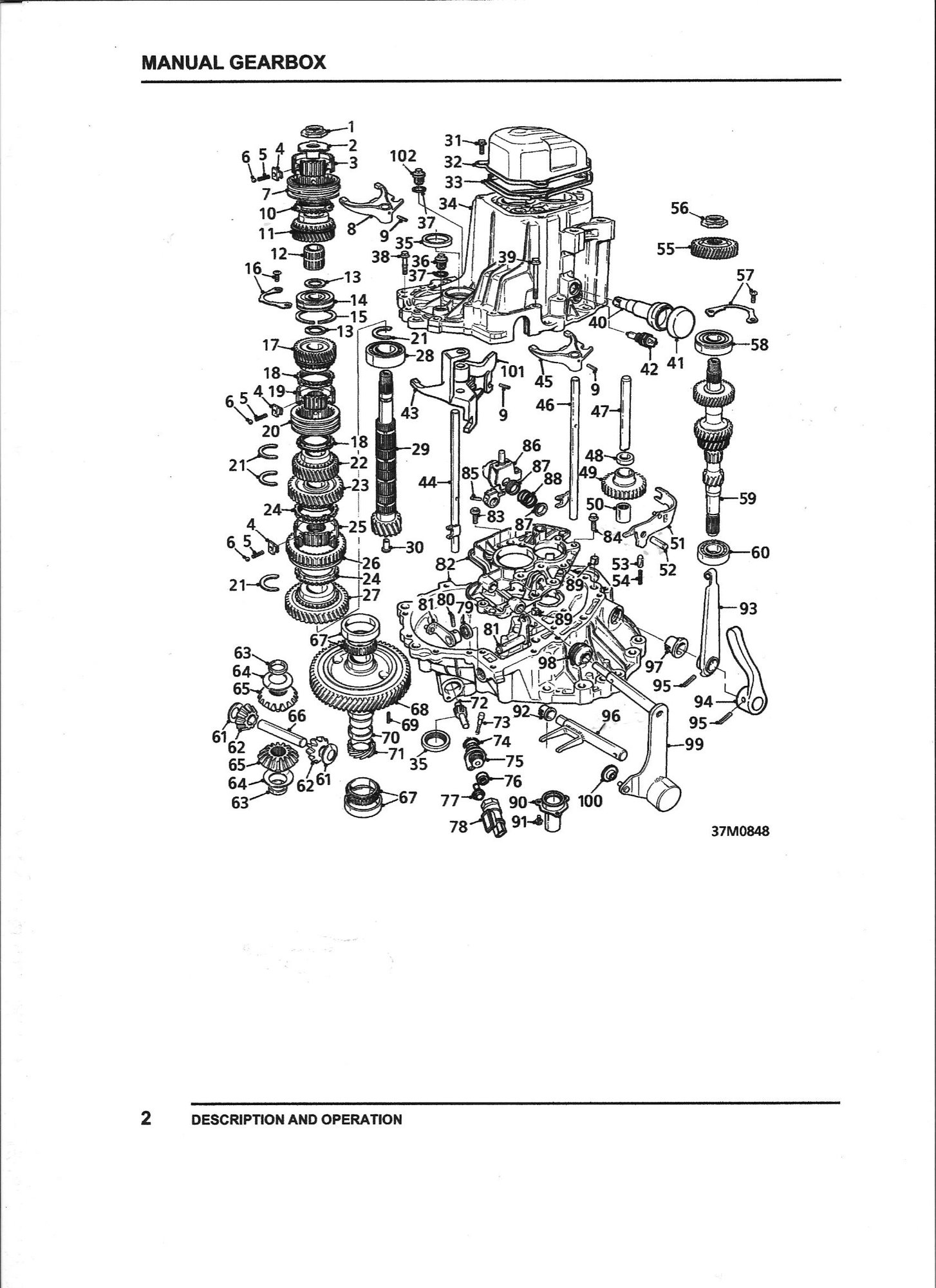

Here's the overhaul manual for the Midlands 5 speed, made by Rover.
https://www.minimania.com/pdfile/R65_Gearbox.pdf
There are 1st/2nd synchro, 3rd/4th synchro, and 5th gear synchro assemblies,
but no reverse synchro listed.
It does put a reverse idler gear into play to select reverse and may use the
1st gear as the reverse gear in combination with that, so this may give it
synchro function in reverse, if I understand correctly.
Maybe someone with more experience than I have can interpret it more accurately.
In any case it doesn't sound like a synchro problem anyway.

gearbox opened
Old Feb 22, 2019 | 01:27 PM
minimauro's Avatar
minimauro
Joined: Feb 2019
Posts: 10
parts
seems to be a problem on 49 (no tooth)
24 24 25 26 2nd gear? scastched teeth ?
how its possible? damn i need the parts

Good job!
Reverse idler gear. Cannot help but to wonder had it have synchromesh that would probably not happen.
I had remarked the Midland box has gears made of cheese but the owner didn't find it amusing.
I am just joking.
