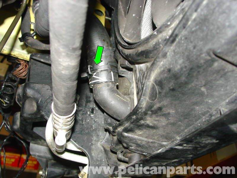

Old Aug 13, 2018 | 02:23 PM
  #29
Tyler767's Avatar
Tyler767
Joined: Mar 2016
Posts: 24
From: Kentucky
Originally Posted by AoxoMoxoA
So if you hire a contractor to repair the chimney on your house, and the contractor, while putting up or taking down the ladder rips a 30-foot section of gutter off the fascia your house, and claims no responsibility, stating "These things happen while moving the ladders around..."
You would be OK with that?
Or would you expect the contractor to make good on repairing the damages to your house?
Originally Posted by pnwR53S
Just because it is 12 year old does not mean it is at the end of the service life. My radiator show no sign of age. The proof is to see how this radiator fail if OP were to request it. I bet is is just stress failure at where the plastic and AL core interface. I will further bet that the plastic is harder than you think to try to destroy it by say a hammer. In any event an experience home mechanic know what to look for and perform postmortem can easily tell what caused it to leak.
The arrow is the section that failed according to the shop. They explained the bottom screw was “stripped out” and no longer holding at that point causing the failure. I’m not sure if this is correct but I’m assuming when they jacked the engine up they did not remove the hose/clamp on that area causing pressure on the plastic area and the screw - causing the leak and the inability to tighten the screw back in to place. Someone please correct me if I’m totally off on this.
EDIT:
I wanted to post the picture so you could get a clear understanding of what the shop explained was the issue. The coolant system as a whole has performed great until the shop caused the issue(they admitted it). During my almost 3 years of owning the R53 I've had 0 issues with the coolant leaking other than replacing the Coolant Reservoir(very common failure point). The Radiator itself before all of this would have kept going for awhile longer. It seemed to be in pretty decent shape for what my opinion is worth.
All and all even though it was more money, I'm happy that to have a brand new Radiator in my Mini with all the other upgrades. I plan on doing more very soon and I want to post a build thread sometime soon. I have big plans for my little car - I'll have some pictures uploaded very soon!
I was hoping that you will ask to retain the failed radiator so you can take good photos for us to discuss. Without it we will all just be speculating - a worthless dead horse beating exercise. If I were you I would not just take their words for what happened. That stripped out screw claim is extremely suspicious. I doubt you can find on the web there is an identical failure if you know how to search for it.
Like I have written, I wager that the plastic is likely still extremely strong, as you can try to destroy it with a hammer and find out assuming you get the failed radiator back.
Just a thought and speculation. I wonder if some genius mechanic decided to undo the hose collar there at the two fasteners. If so it is definitely the wrong technique. Those screws into the plastic are not designed to be removed and re-installed. It is a one time manufacturing. I will bet that they tossed the perfectly good spring clamps and replacing them with crap worm screw clamps too.

Here is my photo of the long hose that connects to the lower pipe of the radiator. I fail to see how you can stress the hell out of it to strip the screw. The hose is very long! I stand by my sceanario some genius mechanic decided it is easier to "unbolt" the flange to remove the radiator than fighting the pesky spring clamp that he did not have the right tool or trained to use one.
This is the reason my Mini has never been molested by anyone else except me. That's right.
As PNW alluded to, that screw should never have been “stripped out,” because it never should’ve been taken out.
Draining the coolant from your MINI consists of compressing the spring clamp, sliding the clamp upwards on the hose and popping the hose off the nipple. Same on the upper hose. From there, the radiator is fully disconnected without stress.

here are the hoses on my 14 year old Mini; hardly any clamp depression on the rubber hose
If you buy crap quality aftermarket hoses but reuse the OE spring clamp they might not hold well because of inferior hose quality such as less pliable or just plain less thick. These spring clamps that all auto makers now use is not simply because they are cheap. They are designed precisely because of the need to expand and contract through the ambient + operation temp range.
It is not just coolant hose clamps. Some German small diameter fuel clamps that are crimped has built in spring ears for similar reasons. There are a lot more than what first meet the eyes for good clamps, just like fasteners. Great pain has been taken to design this clamp for even pressure around the hose.
a small diameter German fuel hose clamp with two built in spring ears (by the quarter)
Most mechanics when servicing the connection, just cut and toss the clamp and replace it with the typical low quality worm screw clamp.

In risking pointing out the obvious. When you have to separate the radiator hose from the radiator neck, they are always bonded together. The right technique is to grab onto the hose just a bit away from the neck and push rather than pull. By pushing you expand the rubber hose and break the bond. Think "Chinese finger trap". I never have any problem separating the two and never put undue stress on the radiator. The two bolts on the radiator necks of our Mini's are not intended to be messed with when servicing the cooling system. The alleged o-rings are not in the parts diagram.

It's a 29mmx4mm O-ring available at finer auto parts stores everywhere (Oh No! did he say use an non OEM part?! )
Look at the picture of your hoses, there is a permanent depression left by the spring clamp also. If you install a quality worm gear clamp properly (not crank the crap out of it) the depression will look about the same.
My car has dealt with 113F (High Desert) to 32F (7300ft elevation) temps for over 15k very hard miles without leaking so I have no issues with good quality worm clamp like a Norma/Torro/Zebra/Gemi Style. These were the clamps used by almost all the German manufacturers before the spring clamps.
I actually like Otiker clamps like the one you have pictured. I used them when I did the fuel lines in my Vanagon. Subaru uses them on crank case evacuation lines and yes most enthusiast cut them off because they don't want to spend the money on the proper pliers to put them back on.

If you stick with OE-quality hoses they last very long time. Mine shows no sign of sticking to the craplastica "planned obsolesence" radiator.
