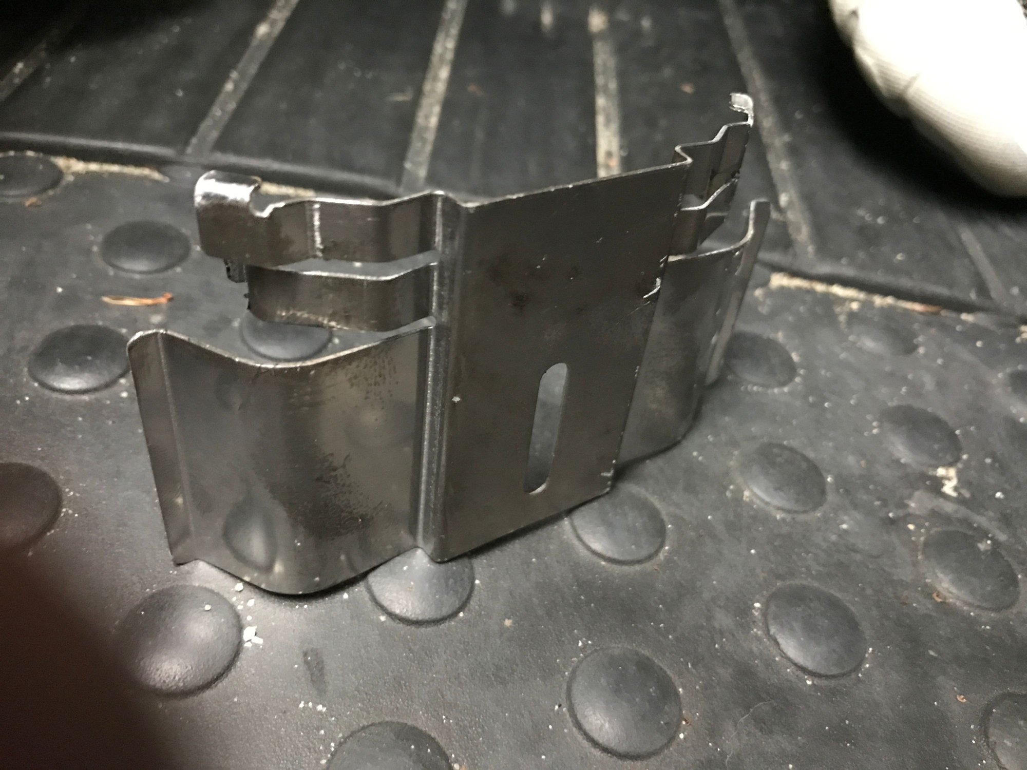

Hey gang-
driving about 15mph slowing down, heard a bup but clink from the passenger side front wheel, and looked back to see shiny metal in street. I backed up and retrieved it.
is it mine? 2005 r53 MT

I think you are ok, I have an 05 r53 totally apart in my garage, and that part doesn't come to mind, I will look and confirm when I get home, But I honestly don't think that came off your car.

That looks like a brake pad retainer from another type of car. Unless you have fancy Brembos or something.

I was thinking brakes as well. The Gen1 JCWs have "glides" (not the guide pins) on thre front but they do not look like the above.

I also assumed break pad retainer.
my clips are are all still on and it's braking as normal (really good) and my wear sensor indicator light is off.
thanks for the confidence

Never seen that part on any MINI
