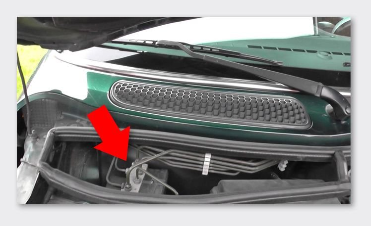

Originally Posted by djp2313
...I have a rather loud ticking noise at idle. It doesn't happen right at start-up but only comes on about 15-20 seconds after. Seem to come from the passenger side. Disappears with revs, not drowned out by engine noise but actually disappears.
It's possible that the clicking sound you're hearing is coming from the ABS pump, on the engine side of the firewall opposite the glove box. If so, it's completely normal.
