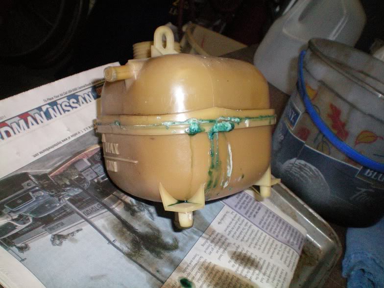

GEN1 S has a problem with expansion tanks cracking at the seam ... if this happens on the back side you may not see it. Look for residue of coolant cooking off on the heat shield below the expansion tank. They said they redesigned this once early on but I still find myself replacing for folks over and over. Not a crazy expensive part and a snap to replace ...
there are nice looking alloy replacements too ... but you can buy 5 plastic ones for what they cost ....
