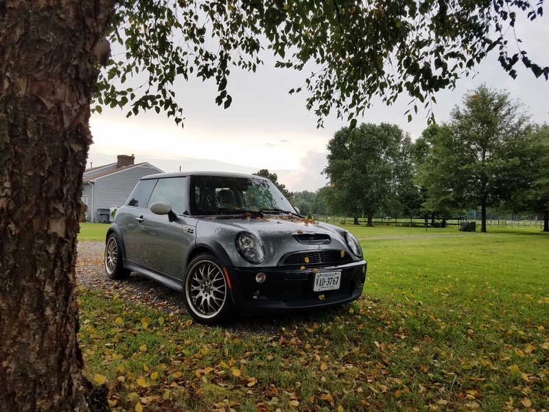

It's a gloss black grill, and I used gloss black ties so they aren't that noticeable until right up on it. I'll try to remember to get a pic

They run along the bottom edge
