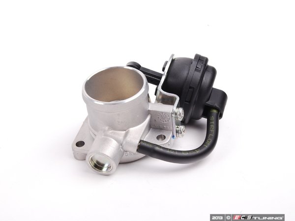

And check tension of the BPV.
# 11617568423.
They usually have a life expectancy of 120k miles so you are at that point if not replaced earlier.
