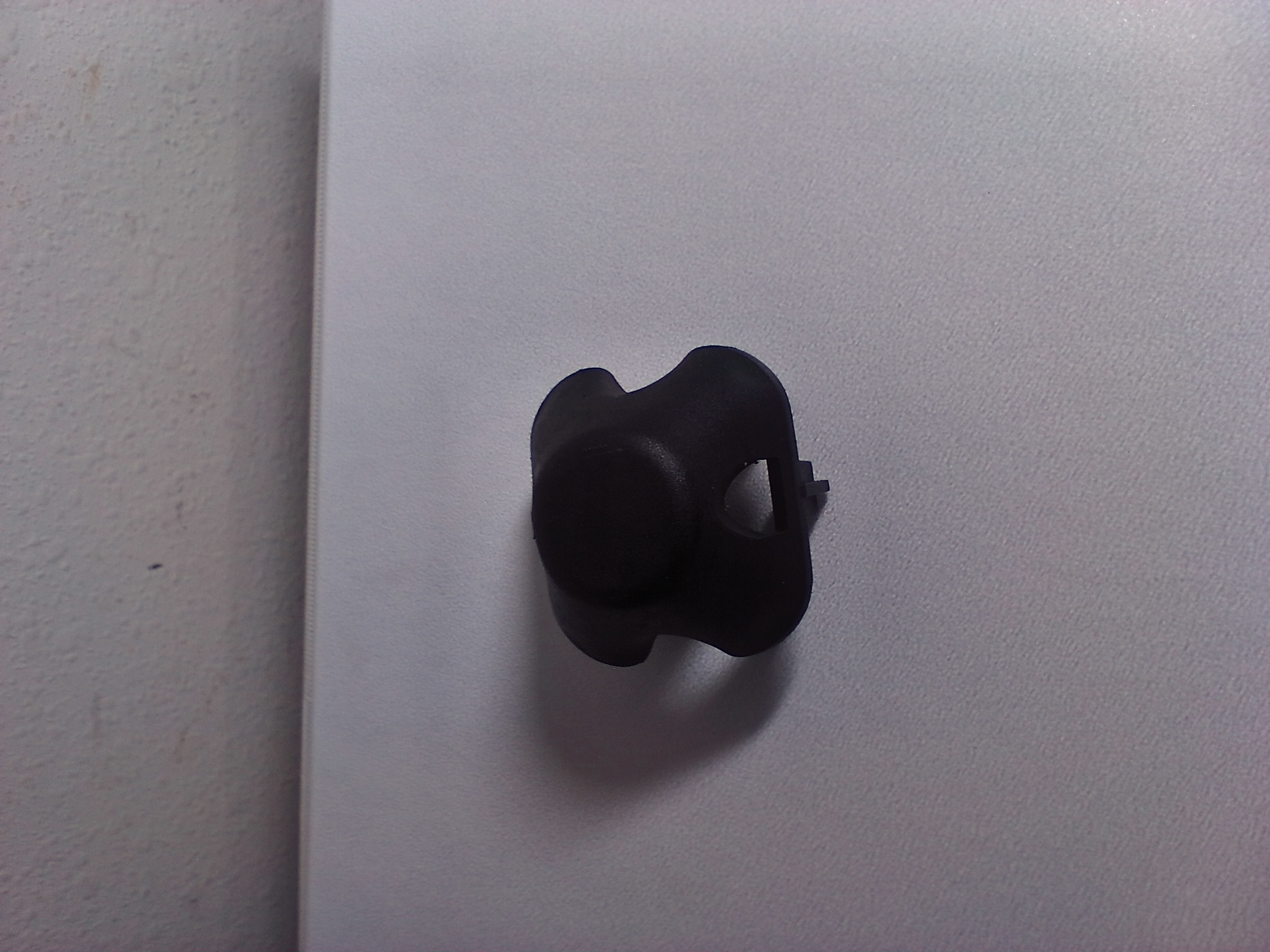

I found it on the floor under my car, any idea where it goes?
Attached Thumbnails Trying to ID this plastic part-img_20161206_110852.jpg   Trying to ID this plastic part-img_20161206_110958.jpg

Snaps into the end of the bumper support that the bumper bracket (#4) slides over (2 per car).
The red arrow points to where it slides into (where the #5 is), although the diagram does not show the piece.

Yep, AoxoMoxoA's right on the money. Don't see how that could fall out unless you had it in service mode.

Great!! Thanks guys, and yes, I am in service mode at present. I have the SC off for oil change and new 15% pulley. Thanks again!

+1 thats it and no part number, It's an assembly thing from the factory.
