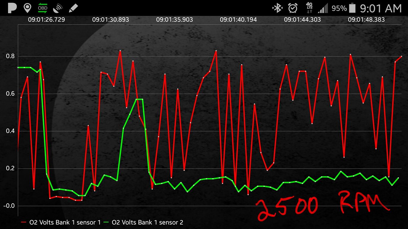

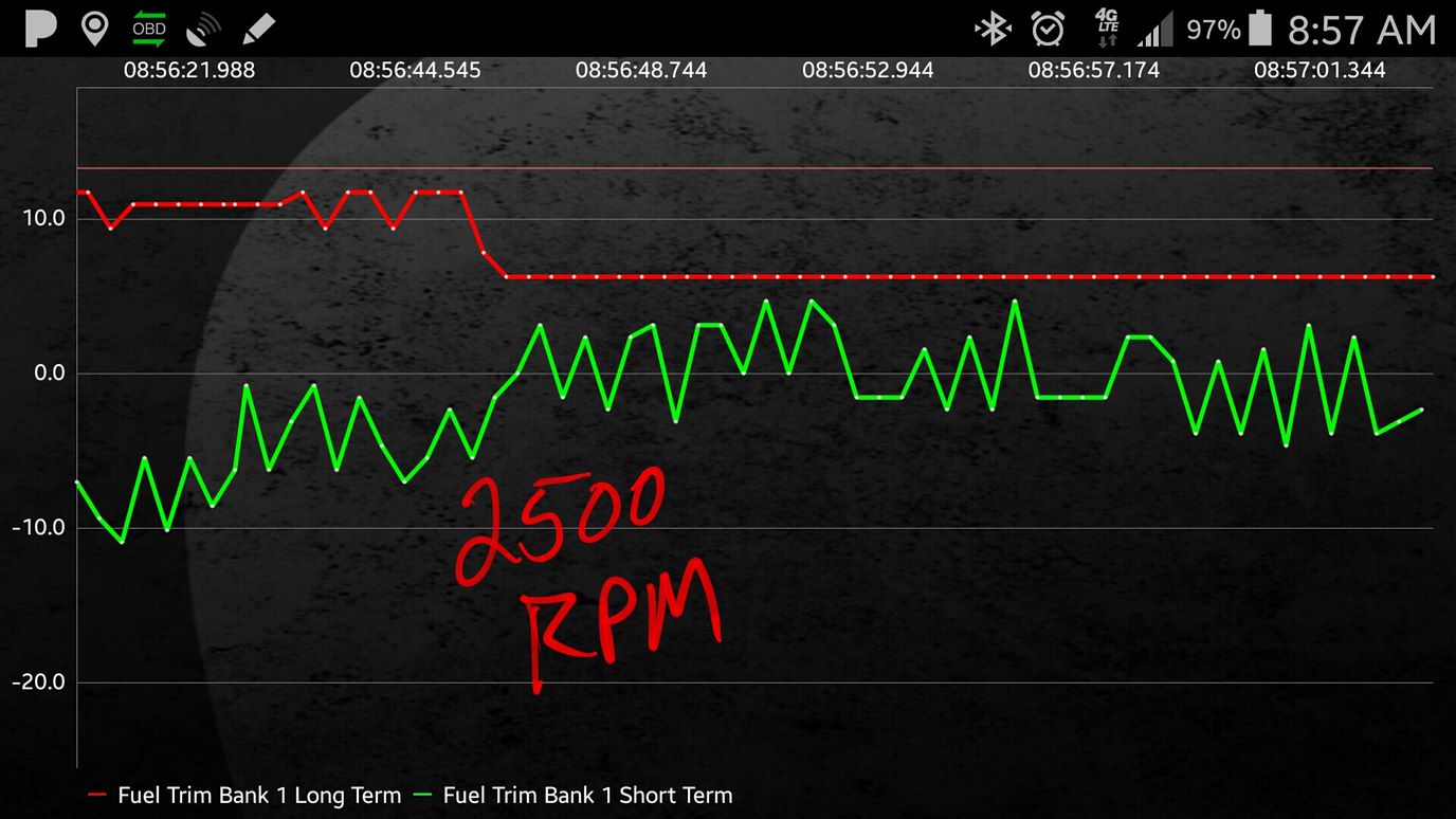

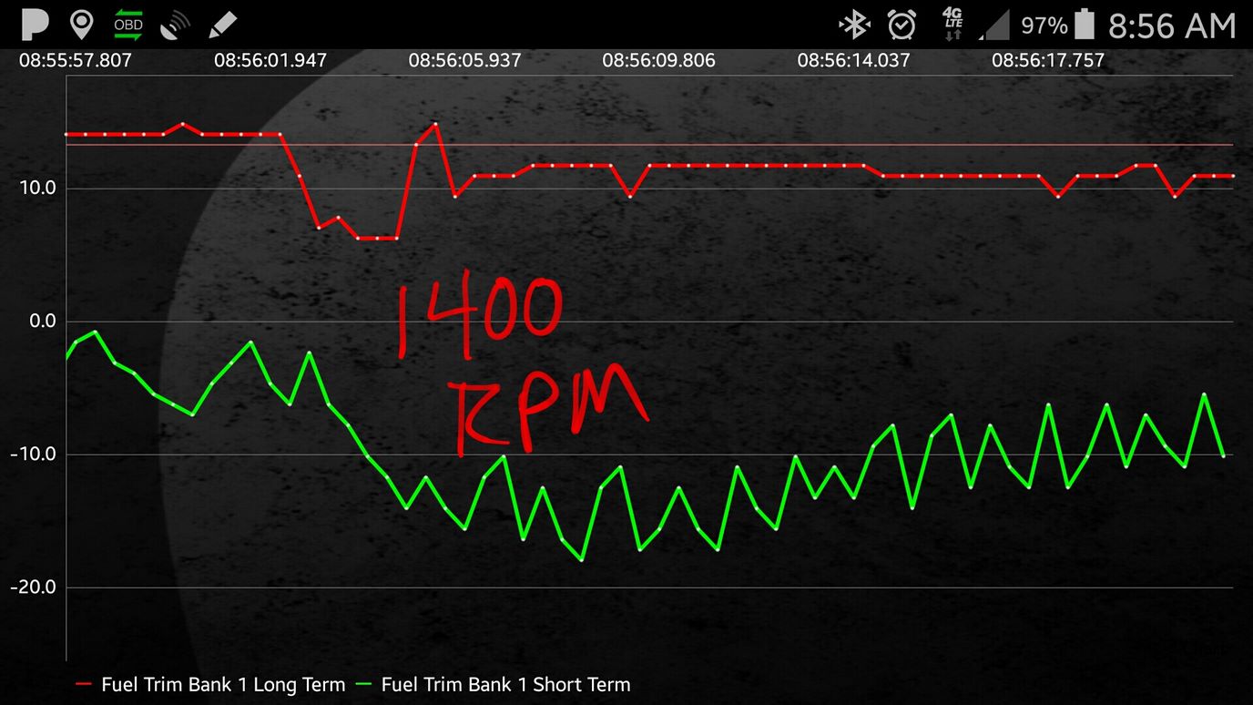

I also did some live parameter recording for O2 and Fuel Trim, attached. LTFT is higher than it should be. Weird how it comes down with the motor revved. First, I didn't expect the Long Term to react that fast, kinda makes me wonder if the stored LTFT is not a single value, but rather is mapped to RPM? I haven't read that anywhere. Also, it's weird how at idle the STFT is negative, constantly negating some of the LTFT. Doesn't seem to behave the way the gurus say it will. When I rev the motor and let off, the LTFT spikes briefly, sometimes into the low 20's (again, didn't think the Long Term was supposed to move that fast). I figure it hits 25% at times and sets the 0171 code. Don't know what's wrong.

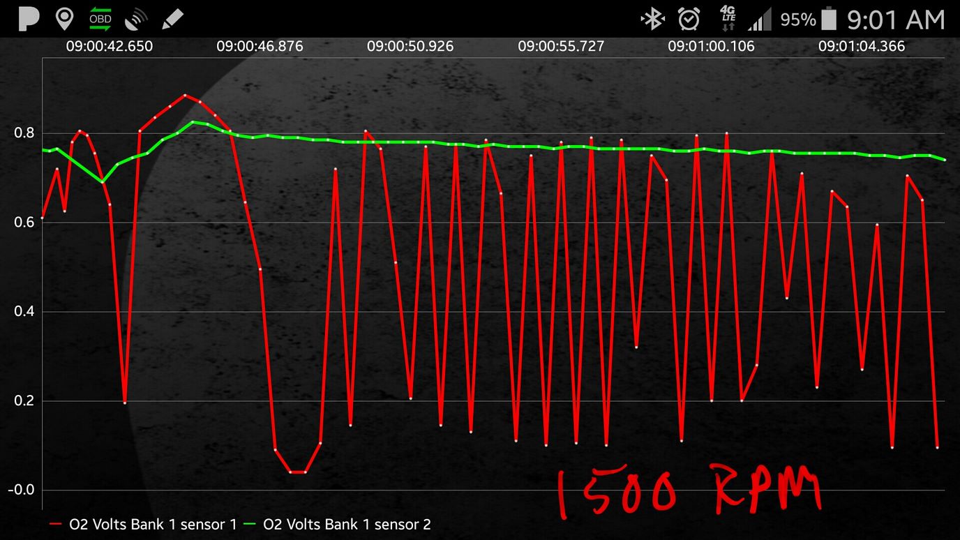

Upstream O2 sensor (1) seems to oscillate the way it should. Not sure I understand the behavior of the Downstream sensor (2) - maybe the cat gets too cool at idle to work well, and warms up at 2500? But my code is related to sensor #1.

So what's up? This second code, related to the same O2 sensor, may help in the diagnosis. It's seemingly normal oscillations make it hard to believe the sensor is bad (it is original AFAIK, so 121,000 miles...old, I know). I'm not averse to replacement, but I greatly dislike throwing parts at a problem without diagnosis. Some people report rubbing of the O2 sensor wires on metal clips which can then cause an intermittent short or open on an otherwise functional O2 sensor...that could be it, I'll look for that. I looked up both codes on the web so I know what the "usual suspects" are, but there are a number of them. The O2 sensor itself, and it's wiring, is one of the common denominators.

0171 can be small leaks in the intercooler boots. If you haven't changed them it might be worth a try. I had intermitted P0171's and new (OEM) boots at just over 110k eliminated the issue.
I read somewhere that P0130 can be caused by the heater in the O2 sensor failing. The sensor works but fails a preheat temperature check which might explain your data. I changed the pre-cat O2 sensor and the problem went away.
