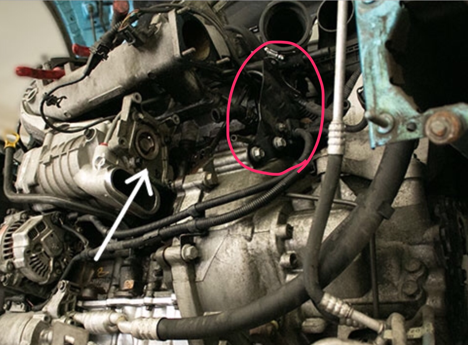

I do not have the bracket circled in pink on the third picture. I found that pic on google, so it might not apply to my year, or the previous owner removed it? 2003 r53. I have been looking to attach my wiring harness to something, but can't find anything. Is this what should be used for this? Right now it just lays on top of the transmission.

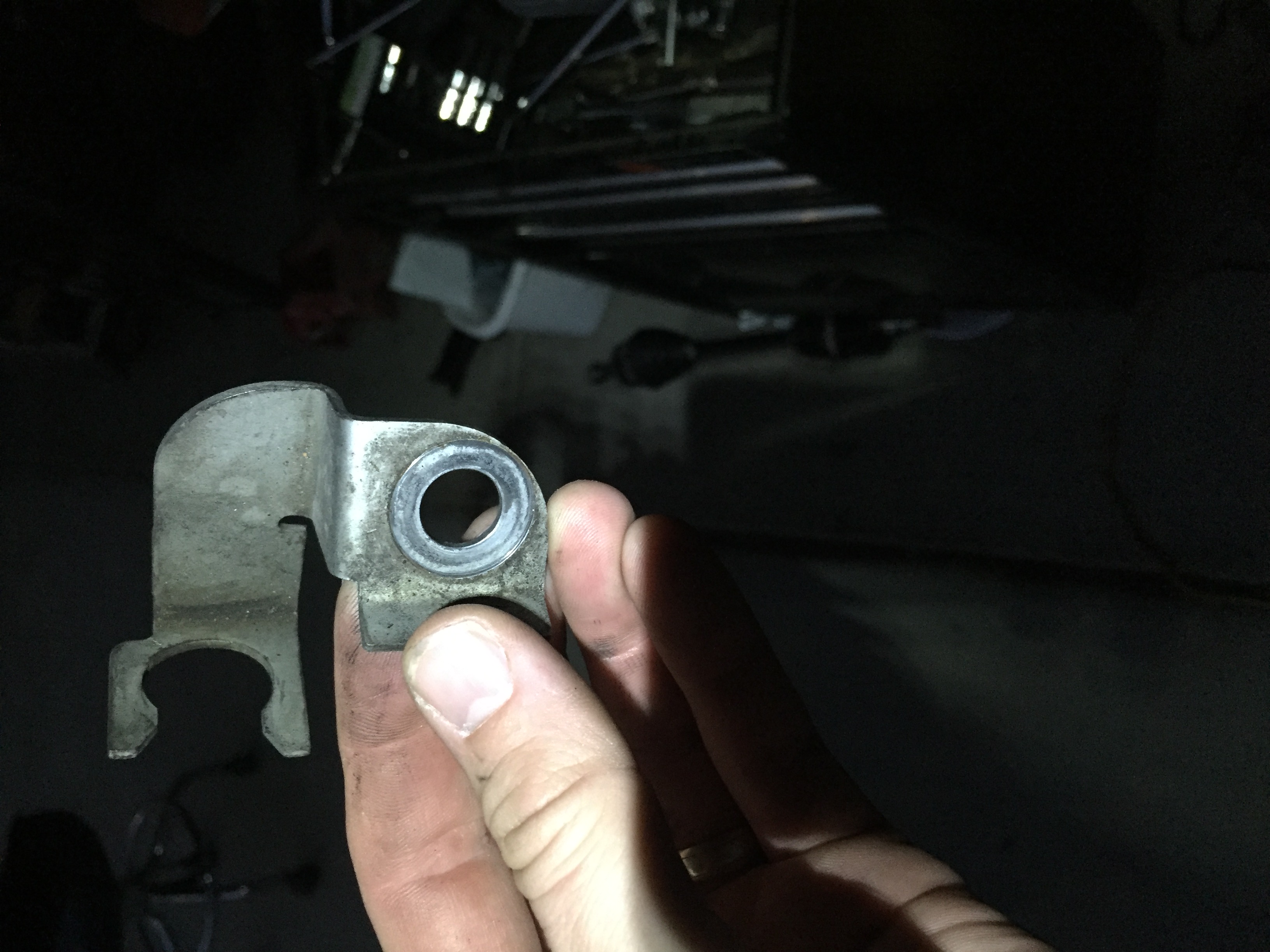

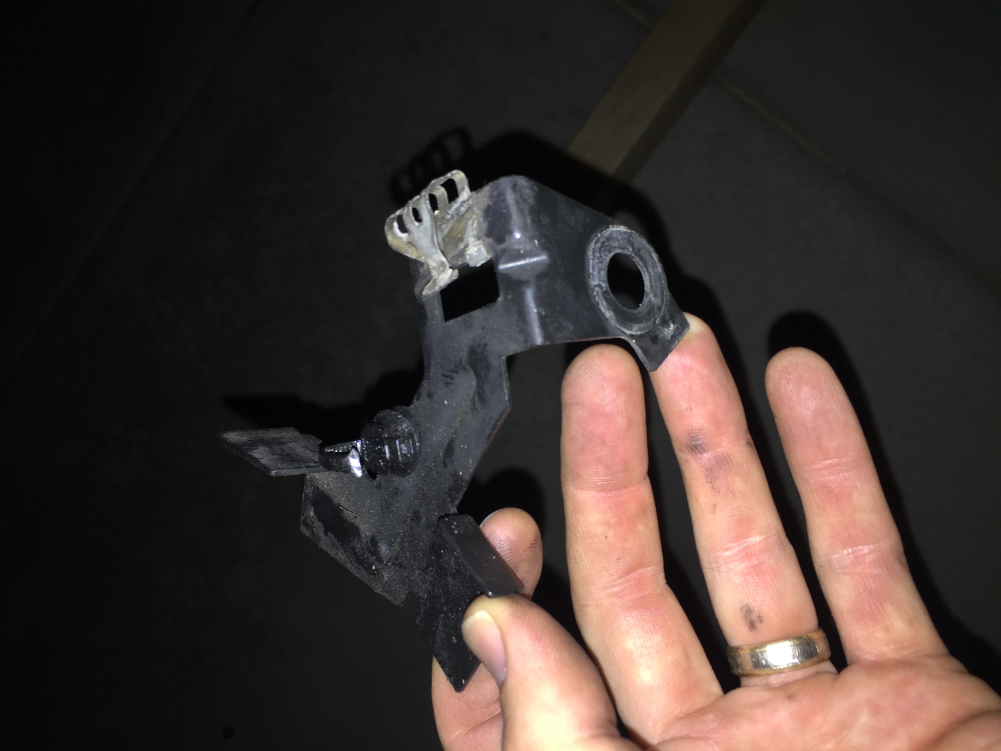

I have two brackets, that for the life of me I can't remember where they came off. The bolt holes are large so I assume they go on the bell housing somewhere. They are pictured below.

kinda looks like the shifter cable bracket due to its size, but hard to tell since I haven't dug that deep =D

I just put my engine back in the car after a rebuild as well. The first bracket is for the slave cylinder tubing. It bolts to the tranny mount. Second bracket is for the wiring harness. The top starter bolt goes through it. The last bracket holds the throttle body my 05 cooper S has it.

Thank you so much jeffl, that helps me a lot. I do not have the throttle body bracket, I guess the previous owner thought it was not needed? I'll have to get one ordered.
