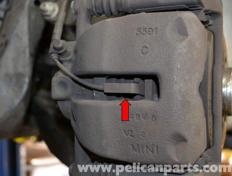

For the Control Arm Bushings I'd recommend the powerflex rear bushings here and the Madness front bushings here. Output shaft seals here. We have awesome brake kits here. Or just rear brake parts here. Be sure to check the rotors and replace if needed. There is also a brake pad sensor, which is in that link as well. It is on the rear right wheel (image below). If the pads are well worn there is a very good chance you are going to break it trying to remove it. Do yourself a favor and order a new one when ordering your brake parts. If you need help with any of these repairs, we have great DIY tech articles that may be of assistance to you. For P2270, here is a NAM thread with some good information. For the oil leak, I'd get under there and inspect the area in which you believe it's leaking from. You can then do the same clean up if it's pretty messy and watch to see where it may be originating from. Check your motor mount as well and make sure you aren't seeing fluid from a failed motor mount. For reference, check out this thread here. Let me know if you have any questions.
