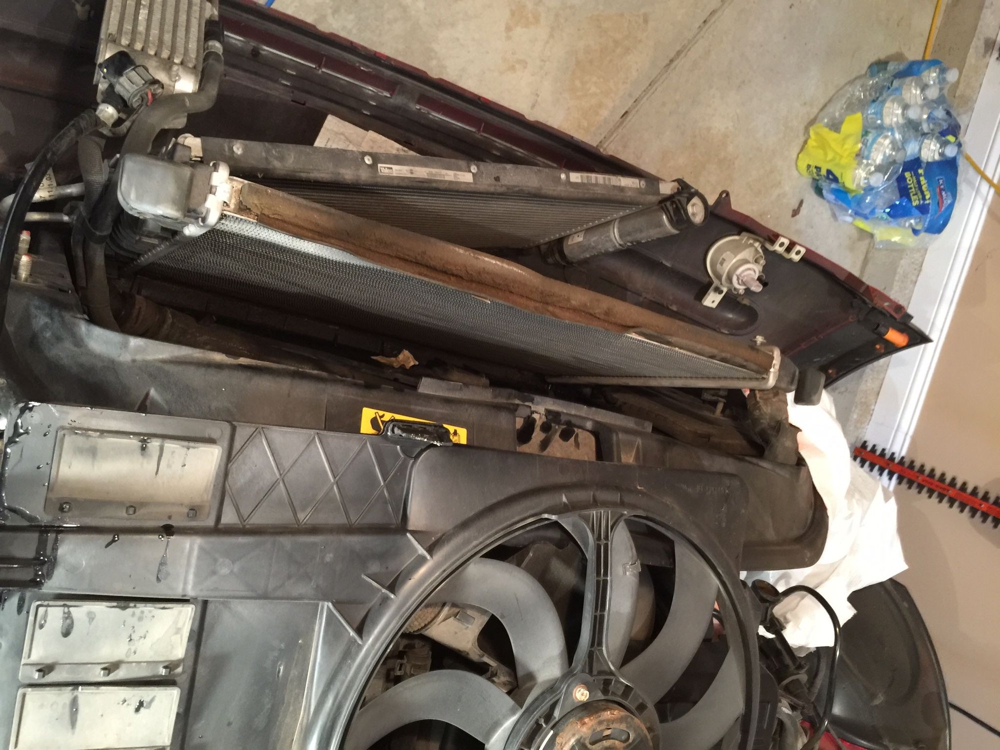

David.R53. I was able to get the fan switched out without removing the MFE. Couple notes for future: I removed the 4 plastic screws/anchors in the wheel well attaching the well to the MFE. Don't need to do that. Saves you from having to remove wheels as well. Also, I removed the top radiator hose too, all the way. Did not drain coolant. Removed bolt holding tran fluid cooler and moved that to side without disconnecting lines. Same for air condenser. Leaned radiator forward, slide old fan off, new fan on.

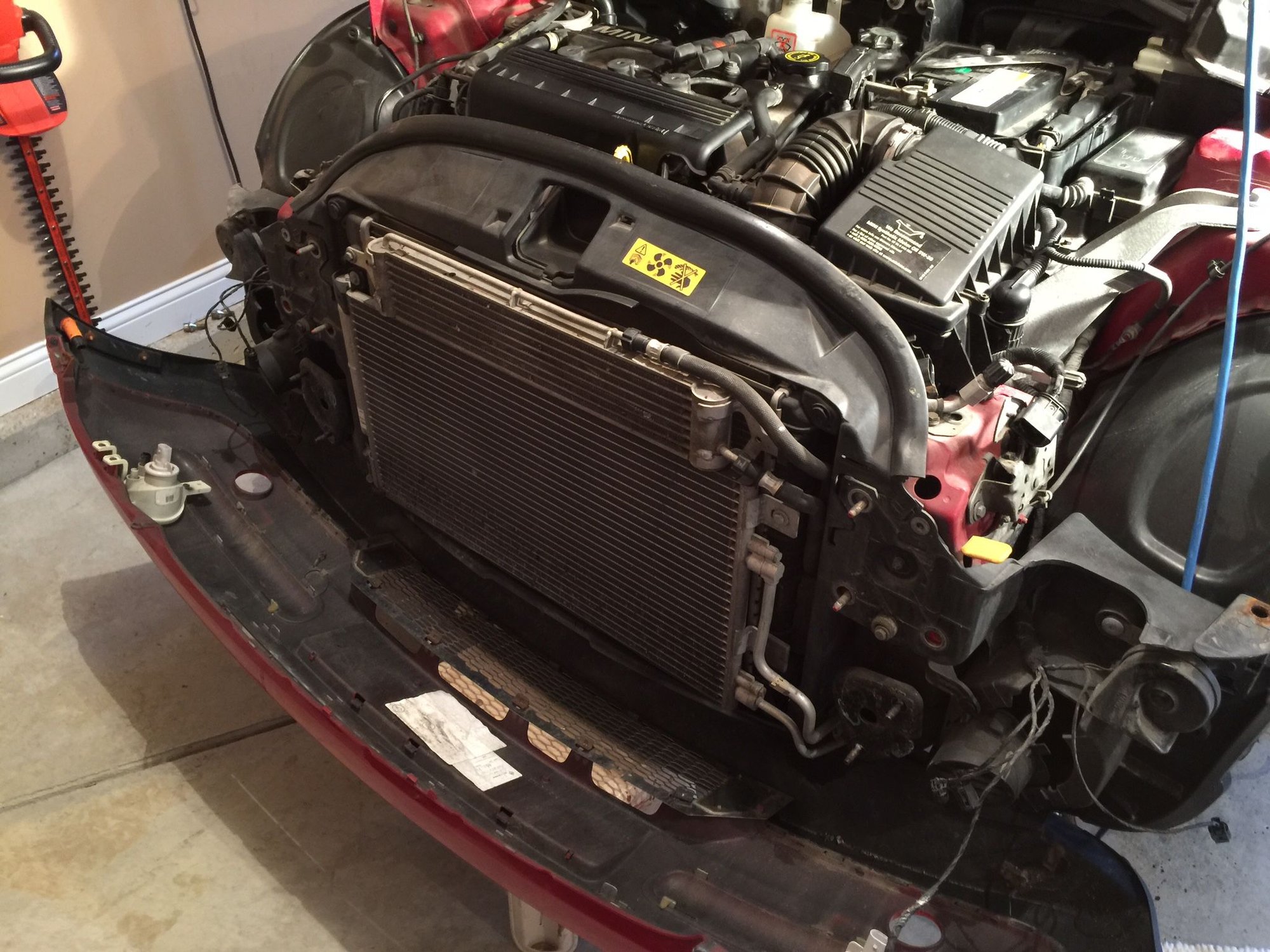

This was my first time removing bumper cover and support. Looked more difficult than it actually was. I'll post pix soon.

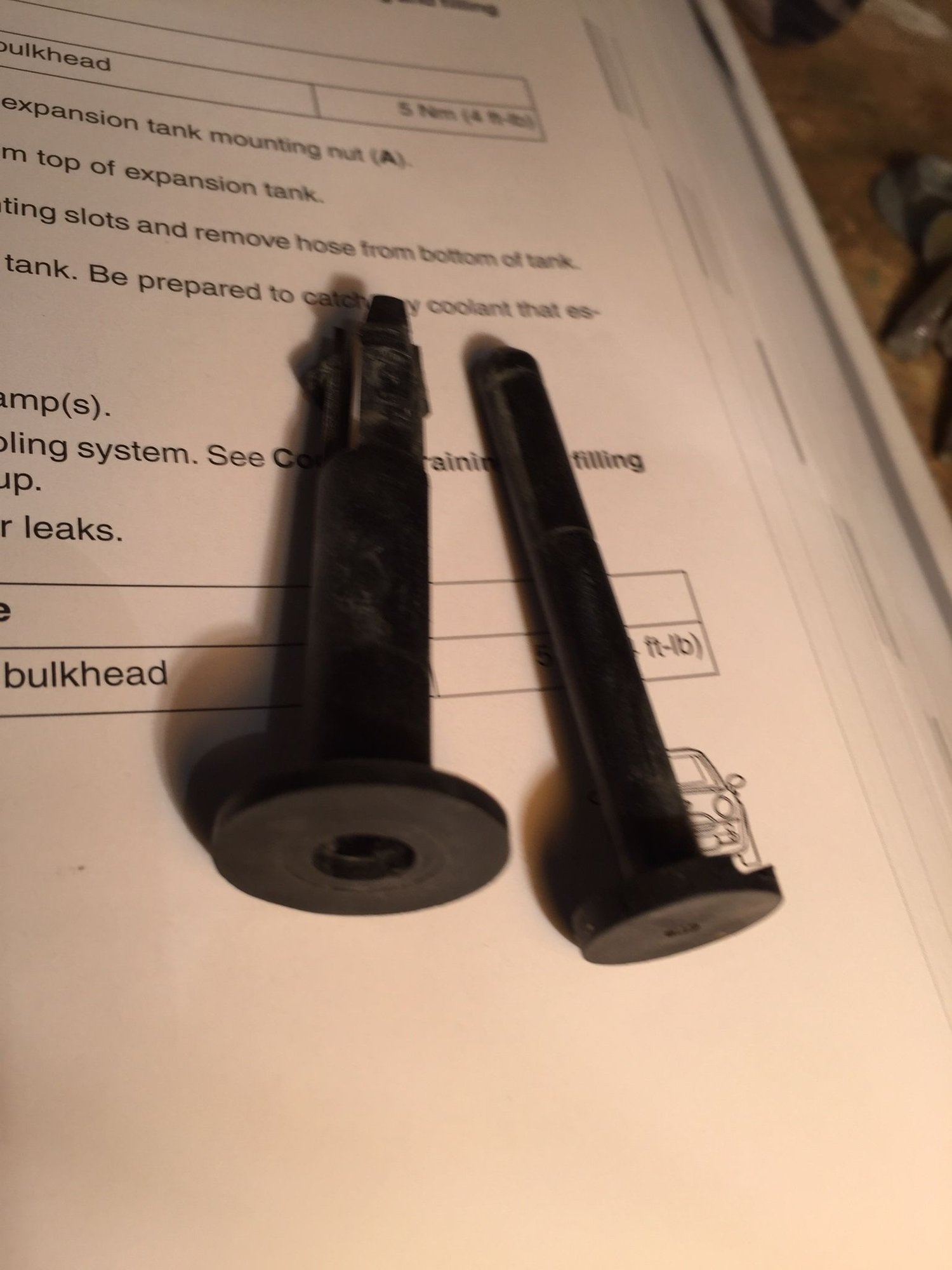

I leaned the bumper cover forward, rested it on a stool, and did not remove the 2 screws on bottom.
Bentley manual says remove just the pins holding radiator. But I found it easier to also remove the plastic anchors.
Here's my old fan removed, laying on top of engine.
New radiator installed
