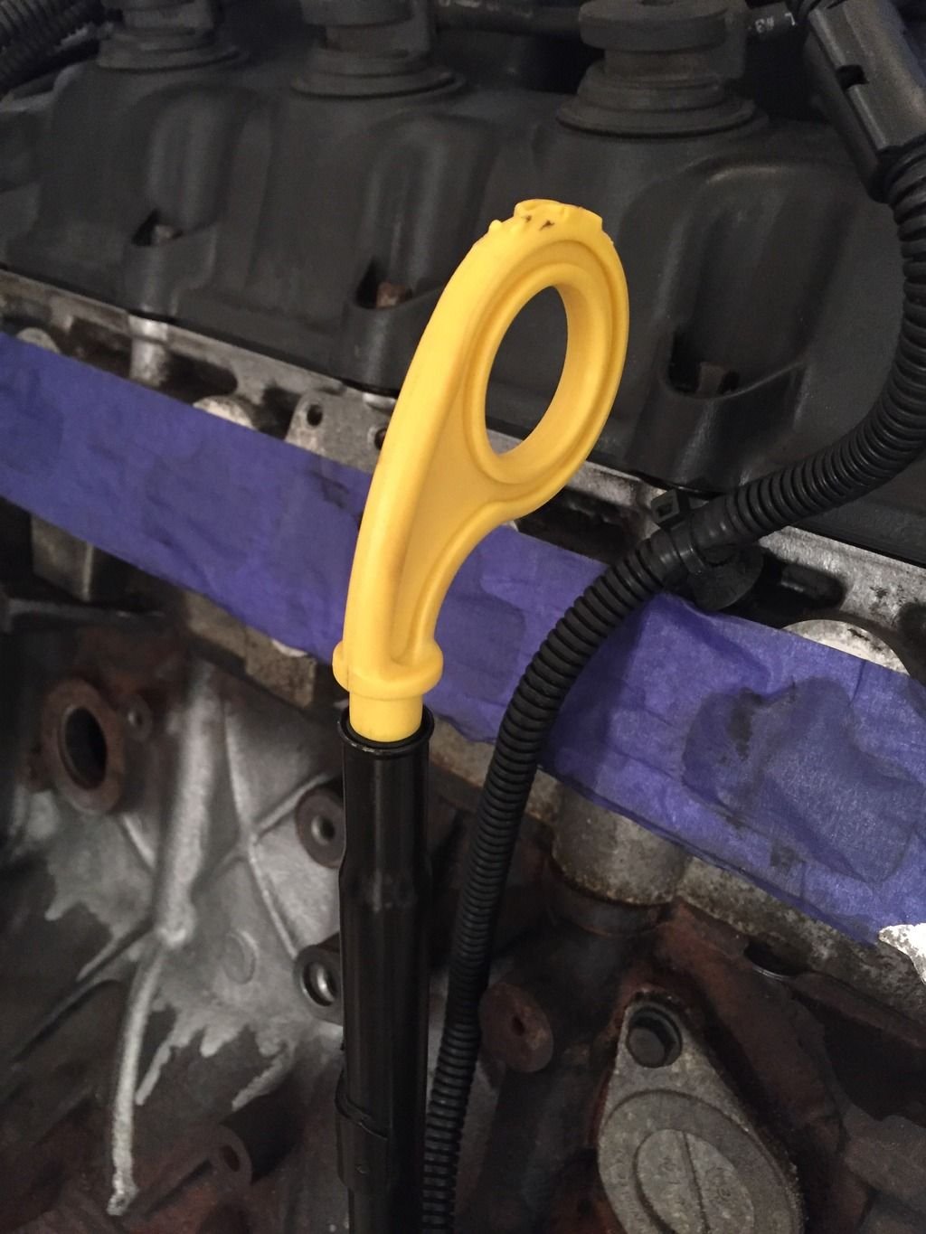

- GOT UP EARLY AND WORKED ON GETTING THE CLUTCH ALIGNED AND INSTALLED. IT WAS PRETTY STRAIGHT FORWARD..
- INSTALLED THE NEW DIP STICK.. WOOO THAT WAS HARD..

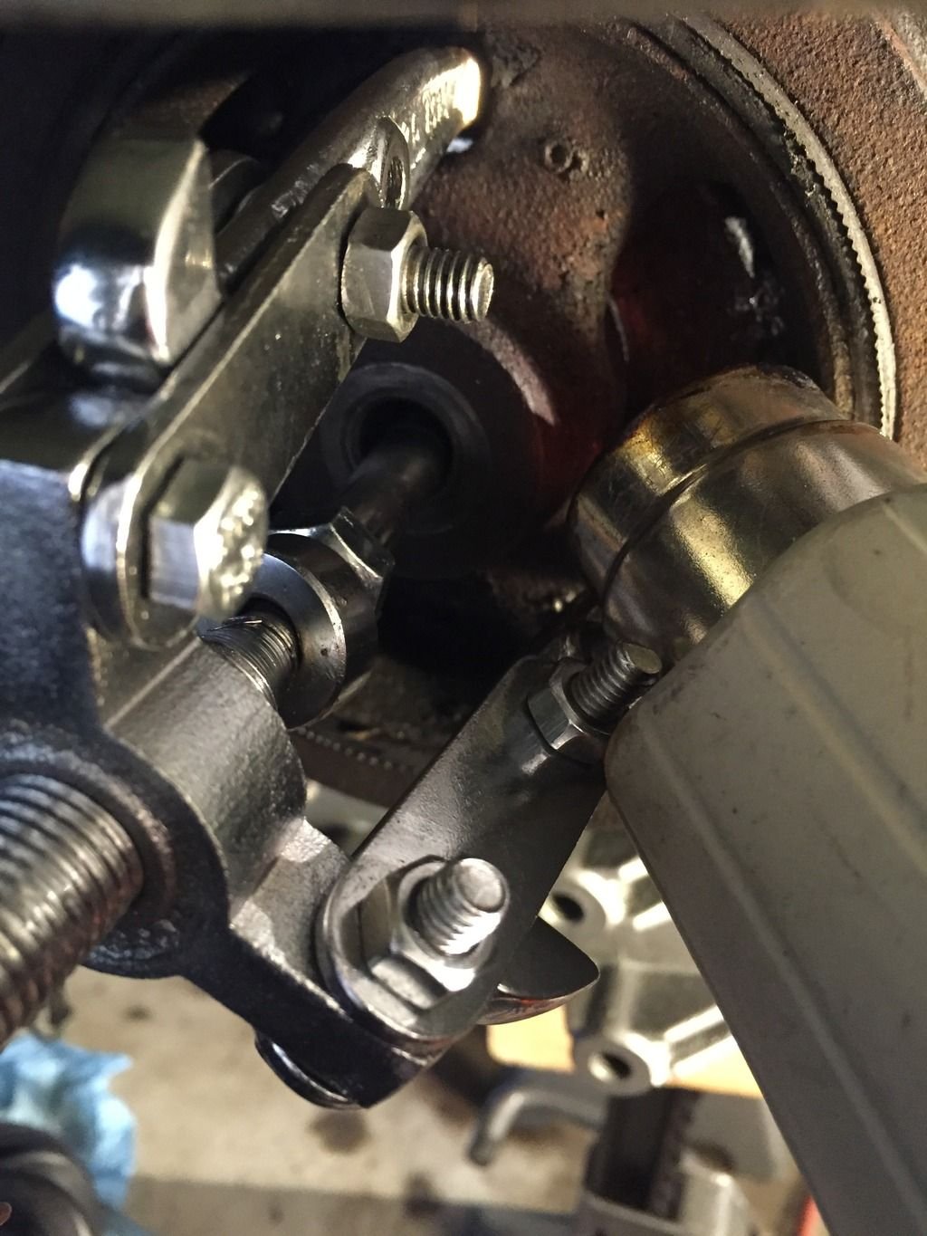

- FINALLY.. SINCE I WAS ON A ROLL I SAID " IM GOING TO GET THE OLD PULLEY OFF... I WAS CONFIDENT!!!!! CHEST HIGH.. BUT THE F#$%ING PULLEY WILL NOT COME OFF... I TRIED PB BLASTER.. WITH HEAT COMBINED WITH AN IMPACT WRENCH AND NOTHING.. IT BUDGED BUT THATS IT.. THATS WHERE I GOT PISSED AND DECIDED TO COME DRINK AND DO THIS UPDATE...

I feel you are having trouble with that pulleys as a 3 jaw is the wrong kind of puller for this type of pulley. You need a pulley puller / installer tool. You can get one at the auto parts store or harbor freight. I use a us general model 40749. This type of puller goes all the way around the flange. And you use 2 wrenches, or in my case the biggest wrench and a 2 foot ratchet. When you have to put the pulley back on it uses a piece that threads into the end of the shaft and a ball bearing and it presses the pulley back on. If you don't use this type of tool, you will destroy the puller or the shaft and it will never go back together.

Just realised the pulley puller does not work on your ripe of pulley. The one I suggested. I'm at a loss. My pulley had 3 threaded holes in it to bolt a puller to. Is there a possibility to drillers or use a threaded style puller and then go to a large plate of style and then a nut in 3 places. Something where you can really crank and get some tension on that sucker.

Yea that pulley doesnt have the 3 holes because its an earlier model R50... As for tools my last resort is a puller thats out of England that a company made. I saw some Youtube videos on it.. I personally think they used Locktite on the pulley...

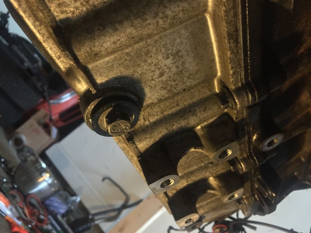

- ONCE I GOT THE ENGINE OFF OF THE JACK STANDS I WAS ABLE TO GET UNDER THE CAR AND GET THE STARTER BOLTED UP AND GET THE OIL FILTER HOUSING OFF AND CLEANED UP..
- TOOK THE OIL FILTER HOUSING OFF TO CLEAN THAT UP AND RATTLE CAN THAT UP AS WELL ... AFTER A GOOD SCRUBBING AND SOME PAINT IT LOOKED LIKE NEW
- GOT THE DRAIN PLUG SWAPPED OUT FOR AN OEM PLUG. THE PREVIOUS OWNER HAD AN AFTERMARKET DRAIN PLUG IN THERE.
- FINALLY I USED SOME BRAKE CLEANER ON THE BACK OF THE MOTOR WITH A WIRE BRUSH.. WIPED IT DOWN WITH A RAG AND LIKE THE REST... RATTLE CAN PAINTED AND CLEAR COATED THE MOTOR AND THE OIL PAN..

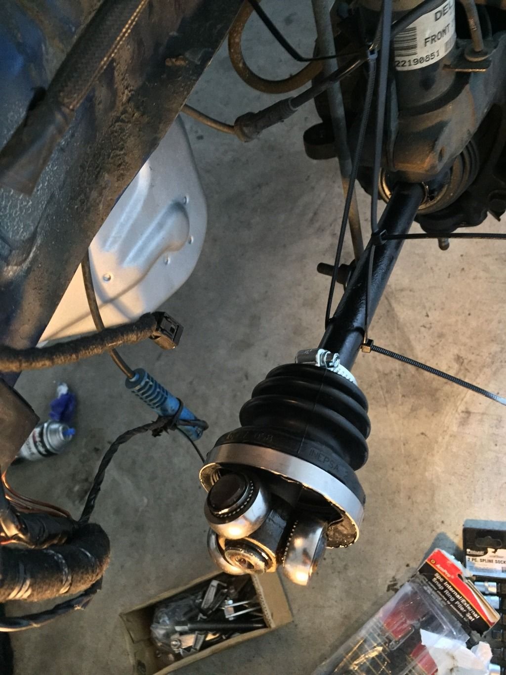

- SO OVER THE HOLIDAYS i DECIDED TO GO AHEAD AND CHANGE THE AXEL BOOTS AND RAN INTO SOME TROUBLE. THE DRIVERS SIDE CAME OFF WITH NO ISSUES. THOSE DAMN OEM CLAMPS WERE A PAIN IN THE A$$. THE DRIVERS SIDE I CAME APART ON ME WHEN TRYING TO REMOVE THE 3-SIDED PART.. SO I HAD TO ORDER A NEW PASSENGER SIDE AXEL.

I'm hoping to heat the crank pulley up so I can finally get it off today... After breaking two 3-Jaw Pullers

It finally happened!!!!!!!!!!! I got it off!!!!!
IT FINALLY HAPPENED!!! I WENT TO AUTOZONE AND RENTED A REAL 3 JAW PULLER... HEATED THE PULLEY UP IN THE MIDDLE AND USED MY IMPACT WRENCH AND IT CAME OFF LIKE BUTTER... YES!!!!! FINALLY!!!!!
AFTER 4 WEEKS ITS OFF... AND YEAH THIS PULLEY HAS SEEN BETTER DAYS..
NOW TIME FOR A GOOD CLEAN UP AND PAINT.. THEN REPLACE THAT SEAL AND ITS TIME TO MOVE FORWARD..

GOT THE END LINKS BOLTED UP AND REINSTALLED.. ONE WENT IN CROOKED BUT I WAS ABLE TO GET IT OUT AND GET IT ALIGNED STRAIGHT. NEXT WAS INSTALLING THE AXLE BACK INTO THE TRANSMISSION AND I GOT THE PLIERS TO CRIMP THE CLAMPS..
Finally got these bolted up...
Got the new Axle installed with the new boot..
