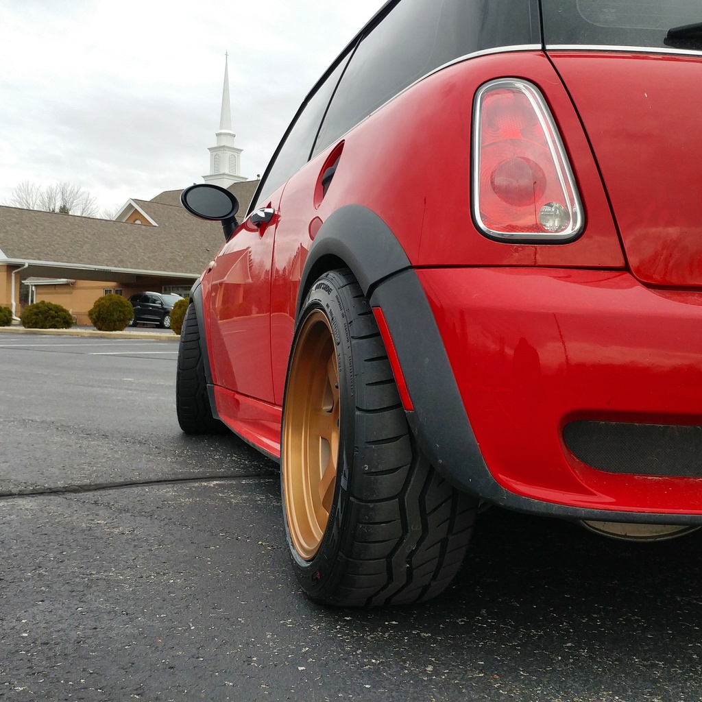

New wheels and tires!!!!
Need to lower the rear just a tad
Looks awesome!!!! That's exactly what I'm looking to put on mine. Gotta work on the suspension some ...maybe next year.

Wheels and tire size look spot on. Mind sharing the dimensions with me. My Coop needs some love. I live in Noblesville so we might end up meeting at Grissom sometime in the spring.
Old Apr 9, 2016 | 09:58 AM
  #68
ebowling's Avatar
ebowling
Joined: Jul 2015
Posts: 51
From: Kokomo, Indiana
Wheels are rota grid v 16x8 et20
Tires are falken azenis 215/45r16

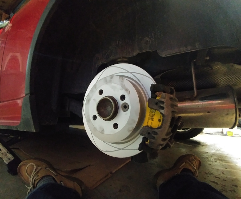

After swapping in EBC yellowstuff up front I decided to get new rotors for the rear before swapping the yellowstuff pads in (they were extremely worn). Decided on ATE slotted rotors. Installed today, and huge difference in bite and braking power
Also adjusted my 19mm rear swaybar to its tightest setting and wow! Such a minor position change but a huge difference in the feel of the car! Love it
Did you ever replaces the slider rubbers , i did mine, they were shot.
https://www.ecstuning.com/Search/SiteSearch/34116770332INKT/
I did not. But they appeared to be in good shape when I pulled everything apart

Mine were sticking and when you pull the boot out , corrosion gets under it and bubbles the boot inward and the pins stick.
