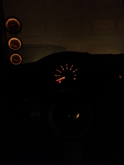

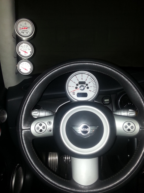

I re-routed the wiring around my relay to bypass it, and now the lights fade in and out with the interior lights. Pretty neat!
