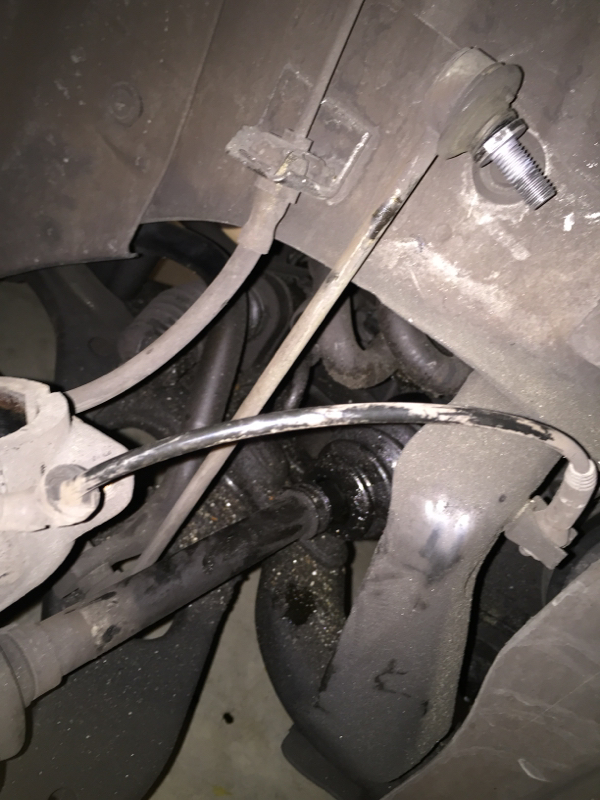

I saw this on mine when I first dropped my car. Don't know what you're looks like but my rubber boot WASNT where it should be but the grease around it was crusty and had been there for a long time and it still handles fine in the canyons for me as long as it wants to center itself out when you release the steering wheel from a turn of it doesn't come back it's time to get a new one guy in my city said he could do it for bout $300 including labor hope this helps
