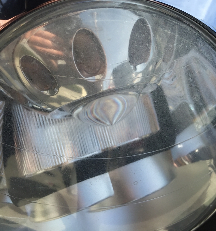

The headlight lenses on my R53 are just starting to look a bit cloudy on the upper third:

Get rid of the haze with just about any headlight repair kit. Sandpaper and soapy water.
After your done, just make sure you clear over the plastic with a plastic compatible automotive clear coat. If you don't clear them, they will get hazy again real fast.
