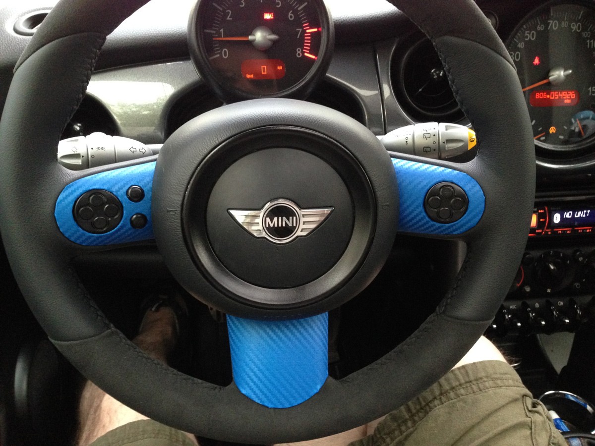

no covers for anything; no R56 stuff wont fit.
youll have to vinyl wrap or paint the steering wheel bits, and probably paint the door bits.
no that center ring does not come out. its part of the airbag, and its a pita to vinyl wrap. be prepared to spend about an hour to make it look right if you wrap that center ring. i got it nearly perfect once, then knicked it :( spent another hour + again and it look "ok", but im not entirely happy with it. its a funny *** shape, concave then convex, takes a lot of rework and a steady hand with a razor.
your best bet is to remove the airbag and paint it. this will be my next endeavor.

I painted the controls and the ring, then wrapped them too
