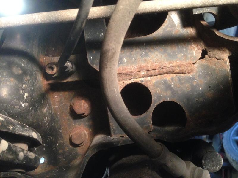

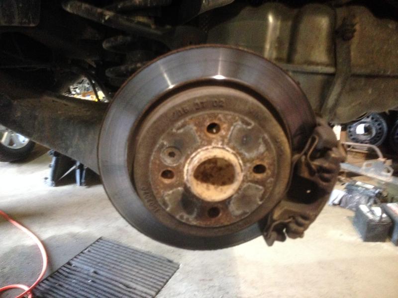

pull the wheel off and expose the rotor hub and all the goodies.
on the back side this is where you need to find the 6 bolts needed to change the hub. 2 for the caliper bracket and 4 for the hub.

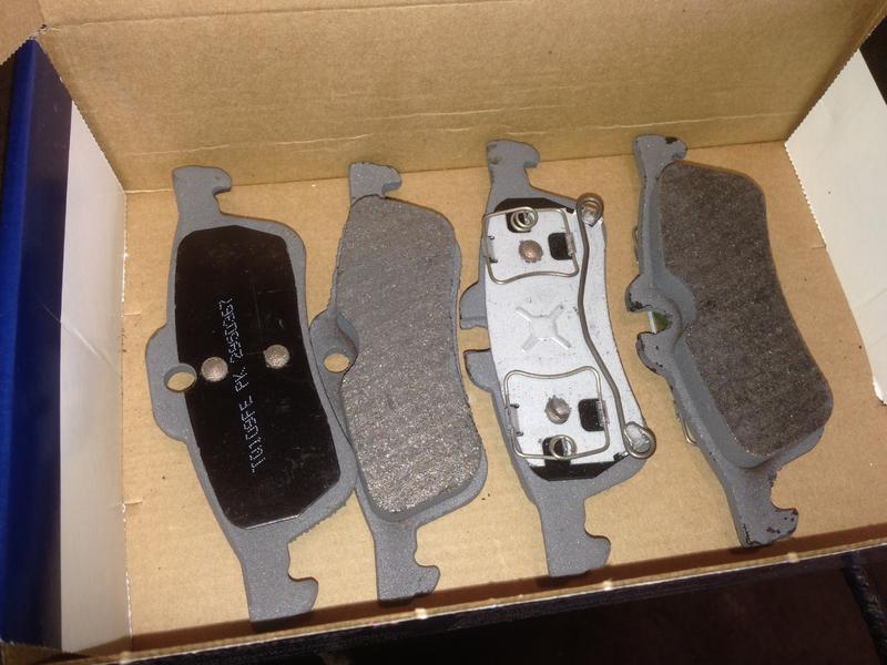

one T45 to pull off the rotor.
But in my case changing the rotors and pads
i had to turn my rotors and get some new pads. was in a hurry to jumped on the local store got Wagner not the best but defiantly not the worse.
