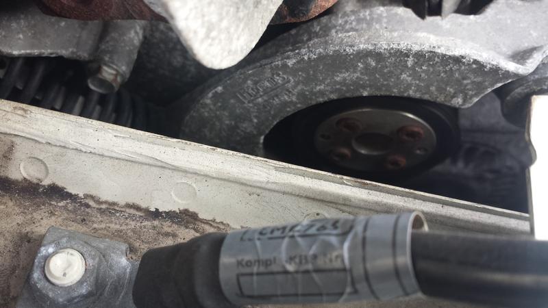

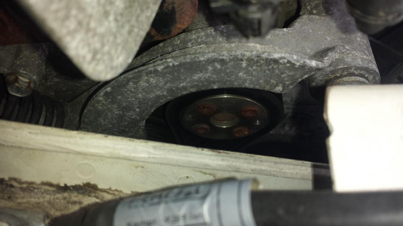

They USUALLY had a reduction % stamped/engraved in them.....
So most common is a 15%....m7 was basicly the sole 16% maker till way made a batch...and 17%... More common as of the last 4 years or so..especially in the northeast.
Try to get the best picture you can...post it...
Measuring it is not really viable...the sides varry as belt guides from design to design.....
There were also lots of "knock-offs"...a local bmw shop was installing eastern European ones with a odd name when I was looking for one back in 2007 ish....not to mention e-bay...

well my plan was to measure the belt width and measure over the pulley and the belt, subtract the size of the belt, and bam pitch diam of the pulley

i didnt see any stamping, ill try to upload some pics
looks like i need to do a bit of cleaning haha, bit of corrosion go New England!
